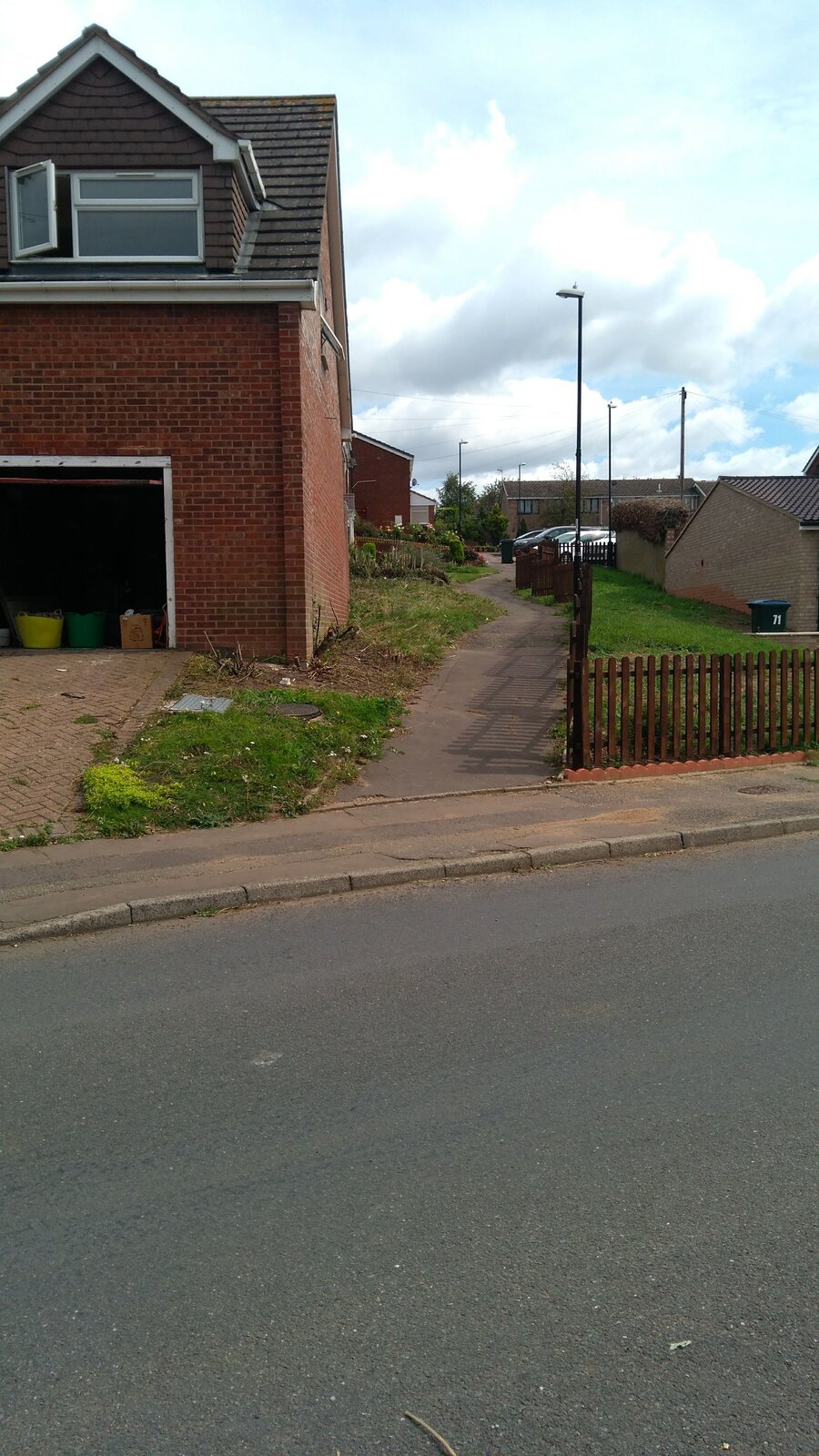

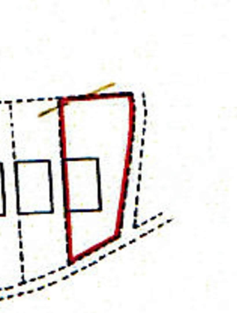

We have some land to the right hand side of our property, which is our boundary, total length is approx 24 metres.
We would like to install 6 ft close board fence panels from a safety and security perspective and will give us more garden space
However adjacent to the land is a footpath
I found this online with regards to the regulations
"No planning permission is required for a wall or fence that is under 2m in height. However, if that wall or fence is adjacent to a highway (including a footpath) then the height of a wall or fence cannot exceed 1m without planning permission"
However i am not sure what 'highway' exactly refers to, is it the pavement, road or footpath? Or all?
Can i install a 2m fence without planning permission?

"Highway" is not defined, and it can include paths and roads. There was a case just last week in Cornwall were a land owner had put up a 2m fence adjacent to a coastal path and ordered to reduce it because it blocked views.
You'll need to apply, and the fence will likely need to stop where it meets the front of the house.
The intention was to build the fence with concrete posts, gravel boards and then the fence.
The fence will stop at the front of the house where we will have a gate to allow for access to this area.
So the reason why i need to submit a planning application is it because there is a footpath?
Will this need to be a full planning application with drawings etc? In terms of rough costs how much will it likely cost to approval to get this past planning?
You'll need a location plan showing where the new fence will be, photo of the front and side of the house, photo or drawing of a typical section of fencing with dimensions and materials noted.
Costs would be on your council's website, along with any other specific information they require for the application to be valid.
Mentioning issues with security and ASB as reasons may be helpful
When you do put it up, make sure that the other side has not got any footholds/arris rails on etc.
You could also investigate putting a small fence up then a little way back your taller fence, istr that it would no longer be adjacent to a highway then but don't quote me on it.

Where did you find it?
What is it a firm, an official authority site?
It's a crap woolly answer. You can put up a fence next to a highway workout permission, just not higher than 1m.
But technically in this case there is no highway, just a footpath.
If there was a footpath and adjacent to the footpath a highway then that's understandable as to why a planning application needs to be submitted
Given that there is just a footpath will planning application still be required?
Although "highway" is not defined in the Order, common law usage is that a highway is a way over which the public are entitled to pass and re-pass, including a footpath.
You will therefore require Planning to erect a wall or fence over 1m in that location.
I would expect you could install a similar fence to what others have installed in your photo. Higher or much different to that, you will need PP. I would also expect PP to be almost certainly refused for a 2m fence, because it would be 'out of keeping' with the area.
