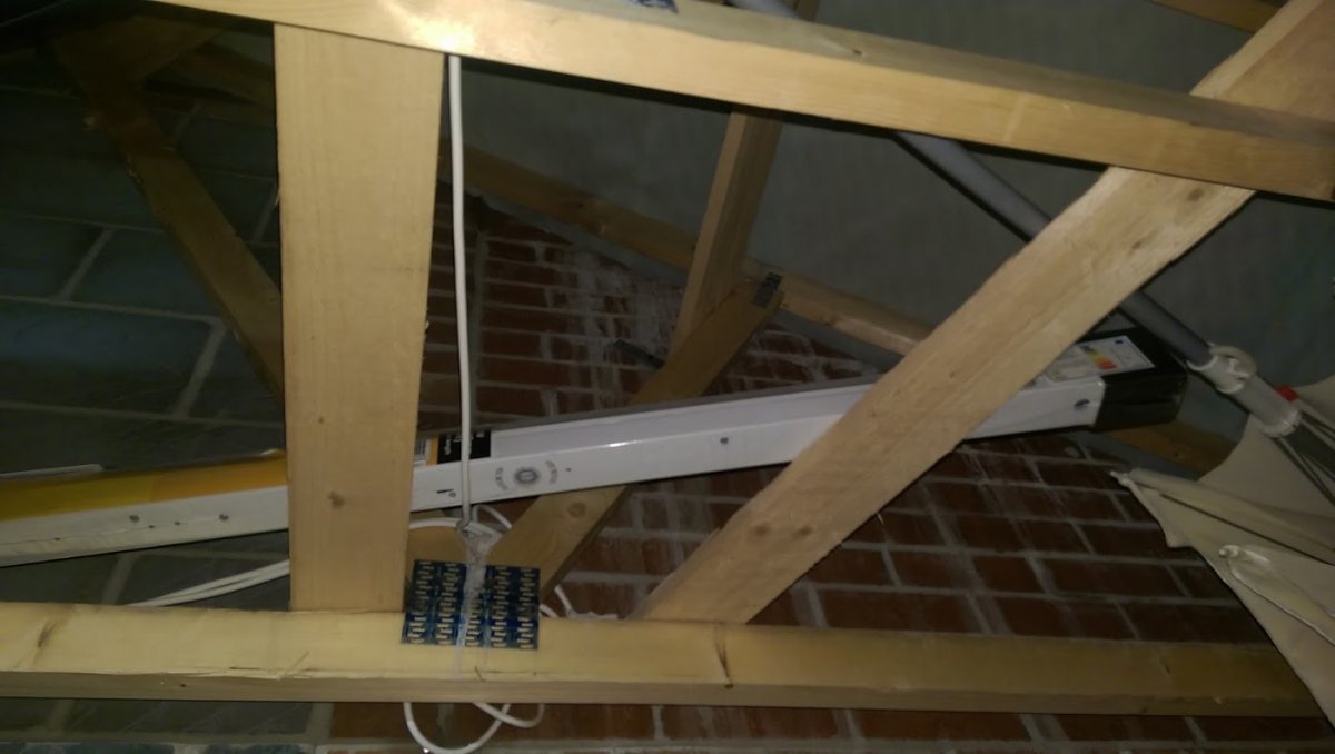

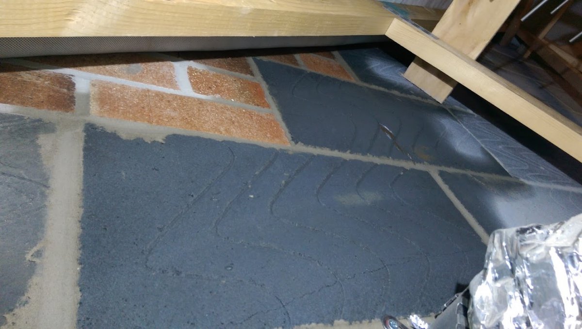

During heavy rain water started pouring in to one particular spot along the wall (that joins the house) and along the same wall further along you can see the brick and breeze blocks soaked and had water running down them.

The first two are inside and show the leaking. In the first photo, difficult to see but if you follow to the top middle of the photo there is a very small nick/mark in the felt that is where the water was pouring in. The second photo shows the soaked breeze blocks (this doesn't show the water running over them!)

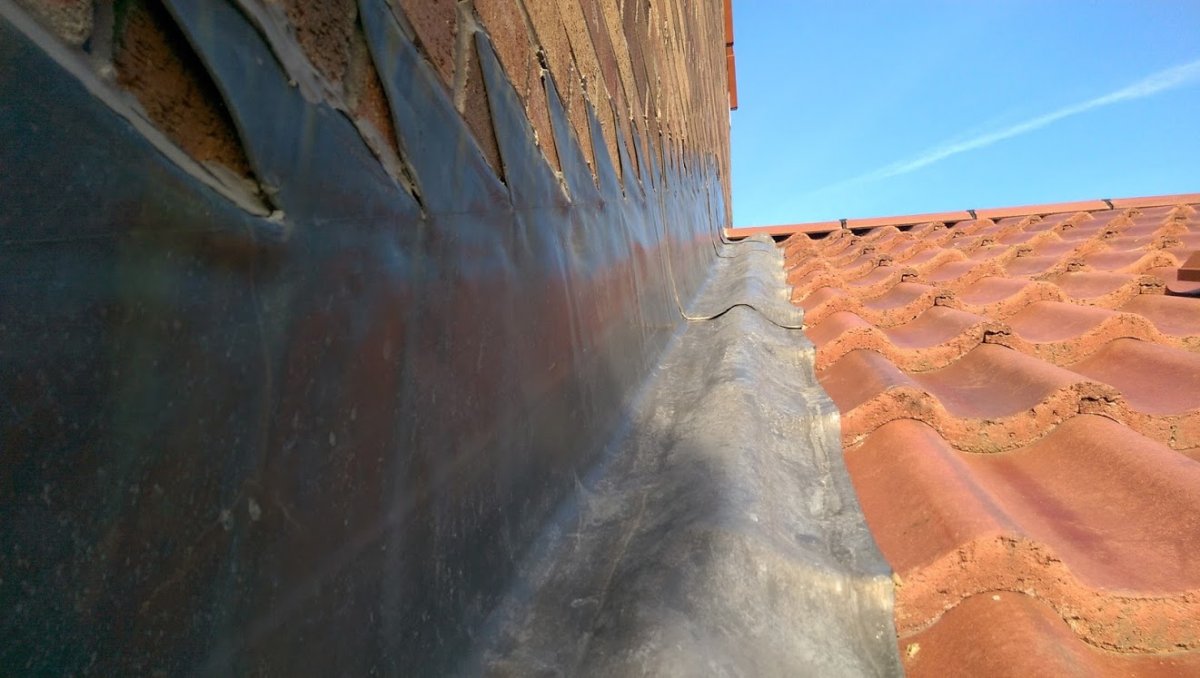

Outside photo looking up the roof showing the lead flashing (this is above where the soaked breeze blocks):

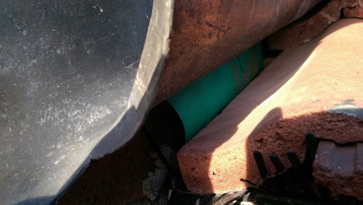

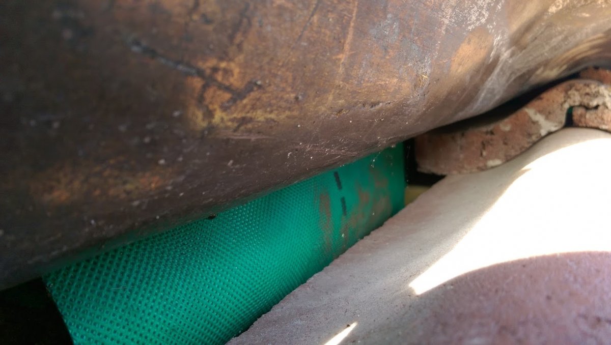

And these two photos are again above where the soaked breeze blocks were, and I lifted the lead cladding to look underneath to see what it was in there!

You are having trouble finding out about these because i assume they mean cavity trays. Cavity trays are there to catch the water that penetrates the cavity. This water should run down the inside face of the outer leaf and be caught by trays which protrude into the cavity and direct it back outside by way of weep holes. However, If water was actually running in I doubt that is the issue.
The cover flashing extending over the profiled tiles looks to be the only one there and as such is your only line of defense against driving rain. I suspect water is being driven under it by high winds and then its just running down the wall.
A better job would have a cover flashing and then soaker flashings to shed the water between tiles. Thats the way it would always be done here in Ireland but maybe is not the norm with profiled tiles where you are?
You can be certain its a roofing issue if its actually flowing in, not just soaking the wall.

I think there are no soakers, which there should be!! Cavity trays, how would you install then to protect a pitched roof? You would need a whole series of them stepped down the wall with a series of bleed holes. Its an interesting construction where a brick outer skin becomes a block internal skin, if there is water dripping down the inside of the outer skin, where does it end up? Fills the bottom of the cavity until it trickles over the garage floor?

Normally open ended stepped trays would be built in at construction like this to create a series of little water falls/ overspills down to the next one in series then an end stop and weep hole at the bottom one. Obviously you need to be well organised but over here in ireland they are a must as they are most often used on gable ends where a pitched roof garage is attached. That often leaves a large expanse of gable end exposed
It's normal over here to use trays as well in a situation where the external wall becomes an internal one below roof level.
Interesting that you use soakers on single lap tiles, whereas here they they don't because of the batten spacing being too long, so the felt turned up the wall and the lead dressed over the profile is used.
