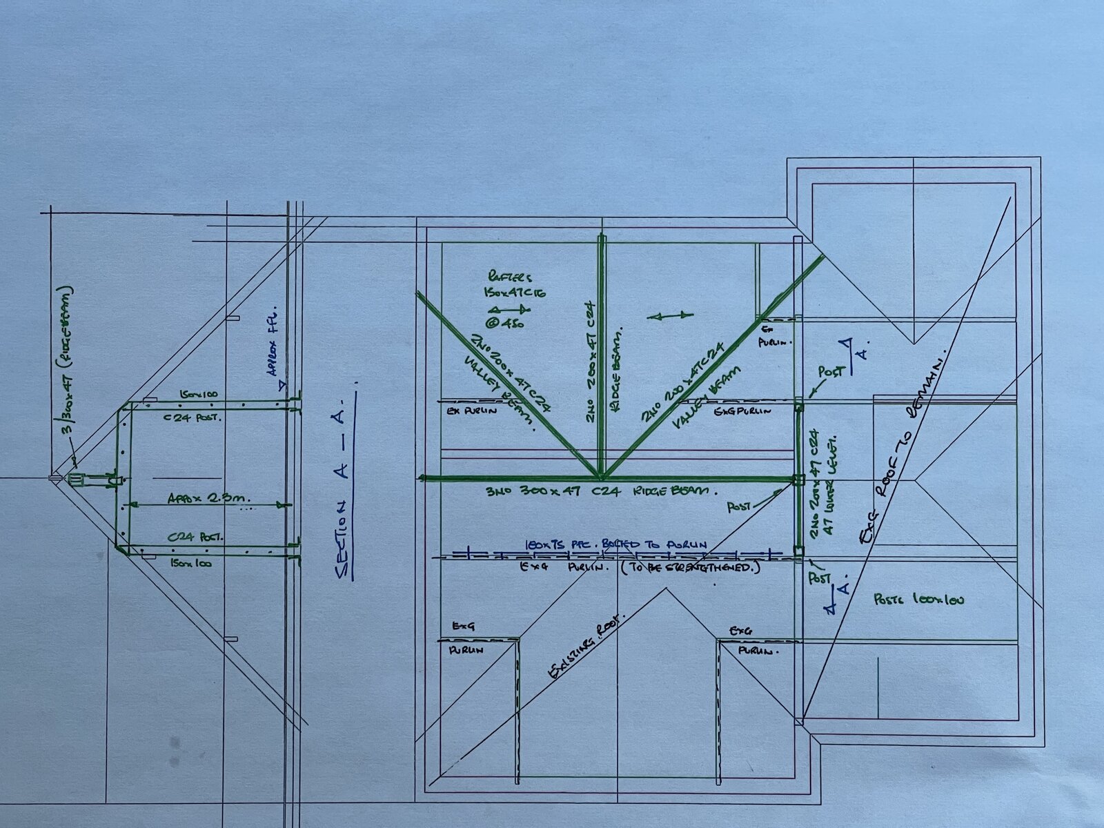

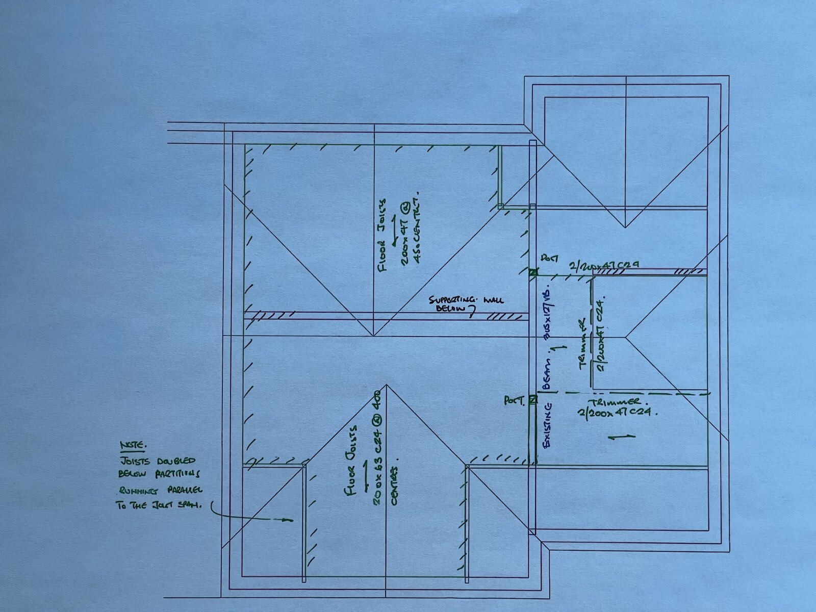

Embarking on a self build loft conversion. Had to get the structural calcs done for the floor and roof which seem pretty detailed. Enough for me to know what to put where to stop me destroying the house and hopefully to satisfy a full plans approval.
I was about to start some drawings for building regs by looking at examples off the internet, but on looking at what the SE has already drawn up, could I not just have a separate sheet with a list of specs on insulation and details? Would save me having to open a new pack of crayons.
let me know what you think. This is going to be a bit of work it out as I go - I know sound advice would be to get proper drawings produced, but that’s not how I roll. Fly by the seat of my pants and make it up as I go along whilst getting info along the way.
I think they would ask for a couple of vertical cross-sections showing insulation etc, plus the stairs, to show compliance.

TBH, I can't see what you are actually doing, what's there and what's new
Fire precautions? Means of escape? Lower floor plans? Rafter layout? Floor layout? Stairs? Windows and ventilation? Dimensions?
"Section A-A" is not actually a section at A-A, BTW. And the cut lines don't line up!
Is the existing roof line at the bottom really not at 45°, ot the one above it not? And that front and rear ridge don't line up.
You may be better off just putting a building notice in, rather than get the plans ripped apart or rejected.
