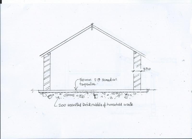

No need to get yourself an engineer charging fancy prices - here's how I'd do it if it were mine; quick and economical, no need for piles etc.
Thanks Tony! No need for steel or expansion joints? This slab will need to take the weight of vehicles and is quite large.
