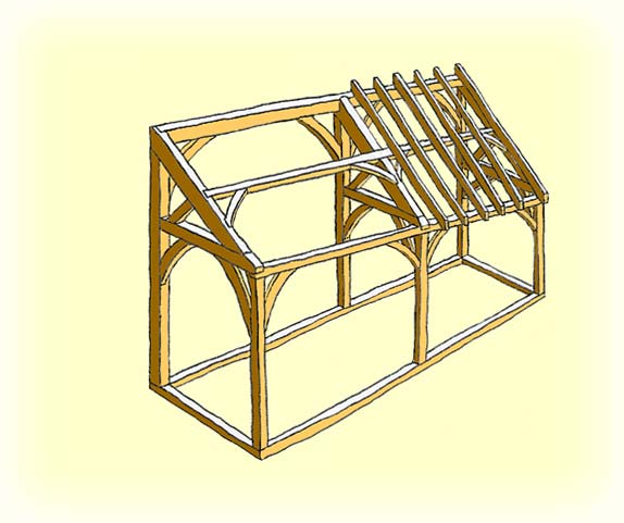

I am planning on tackling my extension this year.
I would like to have exposed oak beams in the sitting room area.
Because they are exposed i will not be packing them with insulation as this will go over the top of them and i will create a warm roof.
I plan on doing 18mm ply sheets over the joists, then 125mm insulation, then 18mm ply sheets over insulation, then membrane, then tile.
Questions are:
1) any idea on the sizes of oak beam i will need if 4.5m span. Are the beams wider rather than narrow and tall like a normal joist ?
2) Is it easy to tile onto membrane and ply, or do you need to use lats ?
3) My roof pitch is probably going to come in at 15 degrees, so i know this is an issue. Have found this product. http://easyroofs.co.uk as i want to use slate. That way i can do it all myself. I think fibre glass wouldn't look so good and zinc would be pricey. Roof area = 70sqm.

1. Are you using these just like normal cut/flat roof joists or are you going to do a proper oak frame, king posts etc.
2. If you have a low pitch many manufactures require you to board and lay tiles.
3. Same as 2.
Sounds to me like your terminology is a wee bit off. Do you mean rafters (sloping ones) when you say joists?
I have just built an oak porch (finished Friday) and it is a bu££er to work with. Everything needs pre-drilling and it is very expensive regardless. We had some oak matchboard machined up that we used as sarking boards prior to lath and felt, so that when you look up you see oak rafters and oak sarking.
You may be able to design say a pair or a trio of king trusses that will be able to support the entire roof but it will cost thousands. Alternatively you could have a steel beam supporting at the ridge but this would mean having a small ceiling section high up. A joiner may be able to make structural oak trusses with a raised tie, but again, be prepared to pay thousands.

The idea is to just use oak rafters spanning 4.5m and resting on block walls. So i would get the beams in the ceiling effect. Basically i am swapping ceiling joists (rafters) for oak.
My roof will be coming off the back wall of the house and sloping downwards, so a simple flattish roof at a lowish angle (15 degrees).
The Frame bit i was thinking of having was on the wall into the garden where i will have french doors and windows. Would have a larger timber spanning across the width here and some posts holding it up, but this would actually be for effect because the block walls at left and right sides would be doing the structural work.

So an oak mono pitch?
I would have though BC would want some form of design as it's not 'standard'. If you work off normal span tables it might not be correct for green oak and kiln dried will be too expensive.
Yes, but my rafters are going side to side, not front to back. Not standard i know. Instead of a frame i will have block work holding up the timbers. Makes sense to me as cheaper as don't need the frame, but i get the exposed beam timbers plus some frame work at the front window section which will be more for visual effect. Hope to speak to oak supplier tomorrow.
