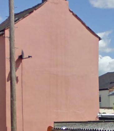

Here I am most concerned about the chimney breast. I've found evidence of frequent re-painting internally (at least once a year... maybe they just wanted a different colour, but...). Looking at Street View from 2009 I see the following:
There appears to be visible damp/water marks on the chimney breast. Also some visible distortion at 1st and 2nd floor level (the property is 3-storey, floors are of "timber suspended construction"). How alarmed should I be about this? The house has since been painted (at least 2 years ago) and neither issue is evident (it's no longer pink, either!).

The chimney flues can both be seen "grinning" thro the gable render. This is due to lack of ventilation and not sweeping of the flues allowing soot to turn acidic, and perhaps water penetration of the chimney stack. Sweep and vent - read up on here for much relevant information. Again, not a big issue.
Most internal plaster/damp/salts issues are simple enough to carry out. The damp indications on either side of the c/breast are probably connected with the sooty flues.
