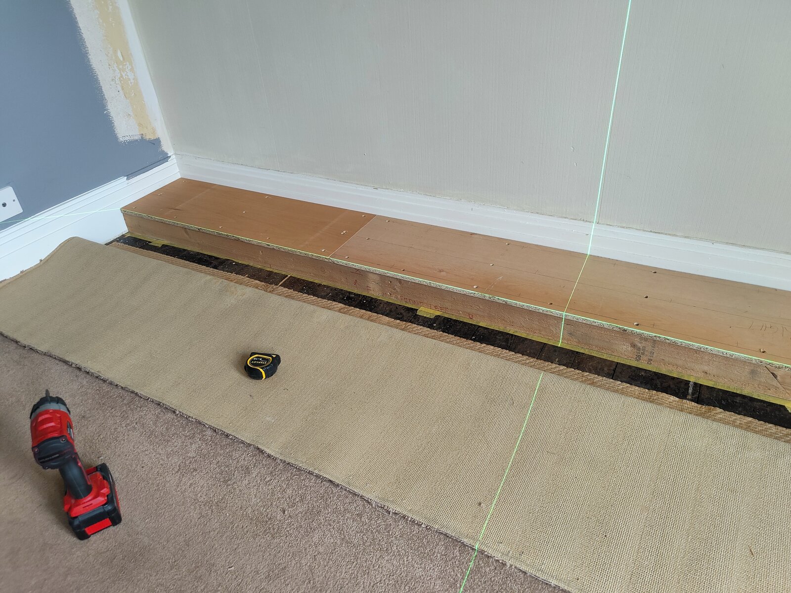

Hi
I have a large vinyl record collection that I want to build a built in bookcase/shelving unit for. Obviously it will need to bear a heavy load, I will use plywood for the bookcase with a base to support the bookcase.
It will be between two chimney breasts with four shelves, the chimney breasts are over 2000mm apart so the bookcase will span quite a long space.
The main problem I think I'm facing is that the floor isnt level - its an old Victorian terraced house with old floor joists and floorboards. Theres a four centre meter difference between the highest and lowest point. Its also complicated further by the slant not being uniform - there isnt a straight line from the highest to the lowest point.
In terms of aesthetics would the difference in height be a problem, would it being on a slant be too much? And if so, and bearing in mind the load that the unit wold have to support how would I go about levelling it out without compromising the structure?
Thanks in advance for any help
just build a sub base first -made of timber with a ply top, scribe it so its dead level -screw it to the floor
then stick your bookshelves on top
hide the sub base with abit of skirting

As above, like this, except I was a cheapskate and used a bit of old chipboard shelving I had lying around:

Excuse my ignorance but how would I scribe the base - I’ve scribed infils and shelves but never anything like that?

With a laser level, which you can see is the green lines in the pic. You can pick up levels for about £30 at Screwfix etc. Just fine for DIY, I have the Magnusson one, it does what it says.
