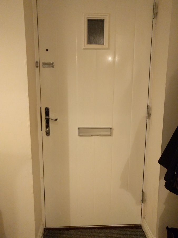

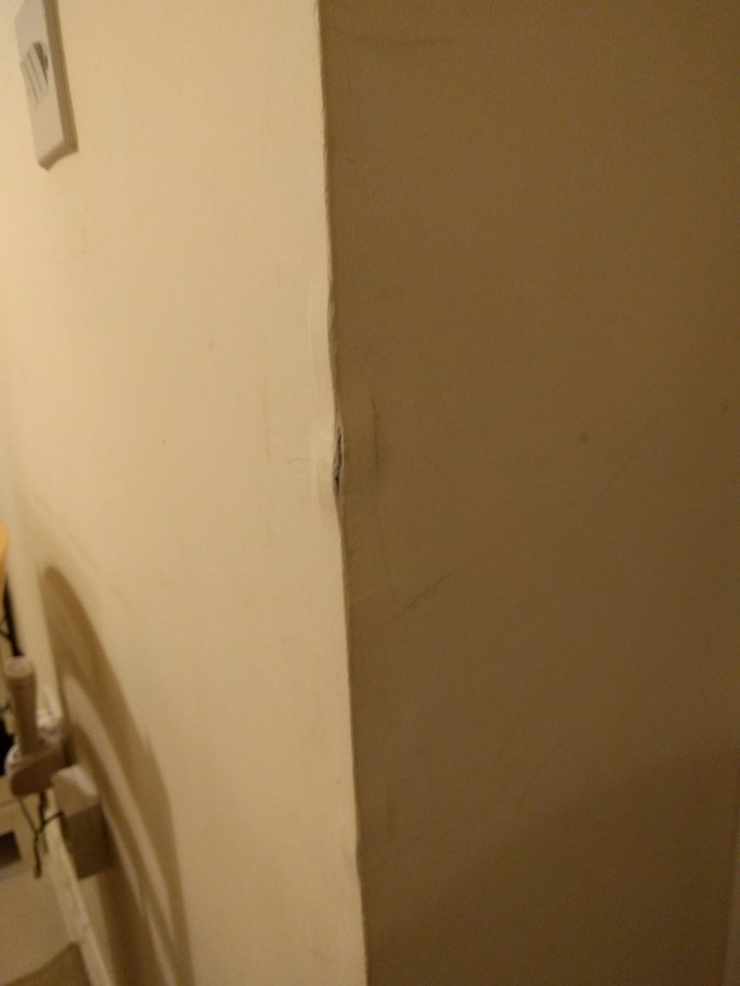

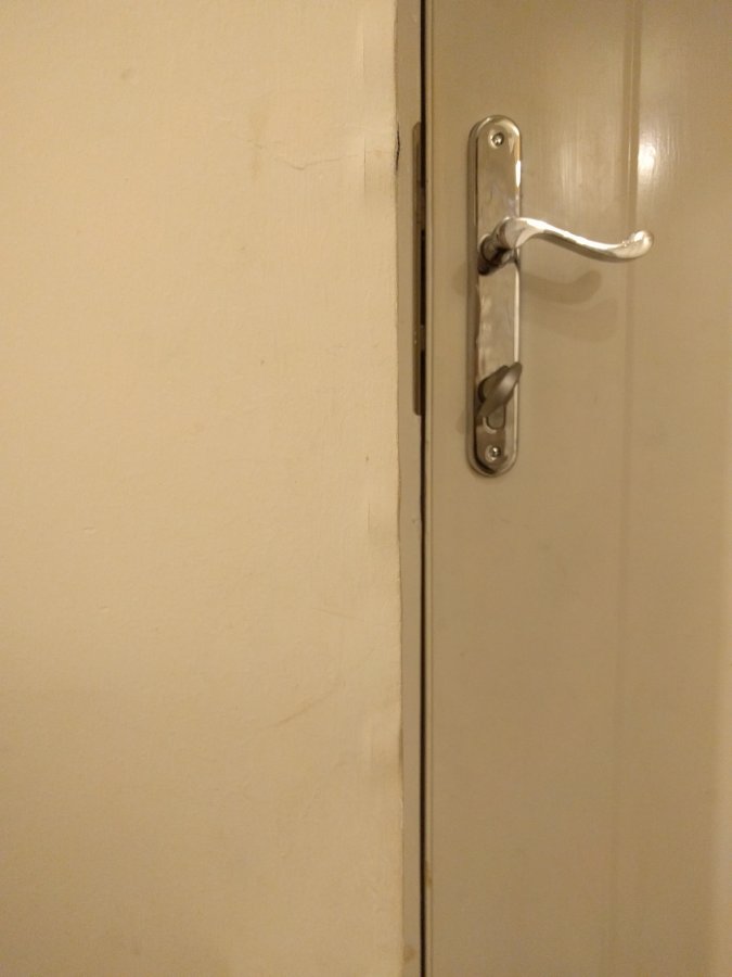

Firstly, this problem has been present since we purchased the house, but it's more getting more noticeable as the area gets bashed on the way in and out.
You can hopefully see from the pictures that the external corner in the doorway is not true, there are bulges and dents up and down the length of the corner, and now some of the bulges are starting to rip.
I assume this was caused by bad workmanship. Is there anything DIY that I can do to fix this, or is it a job for the professionals?

Lightly probe inside any handy gap and check if thats a metal corner bead or simply a paper corner?
I've not poked, but it looks like a paper corner.
One day when I am getting brave I shall try and pull the tape off and replace. Thanks for the help, both.
you might find it easier to replace with a metal skim coat corner bead and then easifill and sand back
Given that the corner is "getting bashed" then it might be best to forget about re-newing the tape or fixing a bead.
Why not instead use a 38mm x 38mm x 2000mm angle of alu. metal from Ironmongers supplies and probably many other outlets.
You cut and drill the corner protector to suit and it will take paint.

Any idea what causes this in the first place? I only ask as I have noticed it starting to happen on one of the upstairs windows too. Is it just poor installation? Probably should add the house was a new build and is just coming up to five years old.
Ordinary paper tape or even metalled tape is not IMO suitable for any outside corners - its typically applied by in a hurry "plasterer's" (or DIY'ers).
Vibration and central heating (expansion etc.) are reasons for it to fail. Applying too dry a tape might also cause delaminating. And, as always, prep & background.

yep poor installation, not bedded into the jointing compound properly, usually not enough compound or compound too dry.
As an update, had a professional in who replaced with metal corners and replastered. Didn't trust myself to do it!
