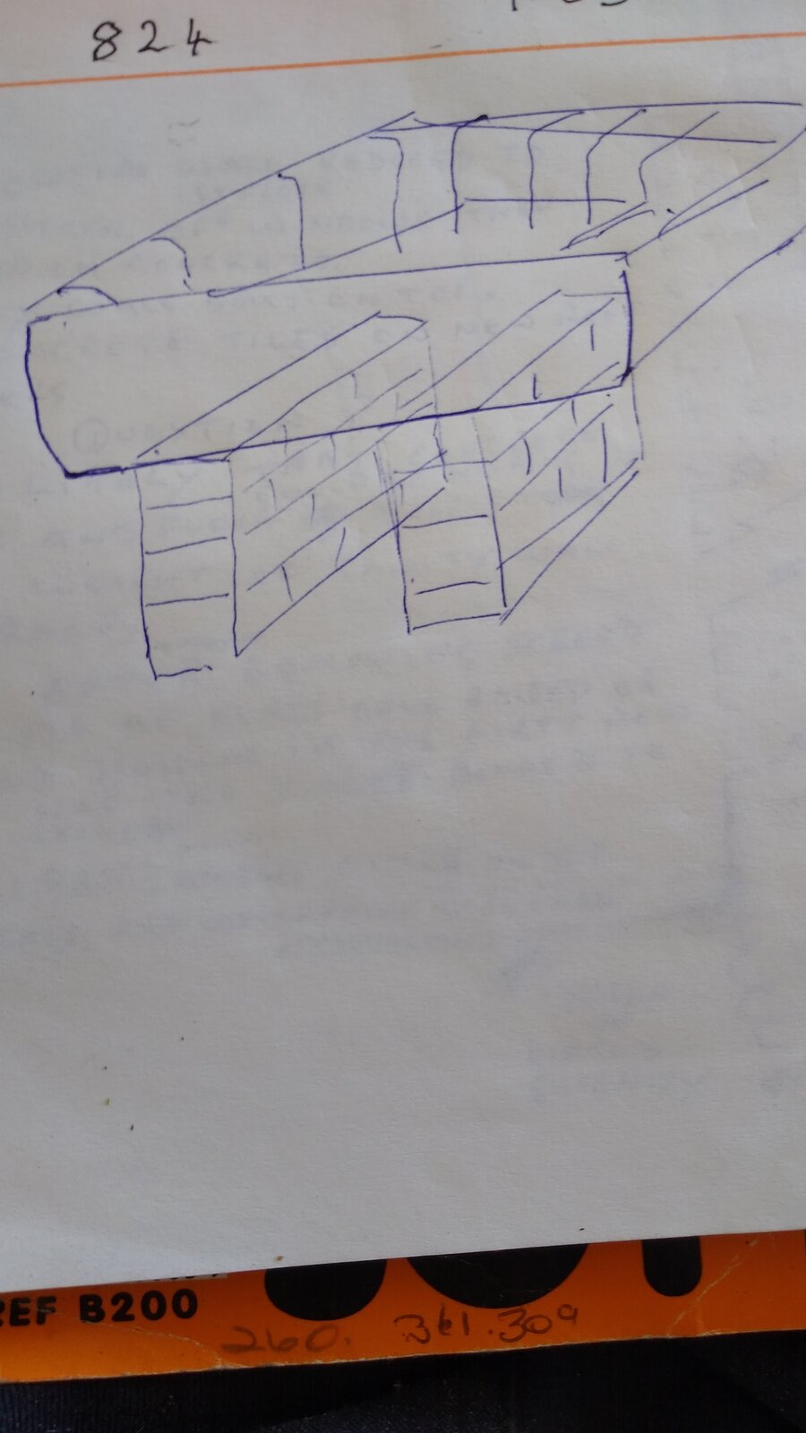

Not too sure if this is the right forum for this but I am building a utility room and just got hold of a massive ceramic butler sink which is 795 wide, 460 deep and 255 high (outside measurements)
It it going to be in the middle of a tumble dryer, sink, washing machine set up with bit of partition in between each item.
What I need is a base for the sink, any idea where I can get one of these for this size sink? I've looked but cannot find anything apart from bastardising something larger
2 or 4 pillars?
As Ive said previously, Im not an artist:) IMG_20210425_174440294.jpg
Its more the height that is going to be the problem, I need something that is, lets say worktop is 900 high minus the thickness (lets say 40mm) minus the sink height which is 255 would mean I need something that is around 600 high so I need a base that is 800 wide x at least 460 deep x 600 high.
Do it as per the sketch above and the base unit as a cover up with doors.
