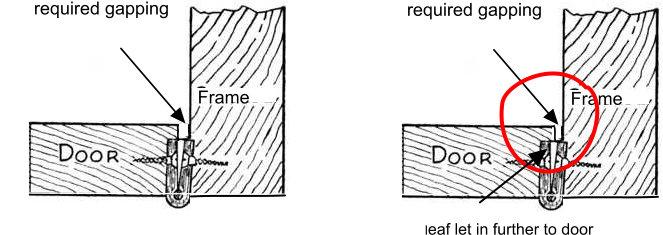

Evening all.
I was wondering if anyone could explain the best way I can determine the gap I would get from a hinge.
Some doors I've hung I allow about 2mm either side and with the thin 3 inch hinges the door shuts nice.
But when hanging a 4 inch butt hinge which is thicker the door doesn't shut, it hits the jamb.
I know it's a thicker hinge, obviously, but there must be a way of determing the right gap.
Any help would be great
Thank you

It's a new door in a new door lining, solid core door etc so I was going to use the 4 inch butts. Just want to frame the lining to the right width that's all.
Usually I hang the hollow core doors and use the 3 inch butts, thin hinges.
I always rebate the hinges flush to the door and lining.

if you do have a spot of trouble just sink the hinges in a bit more.
Letting in butt hinges into a door requires you to measure accurately, the thickness of the hinge at the knuckle this determines the amount you you let it into the door/post. 4" butts tend to be used on thicker doors i.e. 1 3/4" (45mm) door blanks, fire doors etc. and because of this they inevitably require a bit more clearance than there thinner internal counterparts.
Have a llok at the sketch, this is the way I set up letting in both door and frame leaves of the hinges. Now lets assume you want 4mm clearance all round, you start by measuring the thickness of the hinge at the knuckle, from outer hinge leaf face to the centre of the hinge pin, by calculation this determines the setting for a marking gauge to mark the door face for the depth of gap require i.e. how much do you leave sticking out after letting in the hinges door leaf. Check the sketches above and I think that is clear, but let me know if it's not to you...pinenot :)
