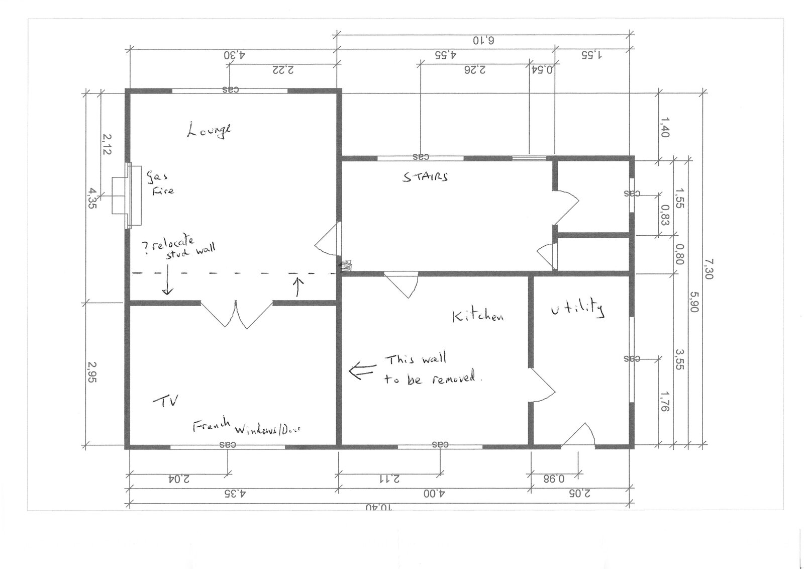

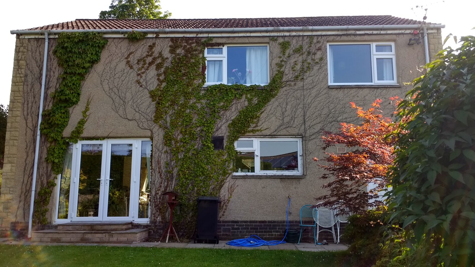

Here's a floor plan and the rear elevation. The wall in question is shown between the kitchen and the 'TV' room. At the moment there is a stud wall separating the TV and lounge rooms. We propose to move this back in line with the wall between the kitchen and hallway so that the finished larger room is of the same width the full length. The repositioned stud wall will be in line with a steel girder which is along the dotted line in the diagram, between the ceiling and upstairs floor. (The joists run parallel to the wall being removed, resting on the steel).
Apart from the studwall mentioned above, all other downstairs walls are masonry. Where the kitchen/hallway wall meets the lounge wall there is a solid pier that is supporting one end of the steel above. This is clearly a central support and is one reason why leaving a 500mm section of the wall in place as a buttress has been suggested. As noted above the task is to guarantee the lateral stability of the outside wall.

Thanks gentlemen. I can see there is an interesting etymological discussion to be had on the varied uses of the word 'buttress' and I apologise if I've used it in other than the narrow technical meaning of lateral support to a wall. The central pillar that supports the steel beam does need to be supported in a sideways sense - that's provided by the wall either side of it, and no doubt is why the engineer would like to see part of the wall left in place at that point.
My main query though is how extensive would works to strap the floor to the walls be - if there is none currently present, and if it was thought necessary? (And thinking about it, do they mean the ground floor, or the first floor floor?). Is it a DIY job, or highly specialised?

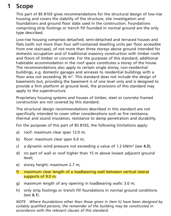

This is direct from the BS for Low Rise Buildings.
Anything more than 9.0m in length requires buttressing unless it can be proved to work by other methods. While it may be possible to prove buttressing isn't required for buildings longer than 9m, the additional design time means that most houses are less than 9m without buttressing or they have a spine wall or other buttressing wall somewhere along that 9m length.
Thank you RR, that is useful. The length of external wall once the internal wall is down would be very close to 9m, so I can see why leaving a 500mm piece of the wall intact on the external wall side was suggested.

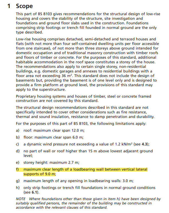

Well, "typical" homes (ones built by the Taylor Wimpeys, Bellways etc) tend to not be more than 9m long to avoid the issue stated in the extract above. If they are, typically they will have a load-bearing buttressing wall splitting up the 9m length.
I do remember an occasion where a colleague of mine fudged the calcs to allow a greater unbuttressed length than 9m on a particular house type. It opened a big can of worms with the NHBC and building control.
Going outside of the 9m limit would mean having to prove adequacy by additional calcs, and maybe more strapping etc to provide sufficient head restraint etc.
