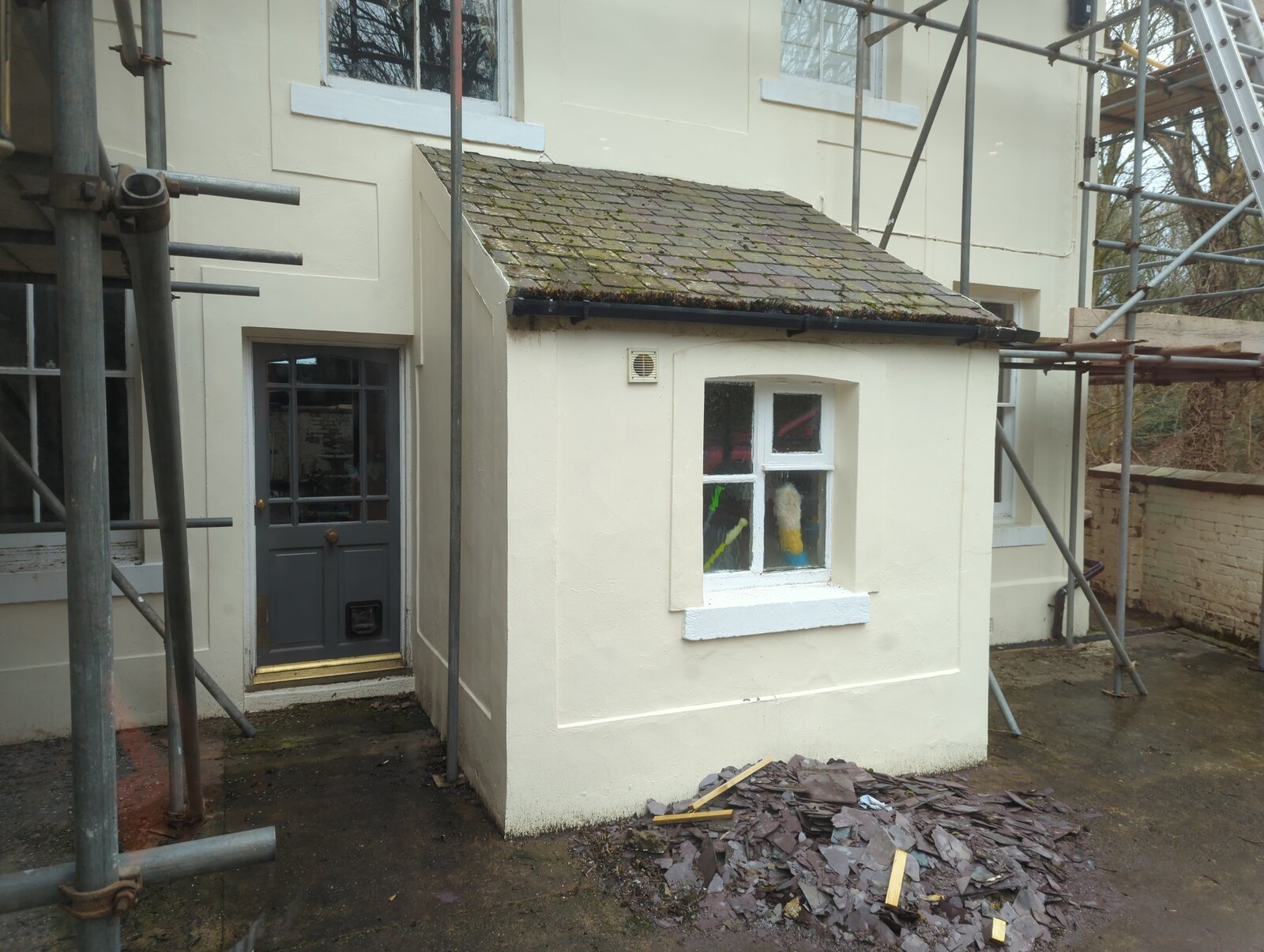

Other issues with a tower is that it cannot provide access to some areas sure to outbuildings jutting out... A 2m long tower simply won't fit whereas a scaffold run can easily be fit around it. I can't really access these areas by ladder for the same reason, my perfect solution would be a lightweight tower that's 3m long, does this exist?

This is the problem case, though I also have two large bay windows at the front which likewise cause issues. I need to measure the widths.
