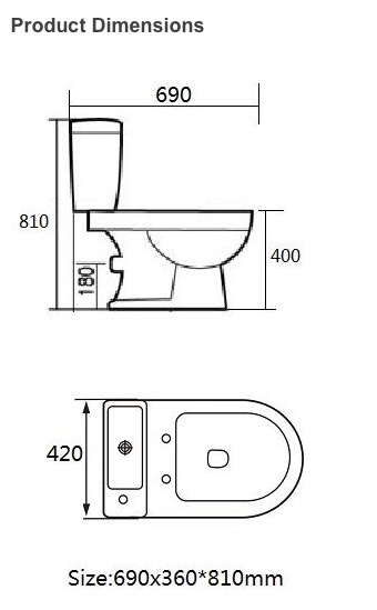

I'm about to fit a new toilet. We've found one we want to buy, but how do I know if it'll fit between the wall and the waste pipe? The diagram and measurements aren't clear to me, and I asked the suppliers but they said they need to contact China for an answer? Am I right in thinking that toilets are universal and I'd just need to buy the appropriate 'elbow-what's-it-called pipe' to fit? Our bathroom and spare toilet waste pipes are at different distances from the wall, hence my confusion.

Ok thanks. The waste pipe starts 5cm from the wall, so I'm guessing there'll plenty of room for manoeuvre?
This is the diagram. Soil pipe starts 5cm from wall. It looks as though it's ok but am left guessing by the lack of measurements at the back?
You need to measure the distance from your floor to the centreline of the soil pipe coming through the wall (if yours comes through the wall). If it's more than 180mm, you need to choose a different toilet
The measurement of 180mm from floor to centre of the outlet is important so is that the same as what you have now? After that then it is a case of cutting back pipes as required and using new fittings. You don`t say if the current arrangement exits down through the floor or horizontal through the back wall and my crystal ball isn`t working today. :)

Thanks for all the advice. Soil pipe comes up from floor. From wall to centre of the soil pipe is 10cm. Soil pipe is 10cm diameter and 9.5cm high.
Looks like there is sufficient space for the soil pipe to be fitted, but you might be left with a gap that needs filling between the back of the cistern and the wall

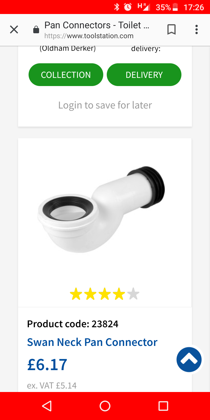

Although the dimension is missing, if the soil pipe is close to the wall and the drawing is even vaugely to scale it should be fine. Worst case use a swan neck:
