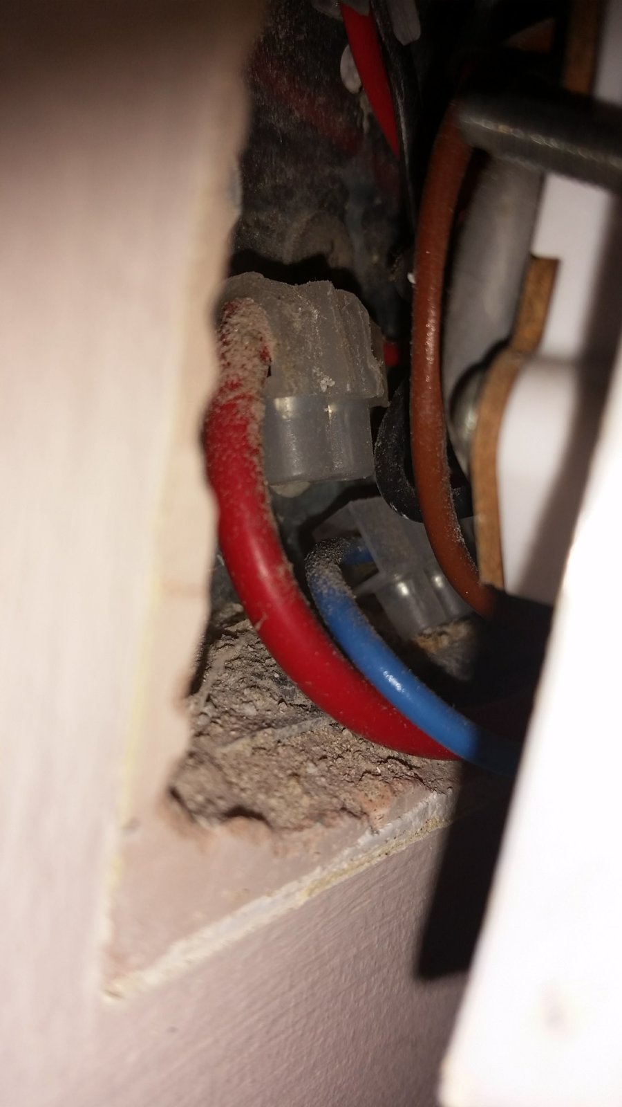

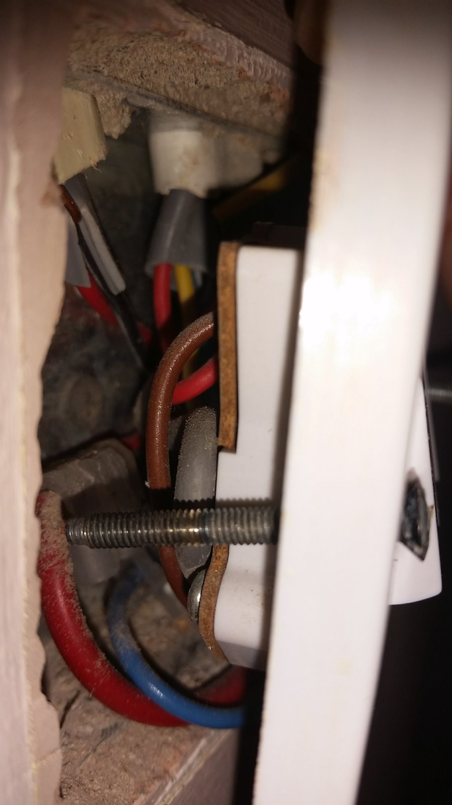

OK I managed to get some photos behind the light switch (its a three gang switch) closest to you in the pic is the outside light the other two are downstairs and upstairs lights. I couldn't pull the switch anymore forward as the cables are quite tight. I can see where the white cable (seen in the photo of the light sensor) comes into the backplate. There is a brown, blue and red cable. The red cable looks quite thicker than the others so im assuming its a sleeve? The brown cable goes into the back of the switch at the top, the red and blue are joined to other cables using blocks.

Just realised. I can't see where the cable from the outside light comes into play. But im assuming it must be at the other side of the blocks seen in the pictures?
Doing electrical work by guessing/assuming is a mug's game.
You're going to have to pull the switch out enough to work on, and you should replace that flex with 4-core, so that you can take an earth to the light. Even if the one currently there doesn't need one, there is supposed to be one taken to that point.
As I read it, the black box in the first post is just the sensor, and the outside light is elsewhere.
It's *probably* a case of altering the wiring behind the switch and the white cable will no longer required. If so, it should be ideally be removed (but you probably won't need to replace it)
But as BAS said, probably doesn't cut it. Probably leads to bangs and lets the magic smoke out. You need to get in behind the switch to find out. A three gang switch will be attached to quite a few solid copper conductors so it can be expected to be a bit stiff, but if it was put in, it should come out.
Tom
