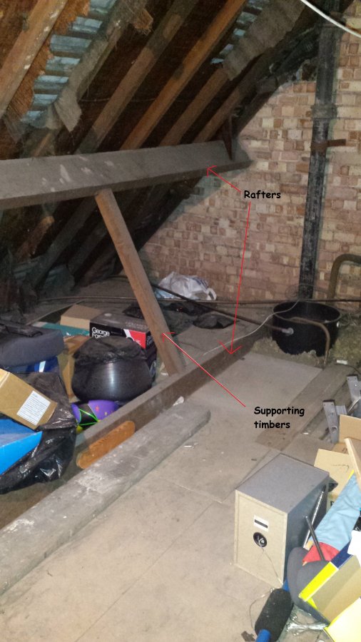

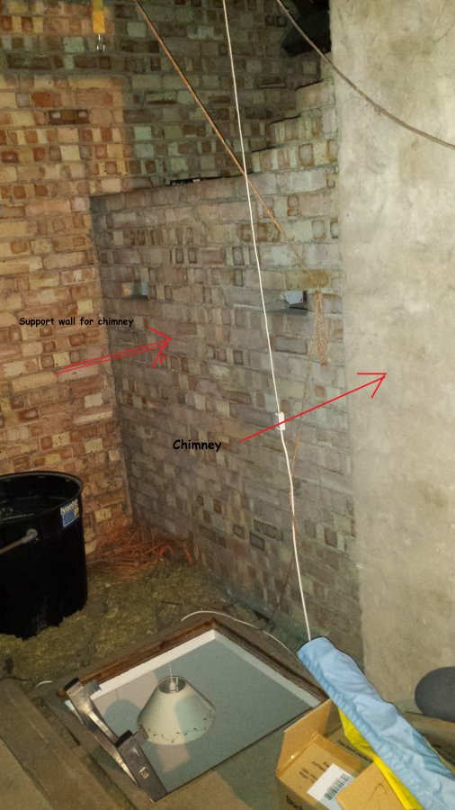

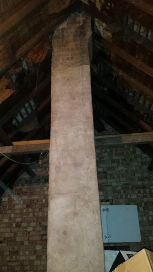

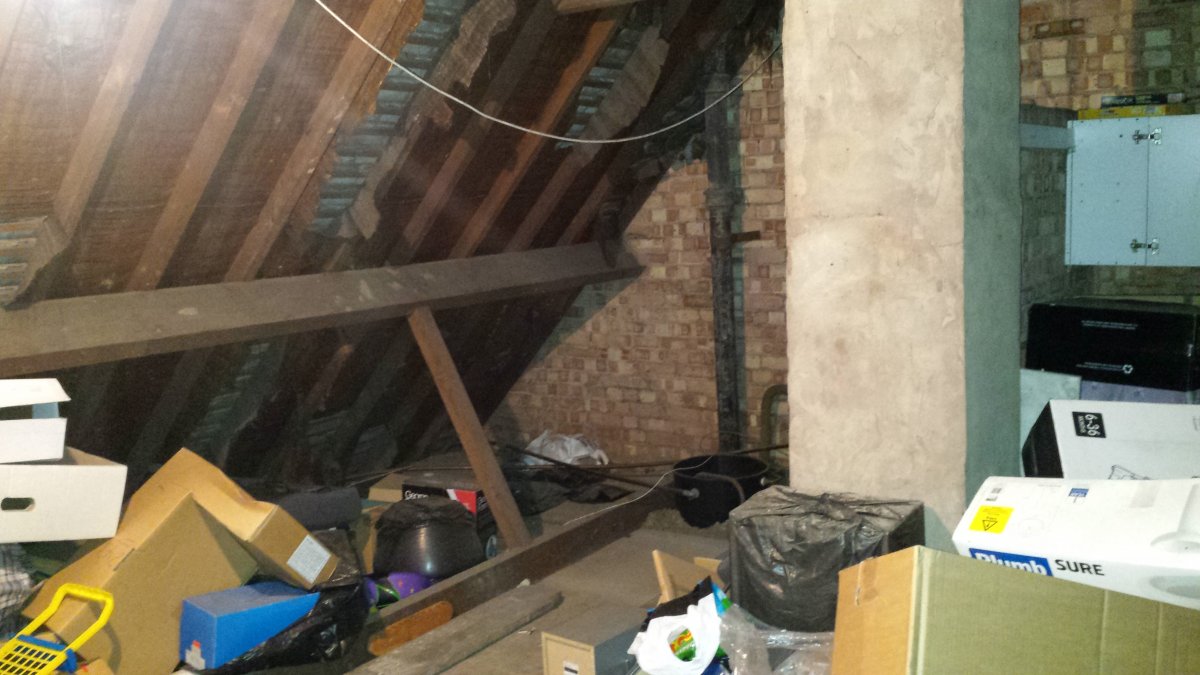

I had a builder in to get a quick idea and he said we could go party wall to party wall as span from front to back is 7 meters with no supporting wall in the middle which he said would be a problem to overcome. We also have a small chimney going through the middle off the loft which would be a problem. Theres also 2 very large beams going from party wall to party wall which appear to be supporting rafters, with timbers holding up the roof, which would get in the way of RSJs.
The loft space is very high, from the ceiling joists to the highest point of the roof is 7 meters high so height may not be a problem.
Il post some pics up tomorow of the obstructions the builder mentioned so u guys can get a better idea of the layout
Hello
I've taken some photos of the loft and the structure. Please note the floorboards were placed by previous owner onto the existing beams.
From these pics would it be possible to advise of what may be required for the loft conversion? Would timber be a suitable materials or will it have to be RSJ's?
Another concern is what happens to the small wall, about 1.5 meters high they have build thats attached to the chimney? It appears to be resting on a small RSJ between party wall and chimney. As you can see loft is very high, center point is almost 7 meteres
