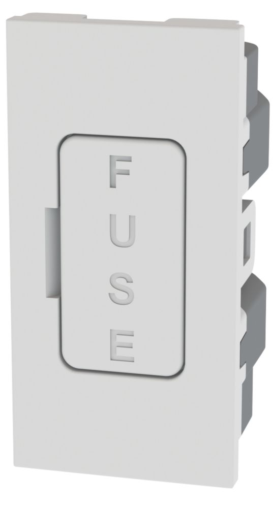

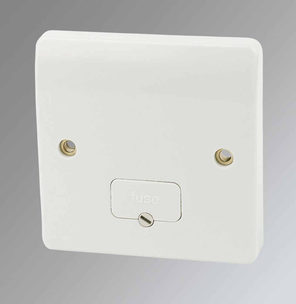

A clock outlet likely looks the neatest
and has a 1 amp fuse, however they have become rather expensive, so a fused connection unit FCU
29775_P
is normal way to do it, you can get switched versions, or you can build your own this
29759_P
can be combined with this
ae235

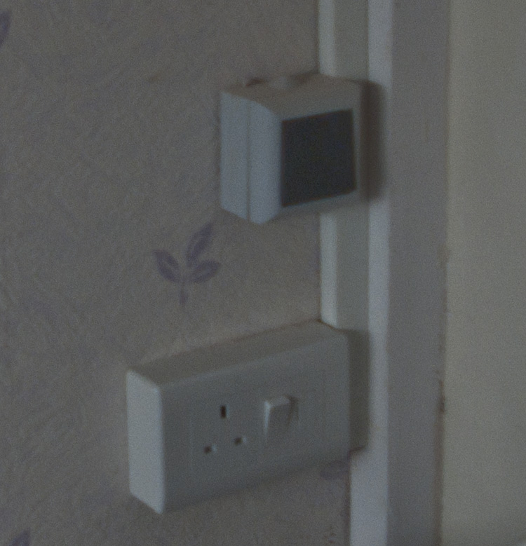

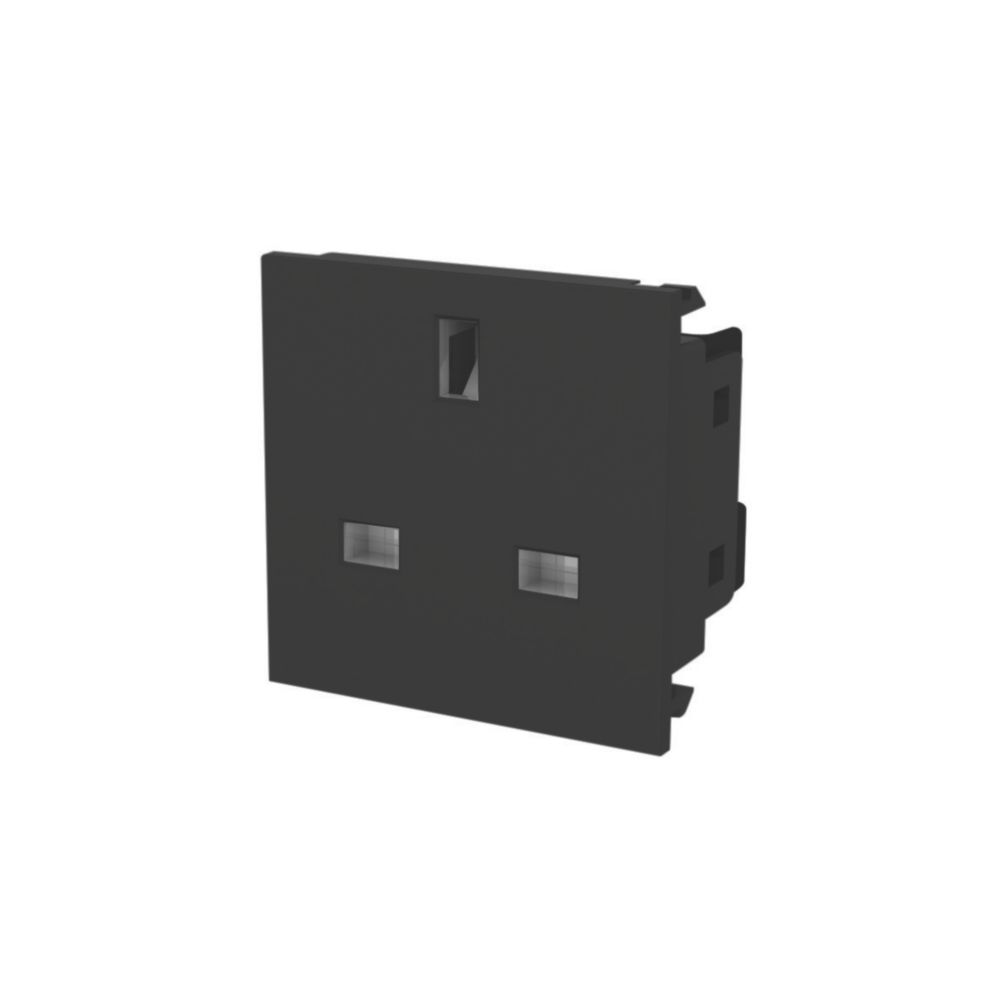

also in white and this plus a blank or switch in a 4 module plate to form a FCU and socket combined. As I did here IMGP7387.jpg when I wanted extra spurs from the socket, main point is you need a fuse if coming from a socket supply.
