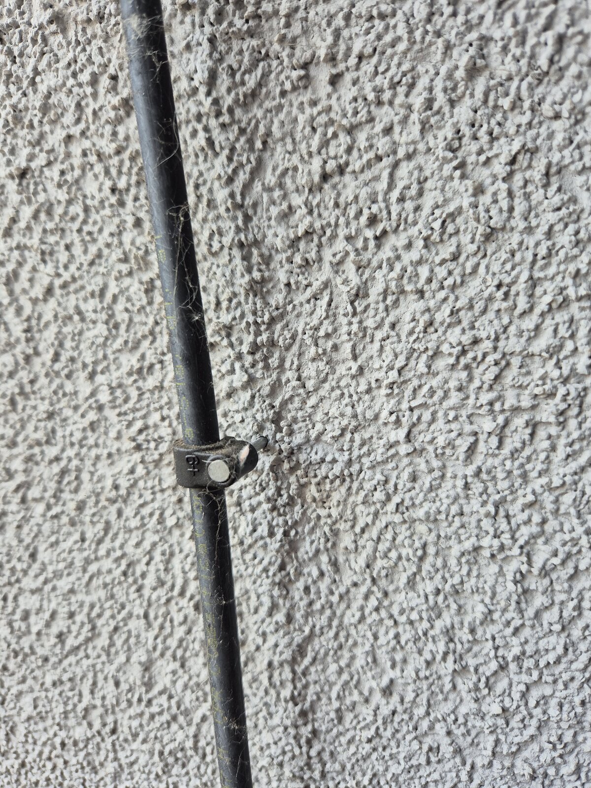

Hi, anyone that can give me advice here. Is there a better alternative to stick my internet fibre cable outside instead of these clips? They are all starting to fall off!
I need something good as it is going onto the external wall installation material.

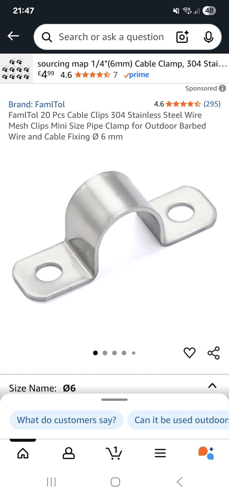

It is the coax cable I want to secure properly. Are these going to be good do you think?!
Your chances of success, depend on the insulation material. You could try screwing a wood screw, or better a self tapper, directly in, and see how well it holds. The clips would probably be fine, if they fit your cable.
The clips should fit as the black round clips I got previously are 6mm.

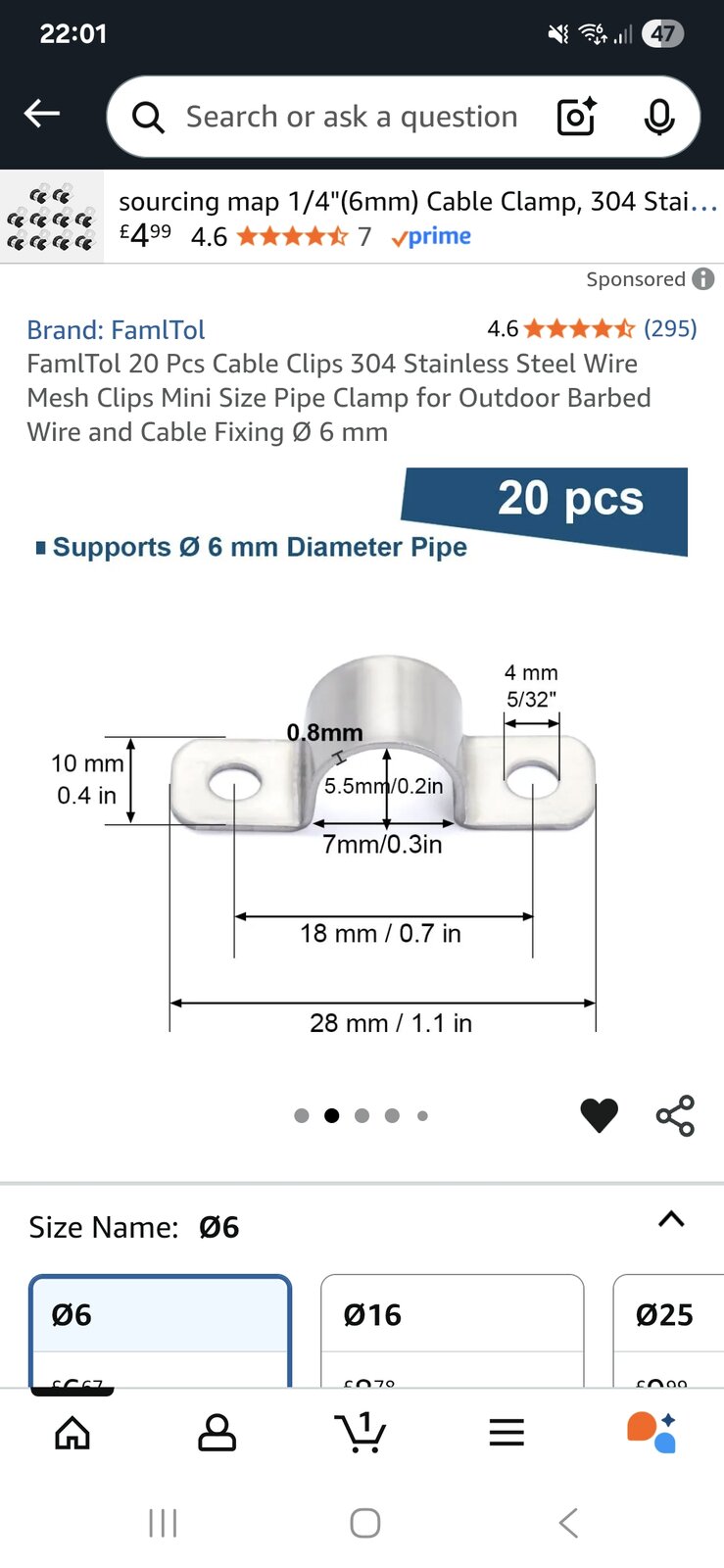

What screw size would I need? 4mm ones? Also what length of the screw would you recommend?
4mm stainless steel, length will depend on how thick the insulation is. Stick a point into the insulation so you can check how long a screw you can get into the insulation.
I was thinking like 20mm or 25mm to be on the safe side?

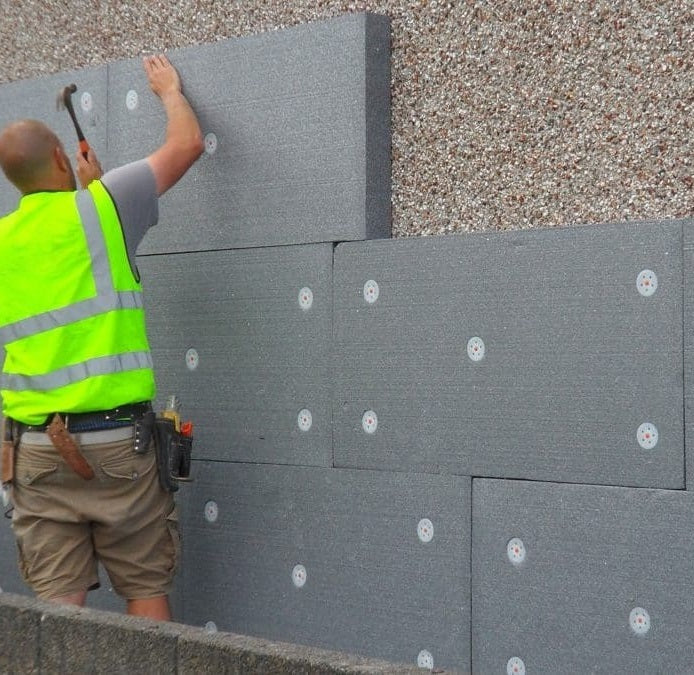

The insulation boards are very thick, it is these grey ones on the wall

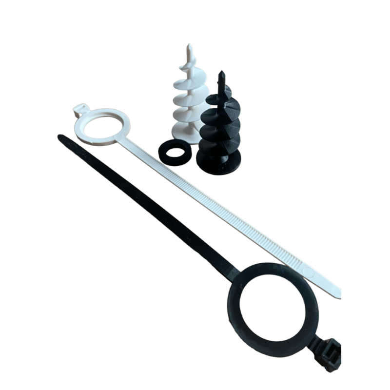

This might be a good idea mate ngl. Couple doors away a neighbour has this type and it looks really secure, and I liked the look of it!
Are they easy to install?
Sure, you just screw them into the wall and attach the tie wraps.
