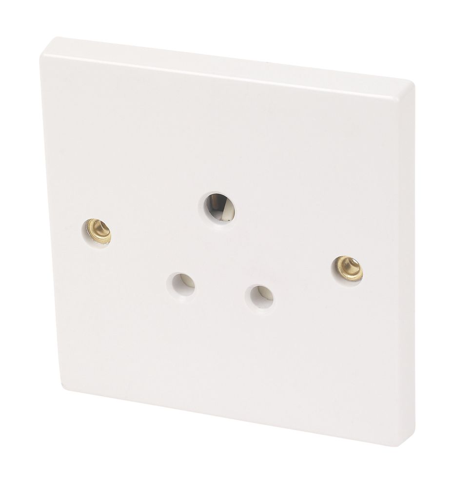

Install a Switched Fused Connection Unit to safely terminate the cable end, fit a three amp fuse to power any cabinet lighting unit.
If it is definately on the lighting circuit then this is an option,
ae235
From ScrewFix Round Pin Socket 5A WhiteProduct Code: 92273
Thanks for reply, what should I have then as I dont want to leave it as it is, looks proper cowboy ?
Assuming you want to use it for lighting, a light switch. If choosing lights, try to avoid any with wall-wart power supplies, as they need a socket to plug into.
The cable coming out of the wall is already connected to a small cabinet type strip light so I dont want to fit something to the wall that needs a plug fitting,
I just want some type of connection unit to fit flush on the wall so it looks a proper job
Cheers
