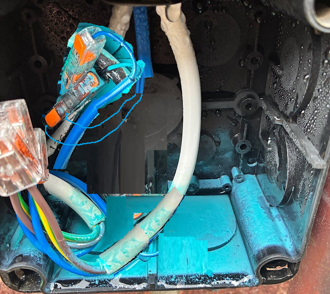

Cable connections/junction box- slight emergency

The original installer has got back to me and said it is the case that the IP66 rated gland installed on the top of the junction box has failed. i.e. not their fault in terms of installation method. Fault of the gland. There's evidently no way (even to my non expert eye) that this gland is going to be weatherproof if installed on top of the junction box as you all have said?

Anyway, it seems clear (?) that if they install another one of these glands on the top of the junction box, it is going to leak?

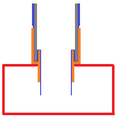

I have used hundreds, possibly thousands, of these and similar types and all they do is pass into the fitting and click in place with a couple of detents into the corrugations without any sealing properties at all. Once fitted they are free to rotate and frequently a sloppy feel. I have frequently found similar leaks to OP's and been tasked with fixing the problem, sometimes expensive.
Any water running down the outside of the conduit will simply go into the fitting, fill up and overflow the internal channel (if there is one), from there it will run into the enclosure.
Anyone saying differently doesn't know what thay are talking about, equally anyone thinking these are IP66 in this orientation is plainly stupid.
I can't find any fitting instructions but if there are any I'd imagine it would recommend not fitting into the top of an enclosure.
Beyond the leak issues there will also be condensation.
Overall it would be better to replace the whole lot with something more appropriate, such as 25mm black conduit and use proper solvent weld properly

Any water running down the outside of the conduit will simply go into the fitting, fill up and overflow the internal channel (if there is one), from there it will run into the enclosure.View attachment 383834

Thanks for the very detailed explanation and diagram (y)
I just wanted a sense check as quite unbelievably the guy is insisting it should be fine and it is a fitting (as in the part) failure. As soon as I had a proper look at the gland it was obvious it was going to leak in that orientation as you say.
Once I get one of two bigger projects out of the way I'll probably redo the whole lot, including the wiring in the loft where it runs to the cylinder, and controls in the airing cupboard below. They just dangled the cables and wires right across a section of loft space used for storage which is again rather irritating. It would have literally taken them two extra minutes just to run the cables in the floor void and then tucked away along the side. Thus, I want to sort that as well. Even the control hub in the airing cupboard they've only bothered to fix with one screw to the wall, so it wiggles about.
Does the conduit run vertically directly to the loft space, if so can that vertical run be moved to where the heat pump is to avoid having the bend/enclosure?
