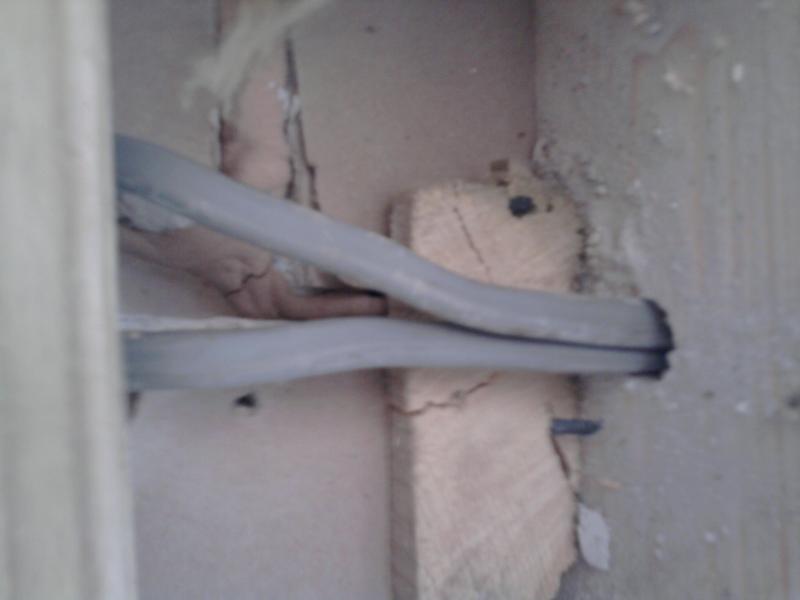

I have 2 power cables for mains sockets running through insulation in a stud partition wall. Only around 6 inches of the cables are in the insulation. The insulation type is wool (rock wool – typical yellow stuff)
My question is, do the cables need to be covered with anything or not?

What I meant was, do they need to be covered with something else to protect them from insulation.
Cables come from under the floor boards and then run vertically up to the socket. The run between floor board and the socket is around 6 inches.
On the assumption we are talking standard cable ie grey or white sheath covering the 3 other wires then i'd say no. If the wires run vertical directly to the socket outlet they are in a safe zone.
Strictly speaking if the cable is touching the inner wall surface then the current carrying capacity of the 2.5mm (I assume) cable drops to 21A and if it isnt touching and just suspended in the insulation then it drops to 13.5A.
But and here i would bow to people with more knowledge if you are talking about a run of 6" i am not sure how much you need to apply the derating.

From what you have said, I assume you have a socket circuit that runs through thermal insulation 150mm up to socket then returns 150mm down.
If the cable is totally surround for this length, a derating factor of 51% will be applied as the run is more than 200mm through the insulation.
So if the circuit cable size is 2.5mm and T&E the capacity will be reduced from 27amps to less than 14amps, if it is 4.0mm T&E 37amps will be reduced to less than 19amps.
So you have problem, to remedy this the cable must not be totally surround or it can be run in conduit which will have a derating factor but not as large.
27amps will become 20amps and 37amps will be reduced to 26amps.
But the next thing we will need to know is the size breaker on this circuit and the size cable?
Here is the picture of the cable. think it is 2.5mm . As I looked at it again to take picture. The run of the cable in the wall is only 4 inches up and then back down. The picture is the back view. I have boarded the socket side.

you need to follow relevant instructions above to make sure cable is not derated to any less than 20A, which is the minimum for cable on a 32A ring

The solution to the original question is simple.
Push the cables against the plasterboard so they are in contact with it, and shove a load of plaster or cement over the cables so they are completely covered.
They are therefore installed as method C, no derating required, and any remaining space can be filled with as much insulation as you want.
The only other thing to do, if not upgrading cable size, would be to split the ring in to two radial circuits protected by 20A breakers. With the the thermal insulated runs installed in conduit.
As for the original question, I will place another piece of plaster board next to the cable and then put insulation in. So the cable will have plaster board on both sides.
