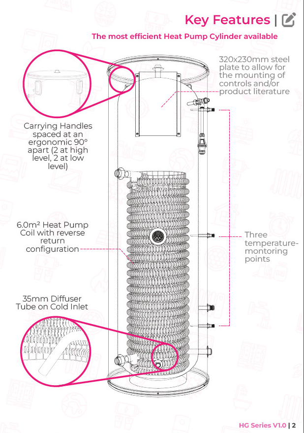

I hadn't realised quite how long these cylinder coils are. As far as I can tell, a 3m² 28mm coil is about 30 metres! That explains why some people struggle with getting enough head from the pump with large surface area coils. I think in the Heat Geek video he says he has got around this problem by running the two coils in parallel.

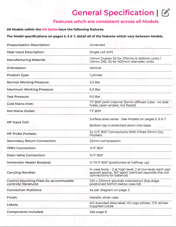

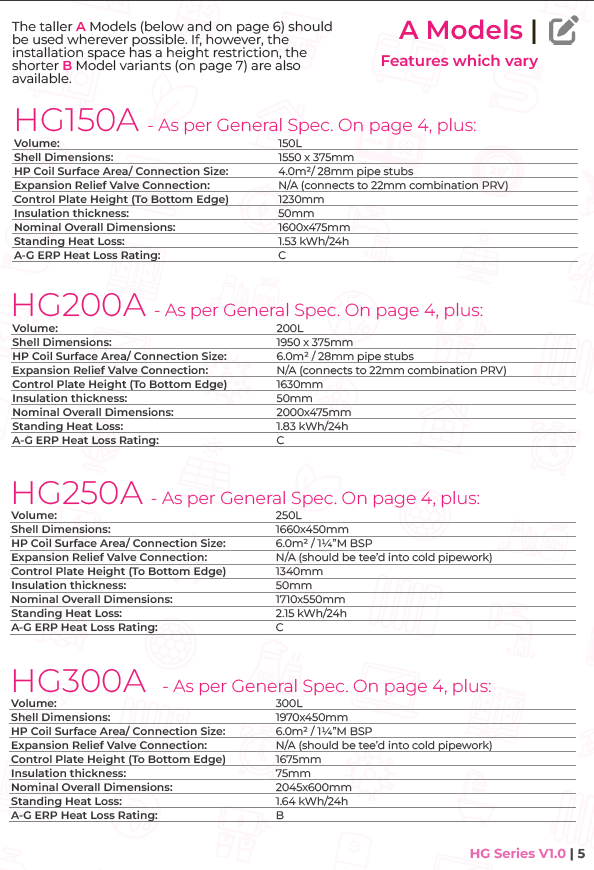

@MNW67 Have a look at the new Newark Heat Geek Cylinder Specs...

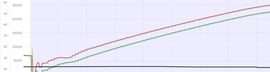

In addition to this you can also see Adam's Cylinder performance here on the Open Energy Monitor Community Forum.

Bigger surface area and bore coil the better, but I'd not be paying significant amounts extra for it.
Im not sure in denmark if the aroTHERM plus is badged the same as here i.e. 7kW @ -7degrees outside 35 flow, or whether they are badged like the European Norm of 7kW at +7degrees outside and 35 flow.
but either way if your running it on ECO DHW which holds the compressor power back to try raise the Flow & return temps in line with the cylinder thus keeping the heat pump running cooler for longer, then it restricts the compressor speed, which means your probably putting out 3-5kw into the coil, so even a 3m coil would be pretty efficient.
Bear in mind in the heatgeek videos, theyre heating the cylinder from nearly cold every time using the ECO setting. Its quite a difference in efficiency to leaving it on constant top up 24/7 and running NORMAL mode (full compressor power to cylinder).
To add, for that little extra effieicny if one or two cylinders a day is enough then only heat it during the day when air temps are warmer (added benifit you loose less heat from the property then aswell) and HeatGeek generally dont do weekly legionella runs either so save again on that.

These 6M2 coils are very tall (by necessity) so IMO unless the full contents are used up and then reheated then its hard to see any huge ROI over a more conventional cylinder, it does state that the "coil has reverse return configuration", wonder does this mean that the hot inlet is into the bottom coil? or is it just counter flow like most are configured, with the hot inlet at the top.

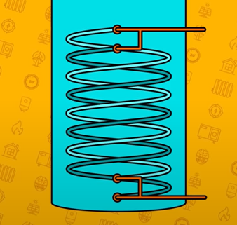

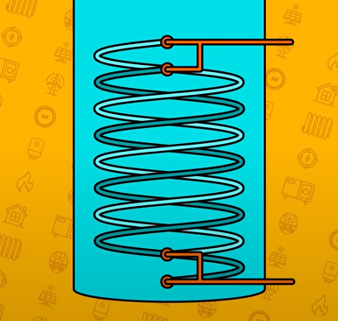

I don't understand what reverse return means but this is what is looks like on his diagram.
