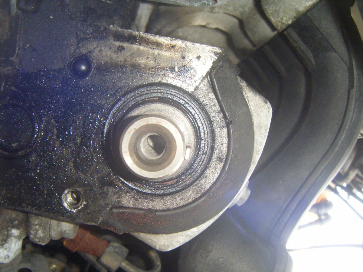

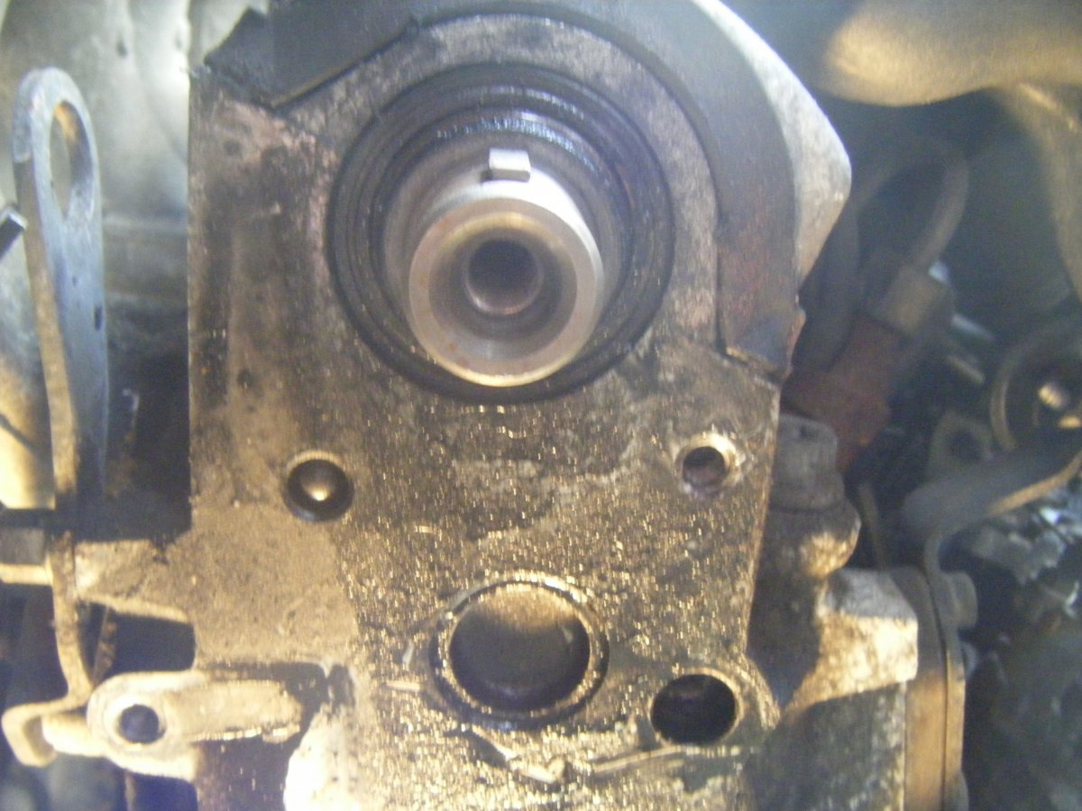

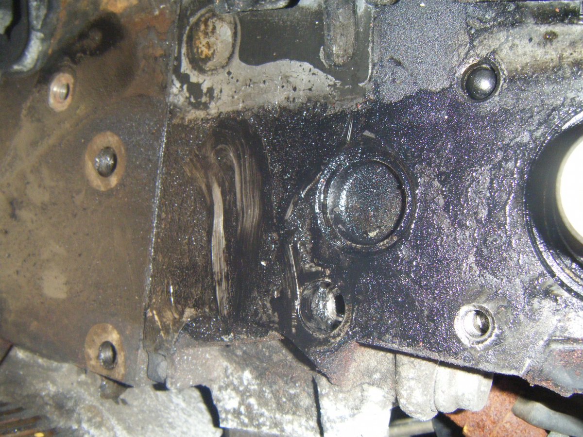

Ok, here's some pics of the end of the cam, I'm convinced it's the cam seal rather than the rocker cover gasket, I got a new one yesterday so what do you think? The end face of the engine is not exactly dripping with oil, but it's definitely seeping out of somewhere! Sorry about the camera angle.
It has to be the camshaft seal really, although its hardly worth worrying about.....its called 'misting' rather than leaking.
Most folks would leave it be but observe it from time to time.
Its not a metal shrouded seal so it should pick out, once everything is cleaned. Once you get stuck in though, there's no turning back!
John :)
Heh, not sure whether I'll bother now, I'll ponder it while I'm doing the water pump. The face is quite oily, but like I say it's hardly flowing out. The timing belt is in surprisingly good shape, no sign of oil contamination except for a splodge which I'm sure I did while I dissembled it all.
That seal has been misting for quite a while and it won't fail all of a sudden. Try bending the belt back on itself, looking for the odd split - sometimes they show up, sometimes they don't. I've replaced many belts with no apparent wear at all, and some that were almost in tatters but they go back to the 80's when OHC belts were just coming in.
