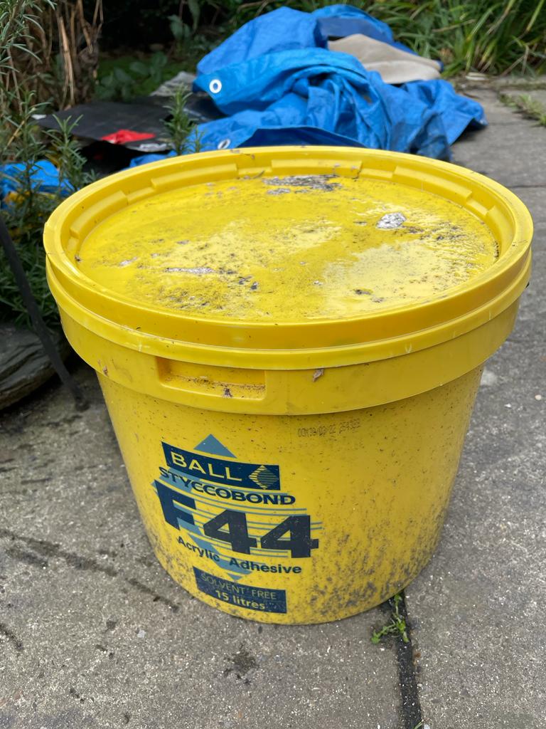

Anyone with experience of luxury vinyl flooring?
I've had Camaro vinyl flooring planks put down in my lounge..
All looks good but there are some gaps.
I can get my finger nails in between. A mate of mine did this and I think he will try and fob me off.
Is there anything I can do?
I thought about Colorfill that you use for kitchen worktops.
LVT tiles can move a little ad there is a tolerance allowed, from memory if you can get a credit card in the crack it's just about in tolerance, they do sometimes move depending on heat/sunlight etc.
If the gap was there from day one, it's probably fitting error or a manufacturing fault (in which case another tile should have been fitted.
It’s a cheap LVT which isn’t very sable. What adhesive did he use.
This stuff.
Cheap? How much a Sq m?
Would have been better using a high temp adhesive like F48 as less likely to shrink.
I sell it for £28m2 but as it’s 2mm thickness with a .3mm wear layer it’s not very strong so can shrink if not using a HT.

in fairness the quality seems OK. It looks good but I want it to last.
Being it is what it is. Can I fill the gaps with Colorfill or Wax.
