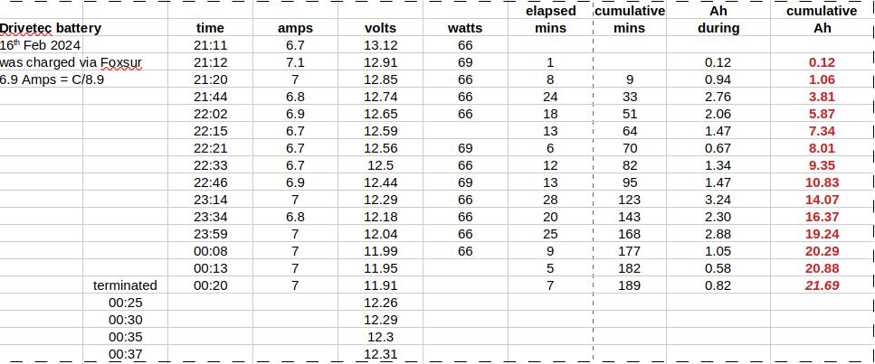

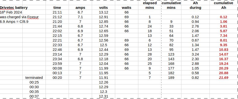

I tried to do a capacity test - discharging at C/8.9 down to 11.9V which should be (?) close to 50% capacity - see attached results.
It is difficult to know what is 50% capacity though when starting voltage is so high.
And looking at the voltage 15 mins after recover - 12.3v and rising, it looks as if there was well over 50% left although again the high fully charged voltage creates some uncertainty about interpreting that figure.
[Caveat - I don't know how accurate clamp meter used to measure discharge current is - will aim to check that, and I don't know what normal 50-% capacity would normally be achievable from a 13 month old, 62Ah battery]

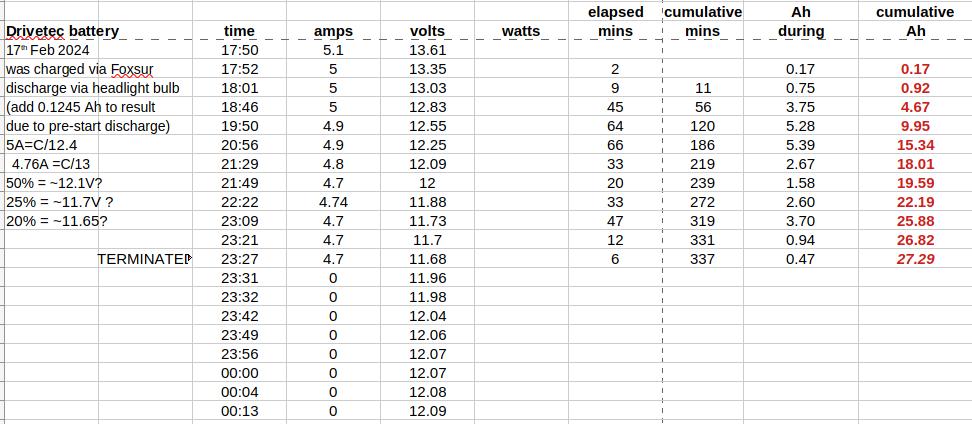

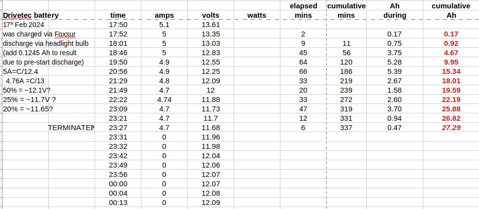

OK - I've discharged it with a headlamp bulb. That gives a current of about 5A which is about C/12.4. I don't want to take it right down to 10V as I gather that would be harmful. At C/12.4, the battery would be totally discharged at 10V - according to the chart at:
https://louwrentius.com/a-practical-understanding-of-lead-acid-batteries.html
I've taken it down to just past 11.7V (and got 27Ah) which, according to the chart, should equate to 25% capacity.
If that chart applies, it looks like battery capacity is down from the nominal 62AH to about 36AH.
BUT, after 45 mins the battery had recovered to 12.09V (and probably still rising) which according to another chart, equates to over 50% state of charge, but that seems unlikely.
