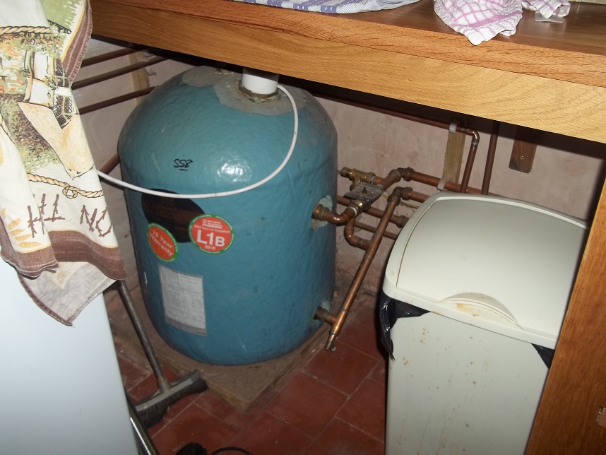

In my case I DIY installed heating and hot water into my Grade II thatched cottage, ( before anyone jumps up a GasSafe engineer installed the boiler ) in 2011. all vented and no problems. One "modernised" plumber ( not the boiler installer ) was very sceptical about vented systems but has now seen the advantages of open vented. He does a lot of work snagging "normal" systems into new builds.
show us pictures of your airing cupboard and pump motorised valves etc so we can see your handy work
show us pictures
Blue cylinder in the kitchen supplies hot water to kitchen, utility room and outside toilet ( used by florist who rents my outbuilding ), The valve actuator has been temporarily removed

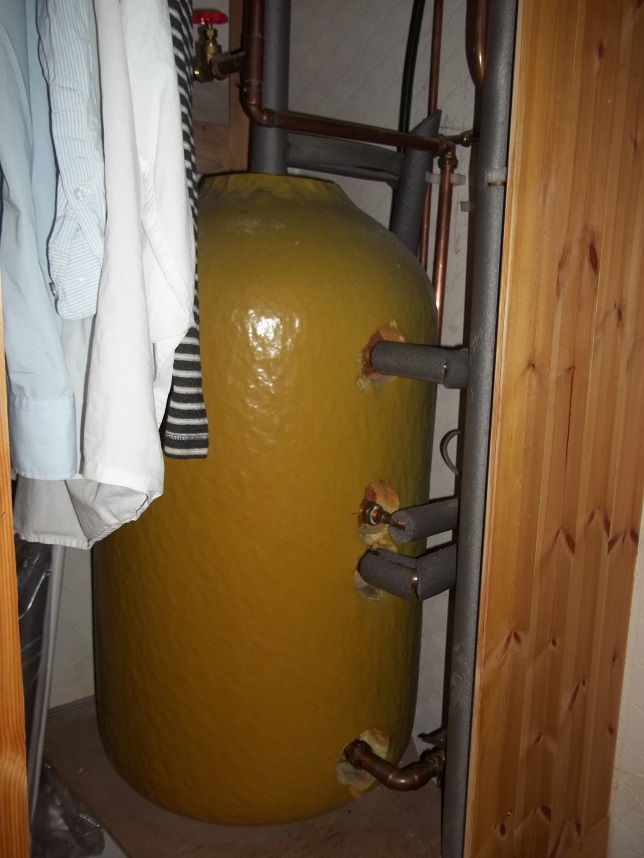

Beige cylinder is in the bath room airing cupboard supplies low pressure hot water to basins and bath and via a second coil mains pressure hot water to the shower

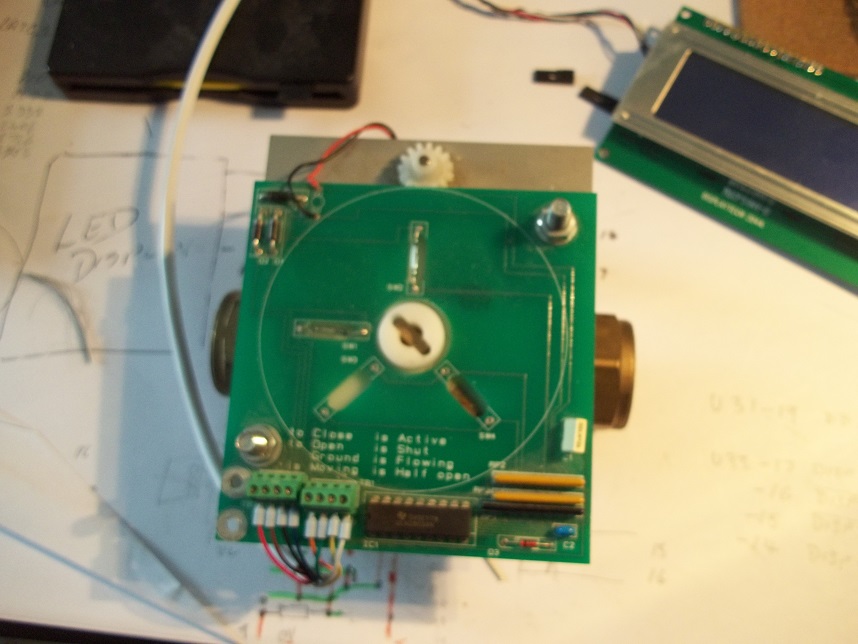

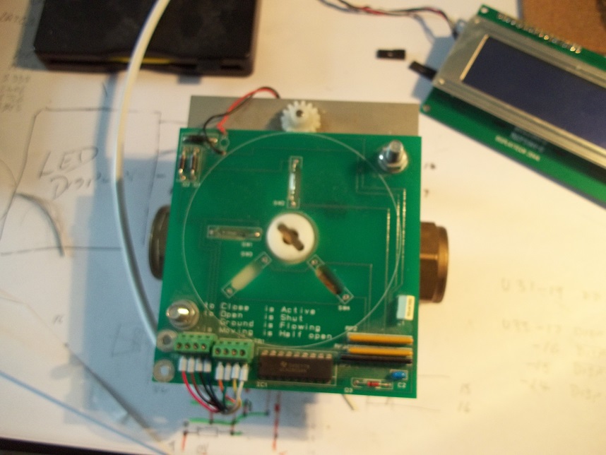

A 12 volt operated valve actuator on the work bench
