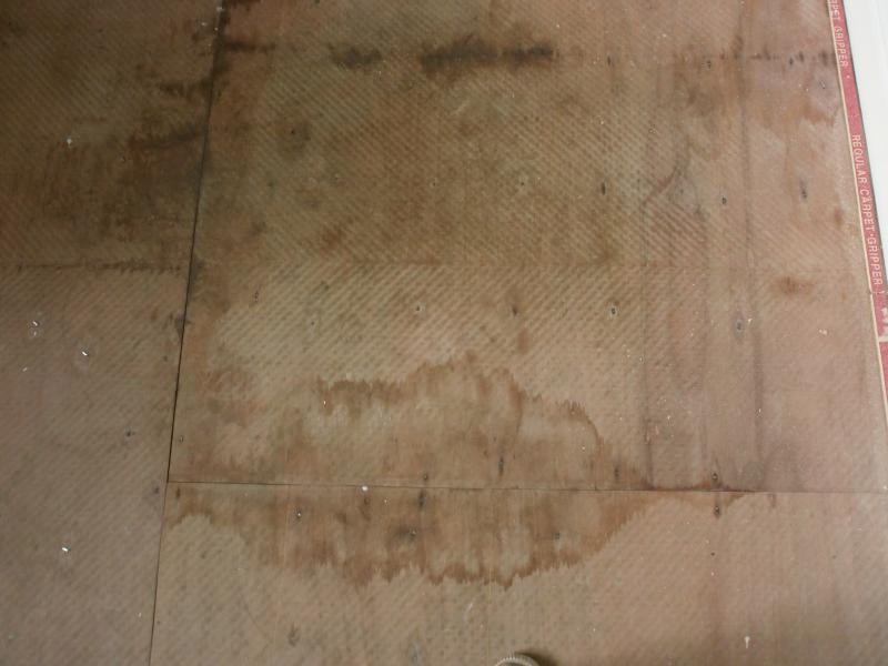

I have done some digging, and its really bizarre. In the bedroom above the lounge, I have lifted the carpet up. Underneath there is some plywood which is only midly water stained:

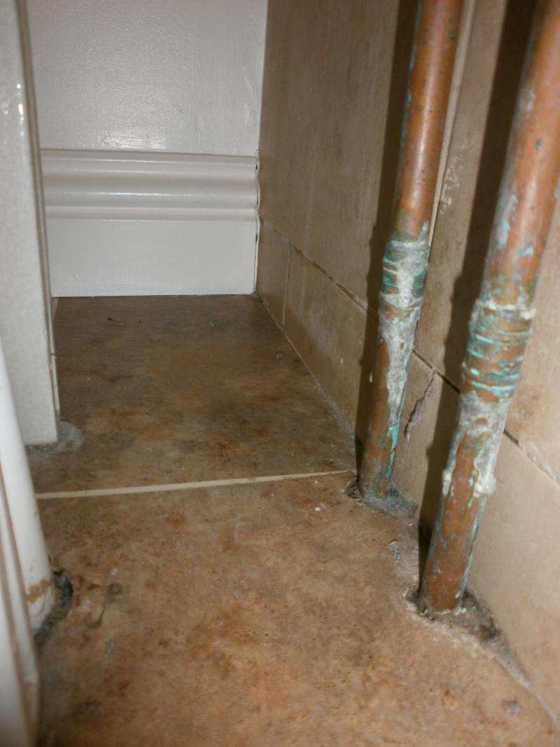

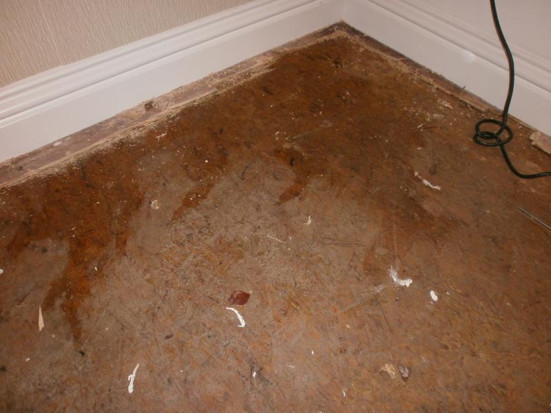

I lifted the plywood up and there was a lot of standing water on top of the next layer - the chipboard. I think its the taps in the bathroom which have leaked, the water has gone through the bottom of the skirting board then under the plywood.

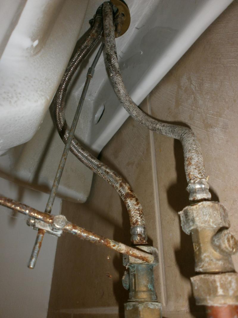

However i have switched the water back on, to check for leaks and its only dripping a little bit I can't work out how so much water has got out! Any ideas? The pipework going to the taps is all rusty, and the house is 5 years old - is that a tell tale sign of leaking or could it be condensation from bathroom anyway??
