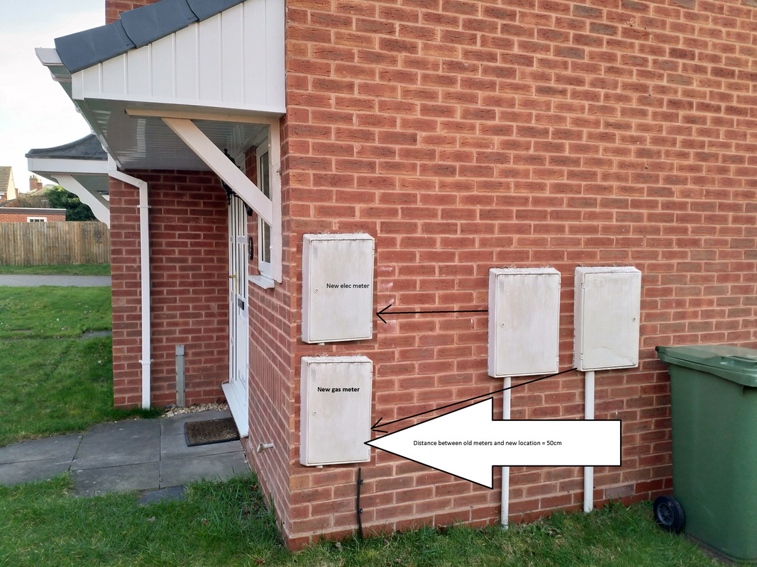

I want Cadent / National Grid to put the meters here, but I can't figure out if this is legal/ can't find any examples
I really want them tiered like this to make way for an extension and to make the move of them cheaper
Any thoughts?
I want Cadent / National Grid to put the meters here, but I can't figure out if this is legal/ can't find any examples ... I really want them tiered like this to make way for an extension and to make the move of them cheaper .... Any thoughts?

I can understand your wanting to get the electricity meter box out of the way of an envisaged extension, but I don't quite understand "..and to make the move of them cheaper".
In terms of your actual question, I'm not aware of anything that would preclude the positioning of the two meter boxes that you are proposing - but others may know more than I do.
Kind Regards, John
with the elec meter in its intended new position the hockey stick cant get to it without going round /through the gas meter or do you intend to move the cable to the cavity
If you want to use the flush type boxes you won’t be able to put the boxes there. The boxes go into the cavity and you’d need them to be further from the corner.
Also I don’t think you can have a hole in the brickwork that big without a mini joist to support the wall. Ask a structural engineer. You may be faced with using surface, not inset boxes.
for the gas you might be able to do a semi-concealed ground box at the front, which leaves the side wall free for the electric.
