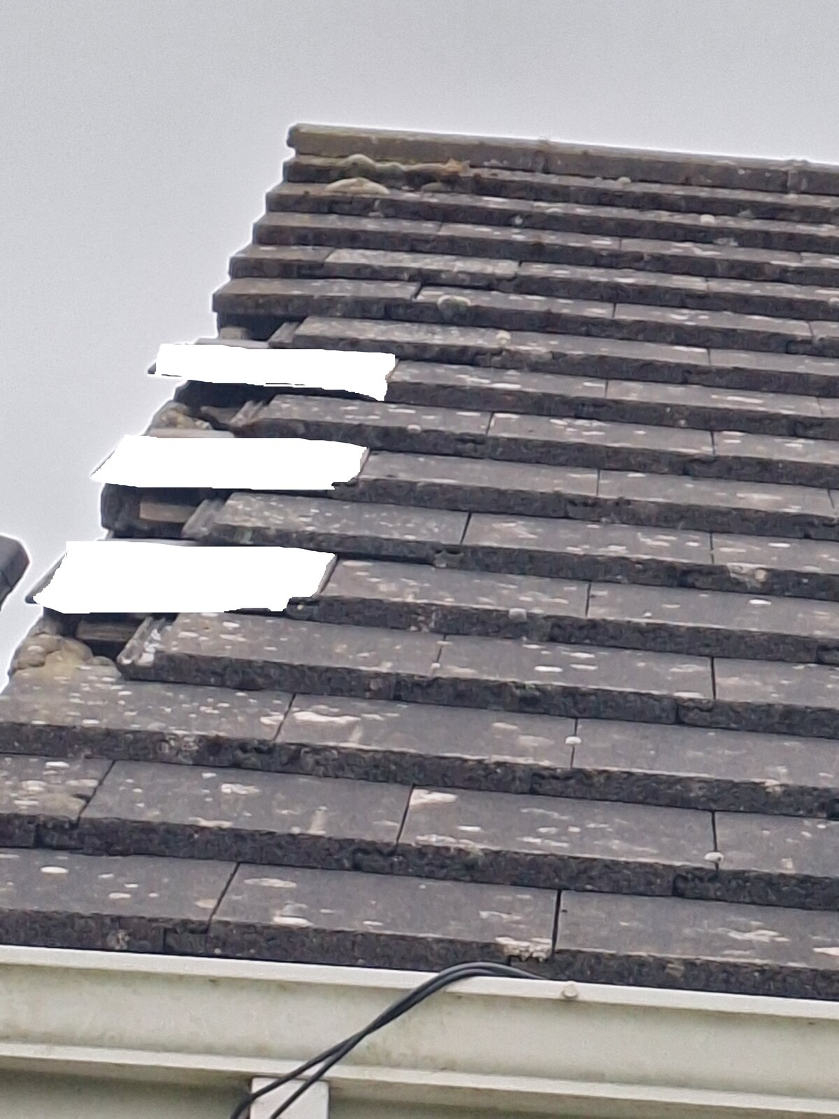

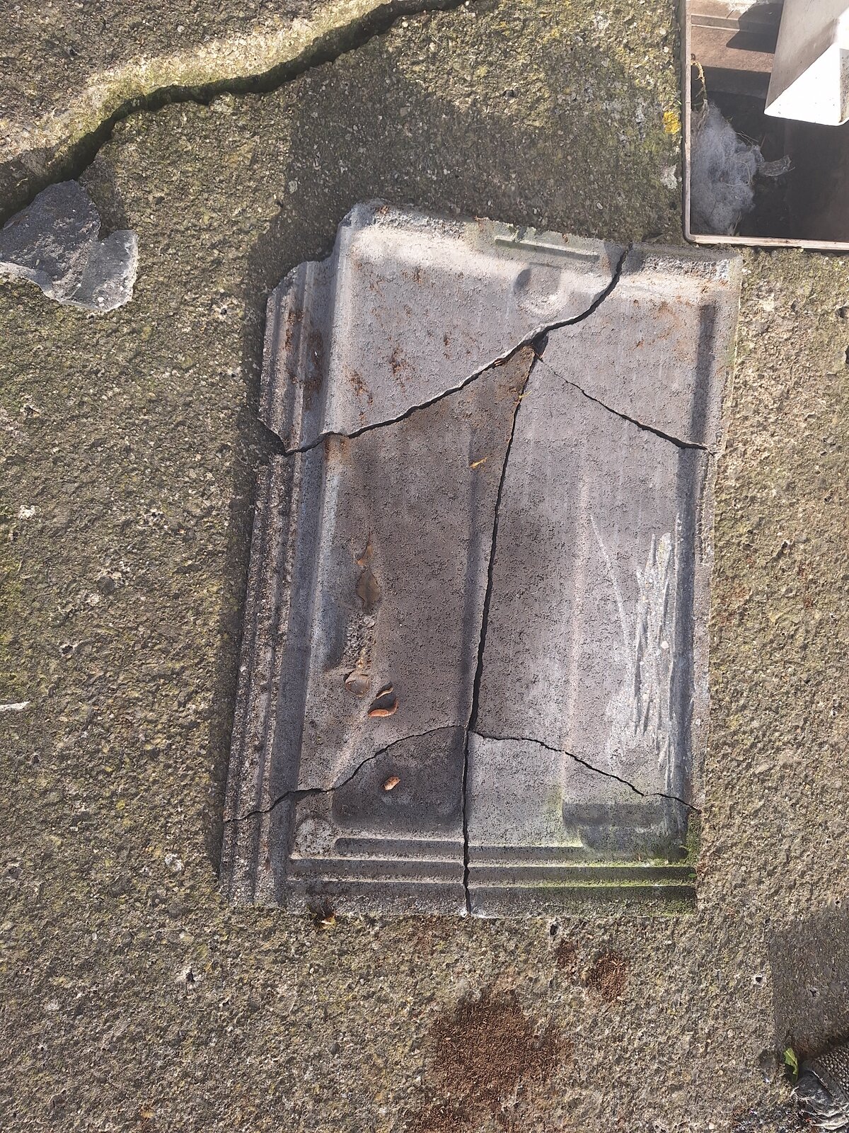

After the storm in tipp, we had a good few tiles fly off the roof. I am searching and cannot find this tile, it is from 1993. Anybody have any idea of a suitable replacement? Thank you.
Are you doing the work yourself? If not, just engage in a roofer to supply and fit.
Ok. If nobody here can help, see if you can remove a full tile and take to builders merchant or roofing supplies company.
I may need to do that
You need a good roofing merchant . Builder merchants likey won't know .
Post a picture top side of tile

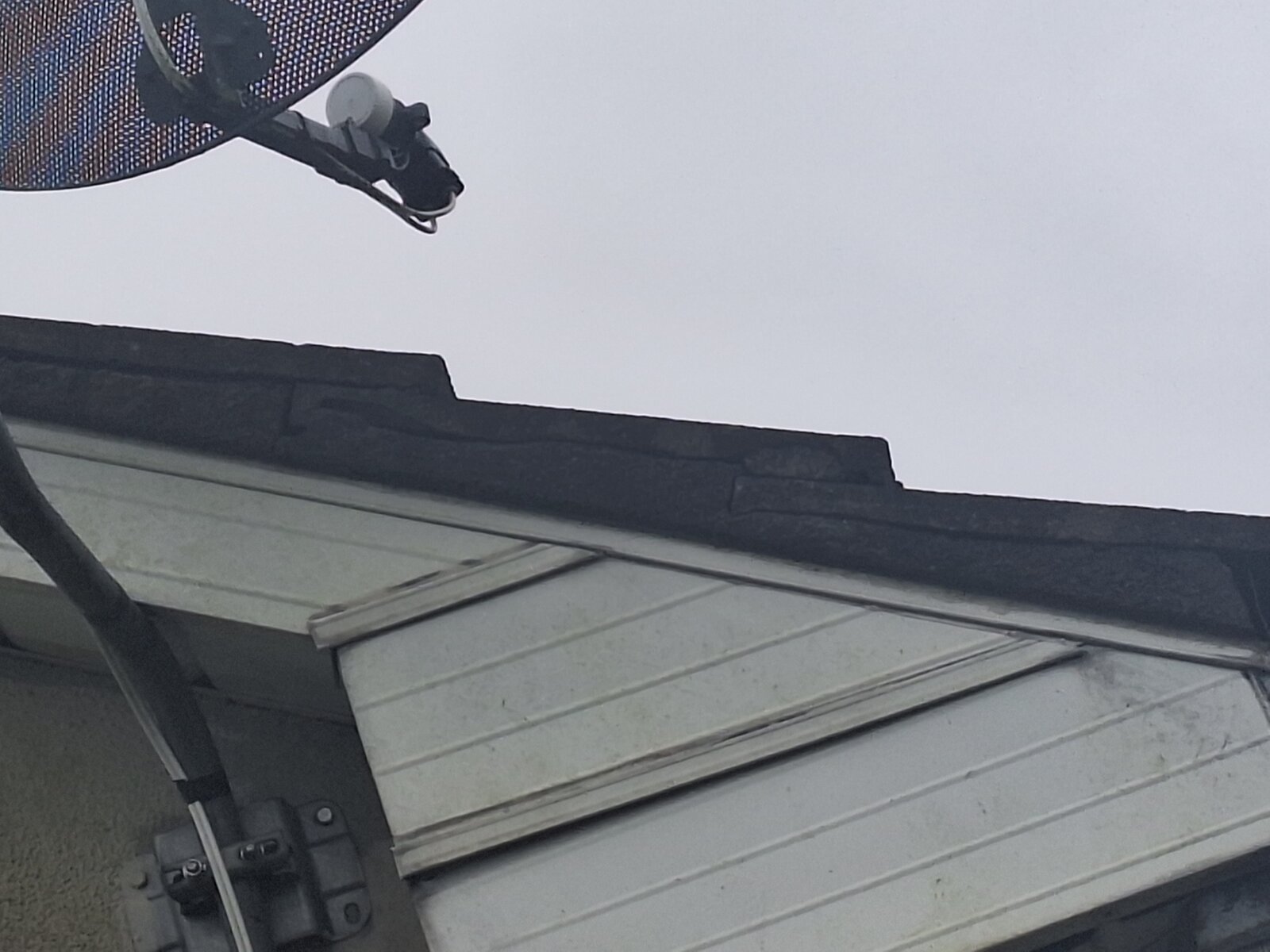

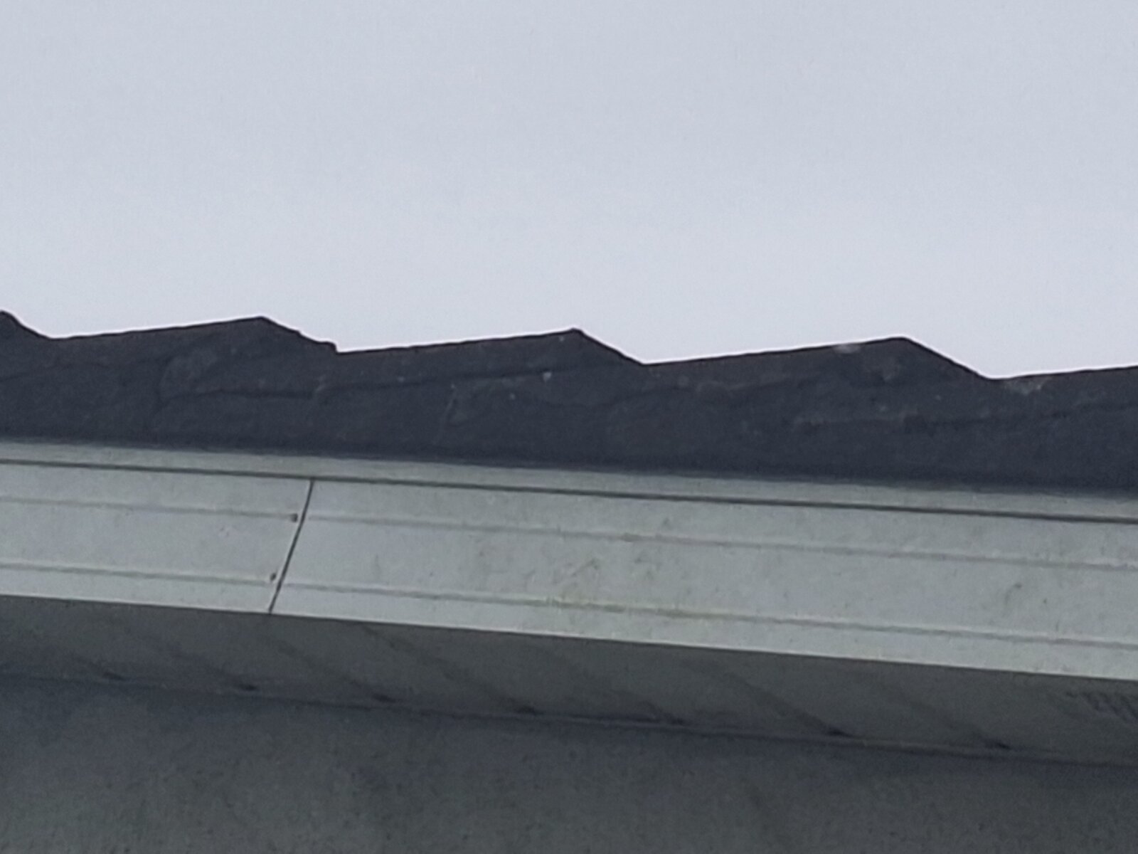

The main tiles use Condron CCW. But, See the images below. The tile that fell off, was a verge tile. But, even the side of it barely looks like the darker color and random shapes of what's on the back of the roof. I got replacement condron ccw tiles but the ones on the back of the roof are way thicker. For the sides, It is almost as if they originally cut the thick tile at the side and used mortar or concrete to fill the gaps? i've no idea where you could possibly get this sort of tile otherwise. May need to start ringing.

Condron, Burton roofing deal with condron . However , looking at the new images I reckon a Marley modern or Redland mini stone wold might work
You are correct the tile in your first image had been cut ..
The ridge looks like a Redlands uni angle ridge

How ever , pretty sure the mini will work
