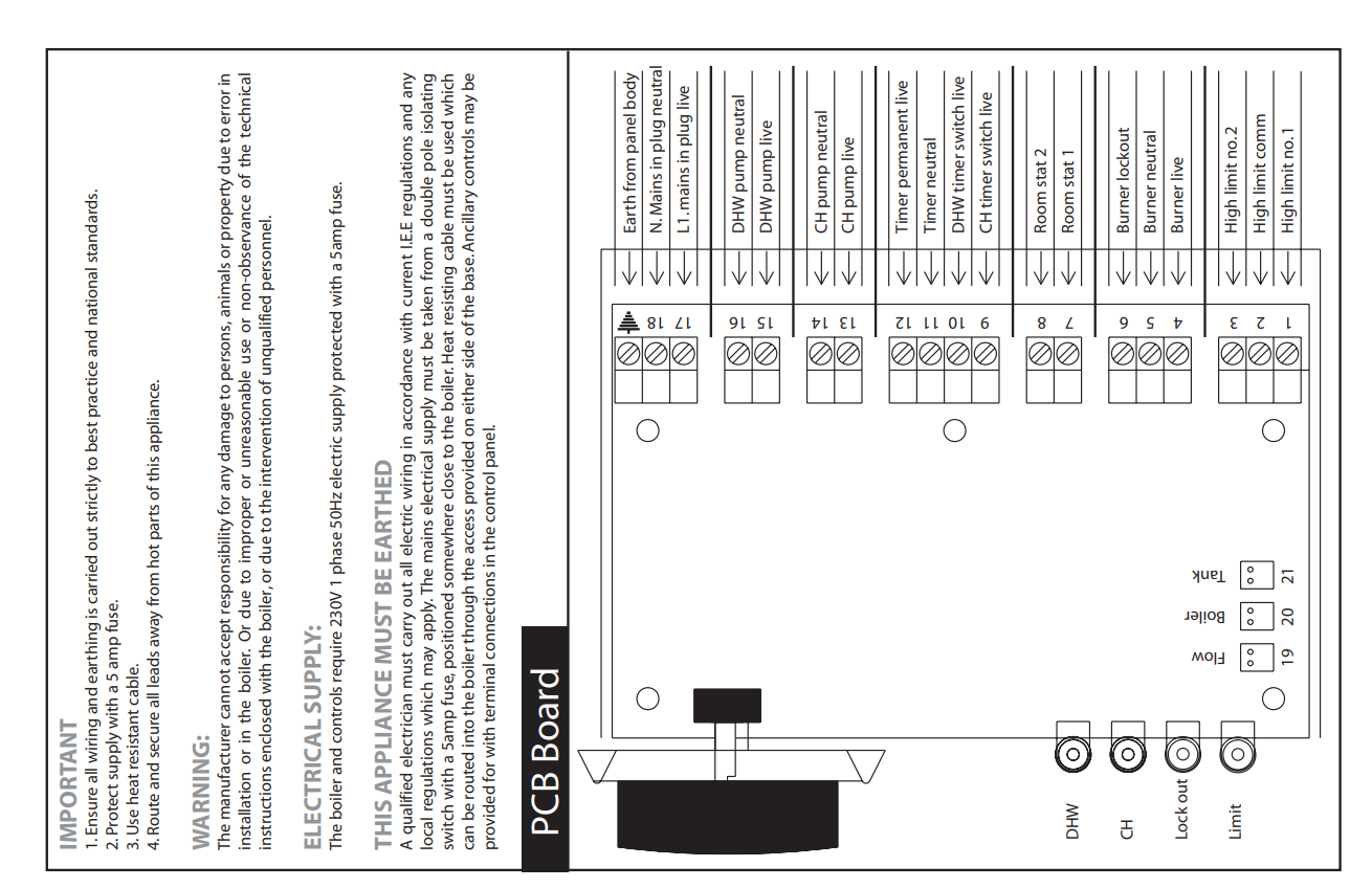

Can anyone please help me track down this part?
The pressure sensor appears to be wired through the high limit stat. Have you checked it?
Seems you are 100% correct. Any idea why they would have it wired like that? I definitely came like that

I've tried it a few times, I don't think I can bypass the boilers checks. It's a fairly modern oil boiler so it's runs on the same concept as a gas combi, where pcb board would check sensors before firing. I can't think how to bypass it if unwiring the sensor doesn't work

You did actually put a link in when wireing out the pressure switch?
My god are they really that bad? Not even servicing them? Yes still under warranty. Where exactly should the link be?
Remove wires coming from pressure switch replace with a short link of wire .

Thanks for all your help lads, back up and running with a link and I'll keep and eye on the pressure. I found the part I needed online too, hopefully gets posted first thing Tuesday. Happy New Year folks 10/10
