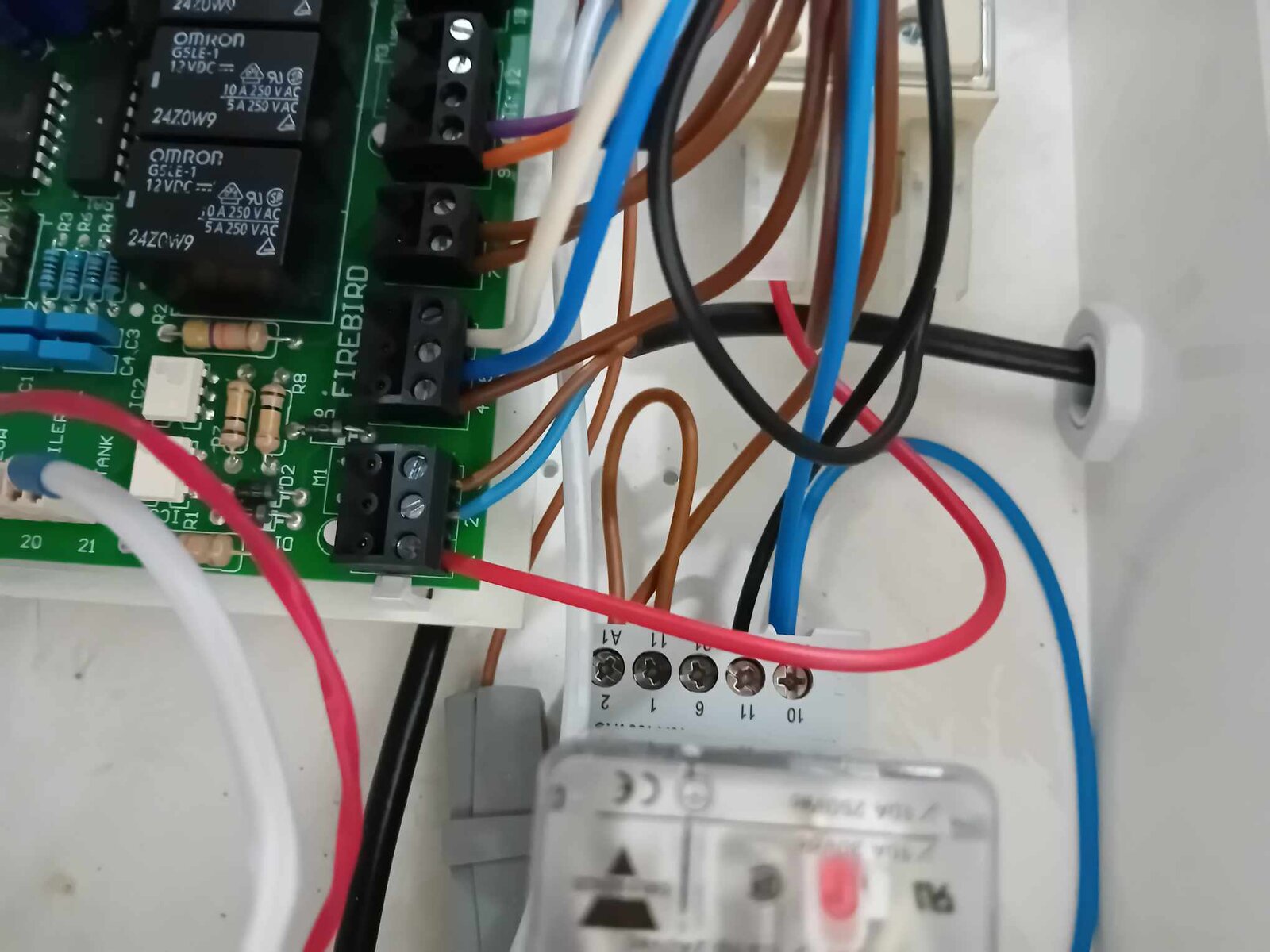

I have a "Firebird Envirogreen Condensing Combi Oil Boiler 26kW" a part has went and I can't find it anywhere, I was at every plumbers merchant near me but they all need to ring Firebird who are closed till next week. I wonder if anyone can help me find this part please? It's a pressure sensor 32700046, it also says on the label 20/21, 4600700020000.
Basically there's been a leak since the boiler was installed but it was really hard to pick up, pressure kept dropping since last year when it was installed, I was told it has to be a leak in the system somewhere, but it could not be found. I noticed lots of rust discolouring directly under this part and when I nudged it I could clearly see it was loose, the whole plastic part has been threaded. I can't find it anywhere online

how would you make a manual connection? If I put a short m12 bolt in there and plugged it, how would I get the sensor connected?
Trace that sensor cable back to the controls wiring center and link it out. Make sure you have isolated the supply to your boiler first.

It's just a plug out on the sensor end, would be the same thing? Is the sensor needed tho, I wouldn't want to damage other parts. Sorry I only have very basic knowledge of this stuff but getting heat over the weekend would be epic
As said by oilhead. Keep an eye on the pressure gauge. Top the pressure up if you need to and it will be ok.

The burner won't fire up, I tried it both ways, I unwired the sensor but the burner won't take the call for heat :( seems we're having a cold new year lol thanks for the assistance folks but unless a new sensor drops in my lap I don't think I can bypass it
Can you post a photo of what you are doing. Do you have a multimeter?
My multimeter is in work but I think could borrow a friends if it's really needed.
The black sleeved wire on the right is the sensor, I took the wires out and fired the boiler up, all lights came on, hot water green, call for heat green and filled 1 bar. But the burner just didn't start. It's only a year old so in my mind it's acting like it needs that sensor as opposed to being broken

The pressure sensor appears to be wired through the high limit stat. Have you checked it?
I'm assuming that's how it's supposed to be wired? Not had a problem with it all year besides the leak and constant pressure drops. The red high stat light is off, it would be red wouldn't it?
