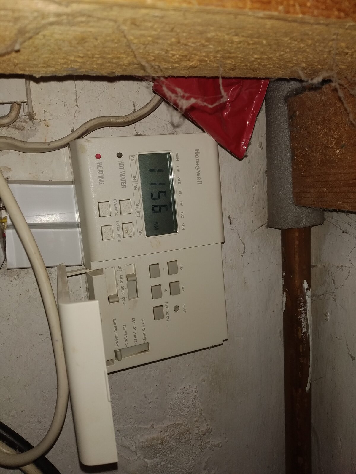

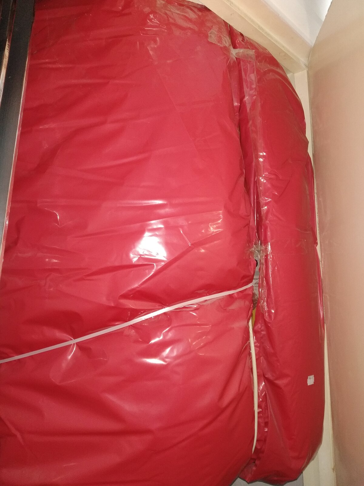

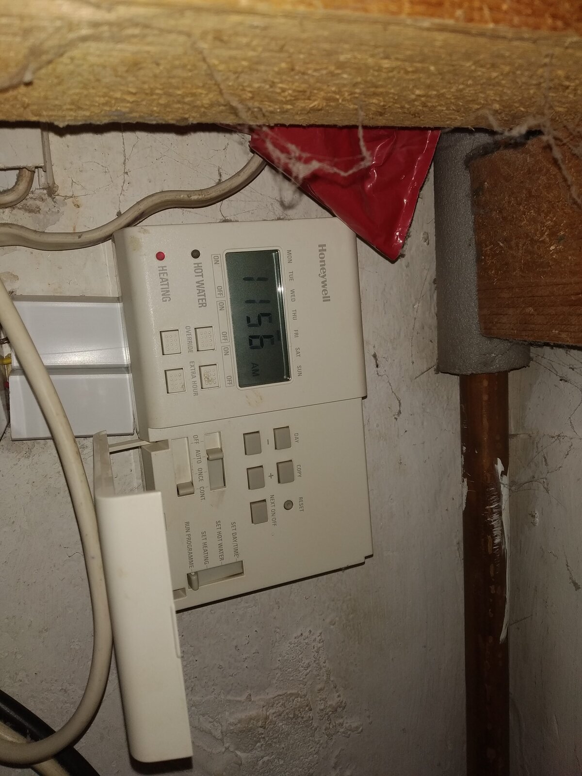

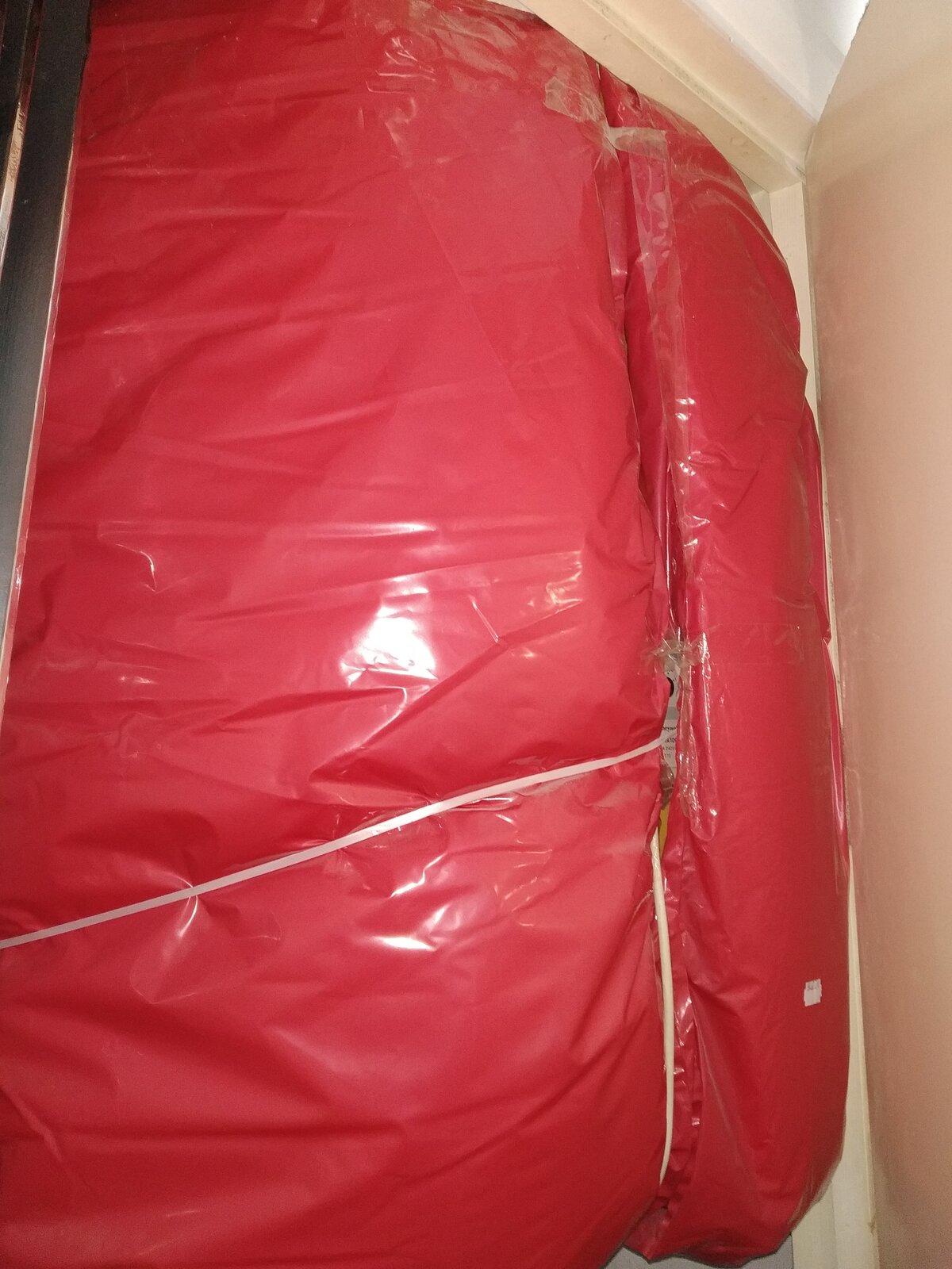

Please show us a photo of the programmer that controls your HW times.
Pics of programmer and hot water cylinder attached (it is yellow, underneath, and about three foot in height).
It is really difficult to put my finger on what the issue is - there must be a pattern as to when the water is hot enough and when it is not but we just cannot figure it out.

A yellow cylinder is quite old, maybe 30 years.
The insulation is not up to modern standards, but yours has a red jacket as well, so reasonable.
The other difference is that the heat exchanger coil inside is smaller, so it takes longer to heat up. A modern boiler can heat a modern cylinder in about half an hour, yours, I don't know. Maybe an hour?
A 36" high cylinder is often 24" diameter and holds about 100 litres, which is about a bathful. A sink or two can use up enough that it will be short of a bath.

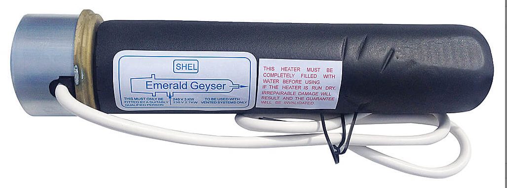

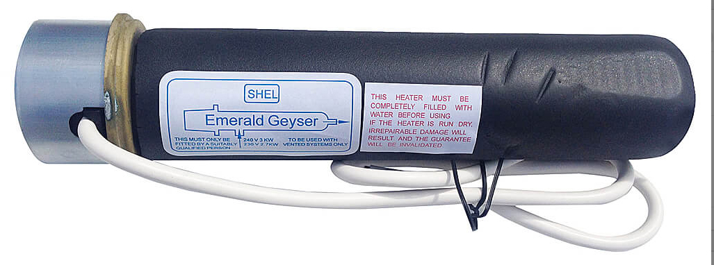

Do you have anything like this, Willis-immersion.jpg the Willis system does work on time, but that is the odd one out, nearly every other system uses a thermostat at a set level on the tank and it heats up water until the thermostat is triggered.
With my central heating boiler I have no tank thermostat, it works on the C Plan and to stop the boiler cycling all day in the summer, we set a run time, so switches on three times a week for ½ hour at a time, well actually after 20 minutes the return water temperature normally turns off the boiler. And with less insulation than you have, water stays hot when not used for more than 2 days.

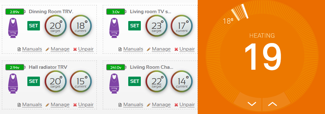

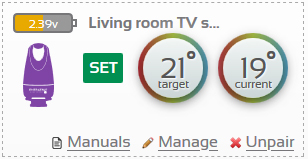

I have a thermostat in every room, built into the radiators, called a TRV (thermostatic radiator valve) some are blue tooth (5) and some are connected to internet (4) and the latter gives me a report
so if the target is above current with any TRV I want the central heating to run, I have a wall thermostat but no link between the two thermostat types, so it needs carefully setting the TRV and wall thermostat so boiler is turned on when required.
EvoHome seems to allow you to adjust the TRV's from a central point,

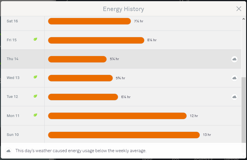

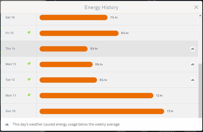

but all the others seem to be a bit of a Heath Robinson set up. Yes I can look at my PC Heating not keeping up.jpg and it shows the 4 TRV's and the wall thermostat, but they don't talk to each other. And the charts Energy History Nest.jpg are really a waste of space, it shows when the wall thermostat was allowing the boiler to run, not when the boiler was running, and depending on how many TRV's are open the boiler will be cycling on/off over that time, so not a clue how much oil I am using.
