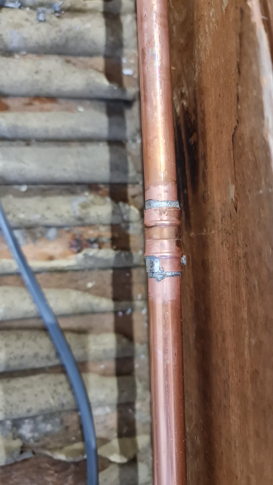

I know the obvious answer is yes you can but if done sensibly are the foolproof.
I don't intend to start the plumbing work myself and will be getting a pro in but needed to run 2 rad pipes under a floor in a room that is to be finished before the plumbing begins. This required 2 straight joints. Wet with yorkshire fittings as I only had 2 to do and thought 20 quid on a roll of solder for2 joints was a bit strong.
They r not the pretiest things but the solder appeared all the way round. Do these look like they have been done OK?
Haven't tried water through them just capped each end and leaving to the plumber to do the rest.
I will mark the floorboard they sit under and check them when connected.
Yeah they look like they've taken. If you clean the flux before you heat them and don't get it too hot, then it should just pool at the threshold and doesn't draw up over the fitting and pipe (y)
So wipe the flux wit a rag after the fitting is pushed together before I apply heat. Did I understand that correctly?
The trick is to use just enough flux to start with,then I just use my finger and run it round then a quick wipe.
Nothing wrong with yorkies, not as flush as end feed but they are great for the DIY'er.
