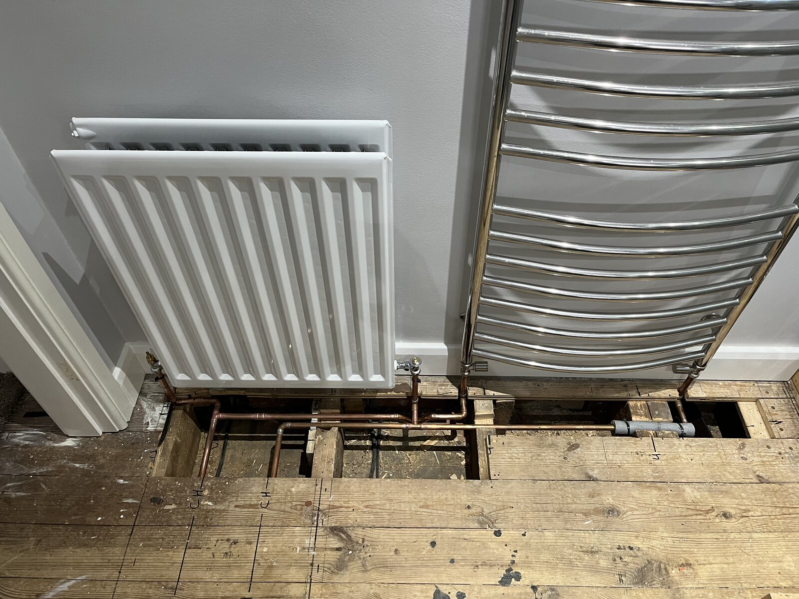

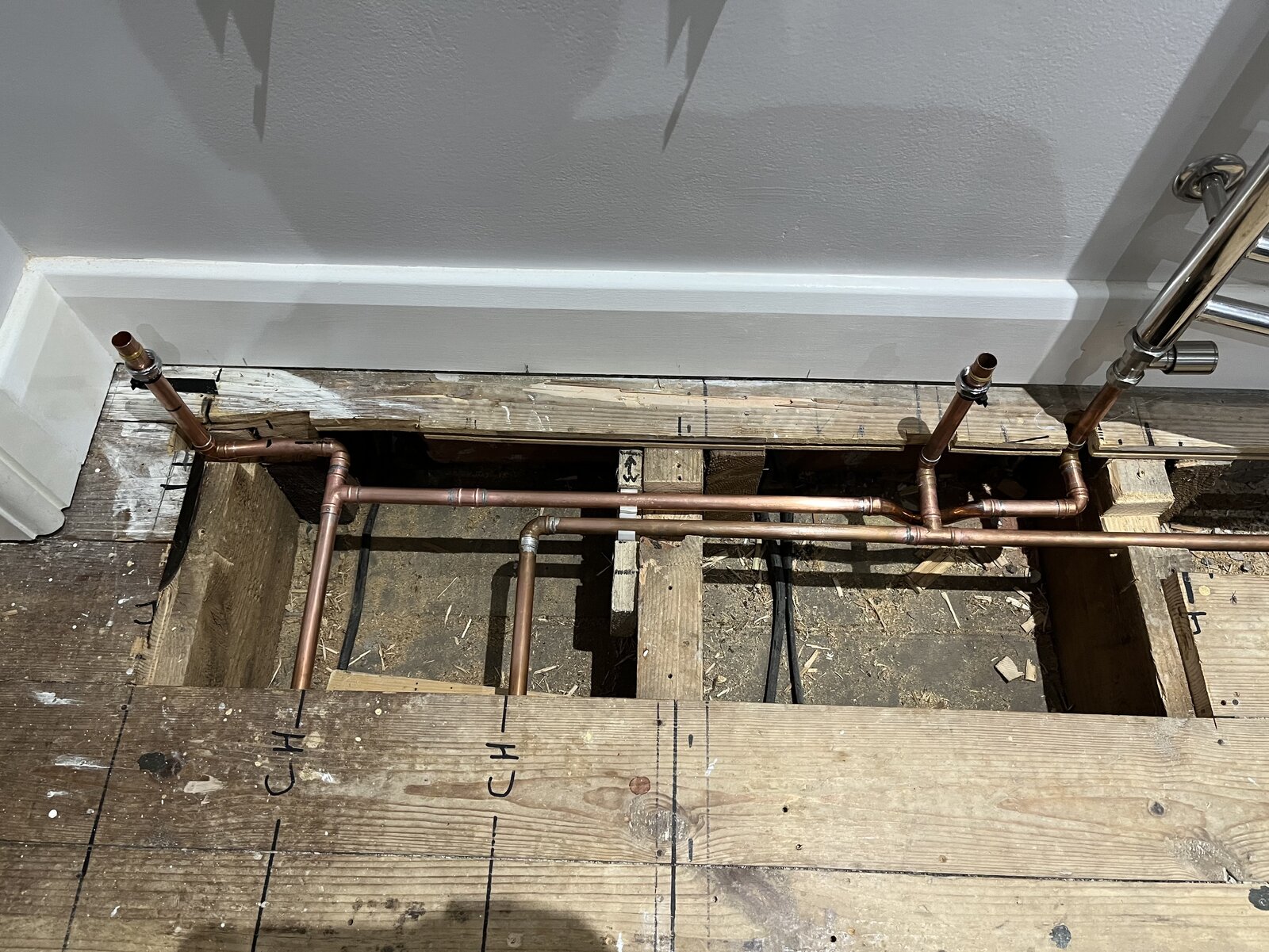

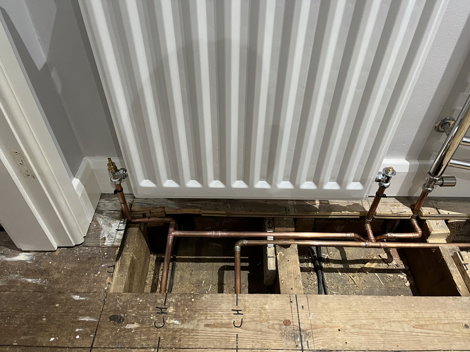

Well, I finally got round to my little plumbing job using Yorkshire fittings….adding a panel radiator to the bathroom :(
Although I was soooo tempted, I resisted the urge to add a little bit more solder to the Yorkshire fittings, and guess what….no leaks (y):p
Just for complete disclosure, there were a couple of joints I added a bit of extra solder, they just didn’t look right and I didn’t want to risk it :giggle:
Thanks very much for the advice everyone. I don’t know how you do this every day, I hate plumbing with copper, so stressful for a DIY’er :cry:
