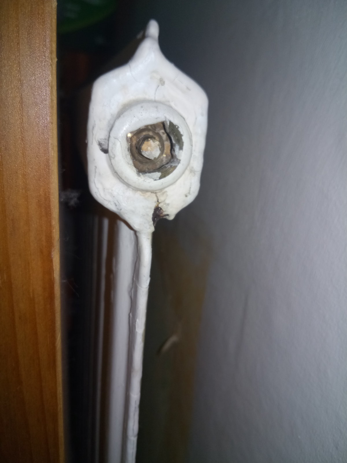

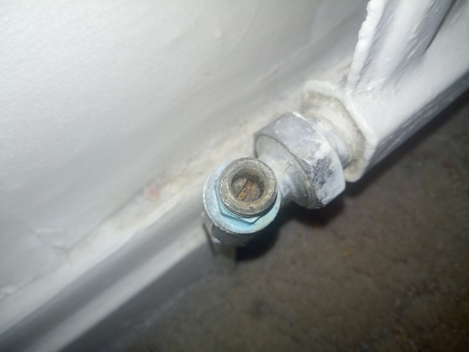

Hi everyone, I can't bleed my radiator because its rounded off on the square bit. I've read some other threads where the fix was to replace the whole plug. Can this plug be replaced before I go and buy the parts? Couldnt say how old rad is, its been painted and I can see some rust.
I don't want to remove the plug to find I get myself in a worst situation because its so old. Am I safe to go for it with this old radiator?

Thanks Ian, would you put a new radiator within the realms of a diyer or time to call a plumber?
Not really a hard thing to do if you can get an exact width as the rad you already have, definately within the skills of a keen DIYr,
A rad key would remove that in 2 minutes.
Turn of both isolating valves then unscrew it. put new one in with some ptfe tape on it and it will be fine. What’s to lose?
if it doesn’t work you then buy a new radiator.

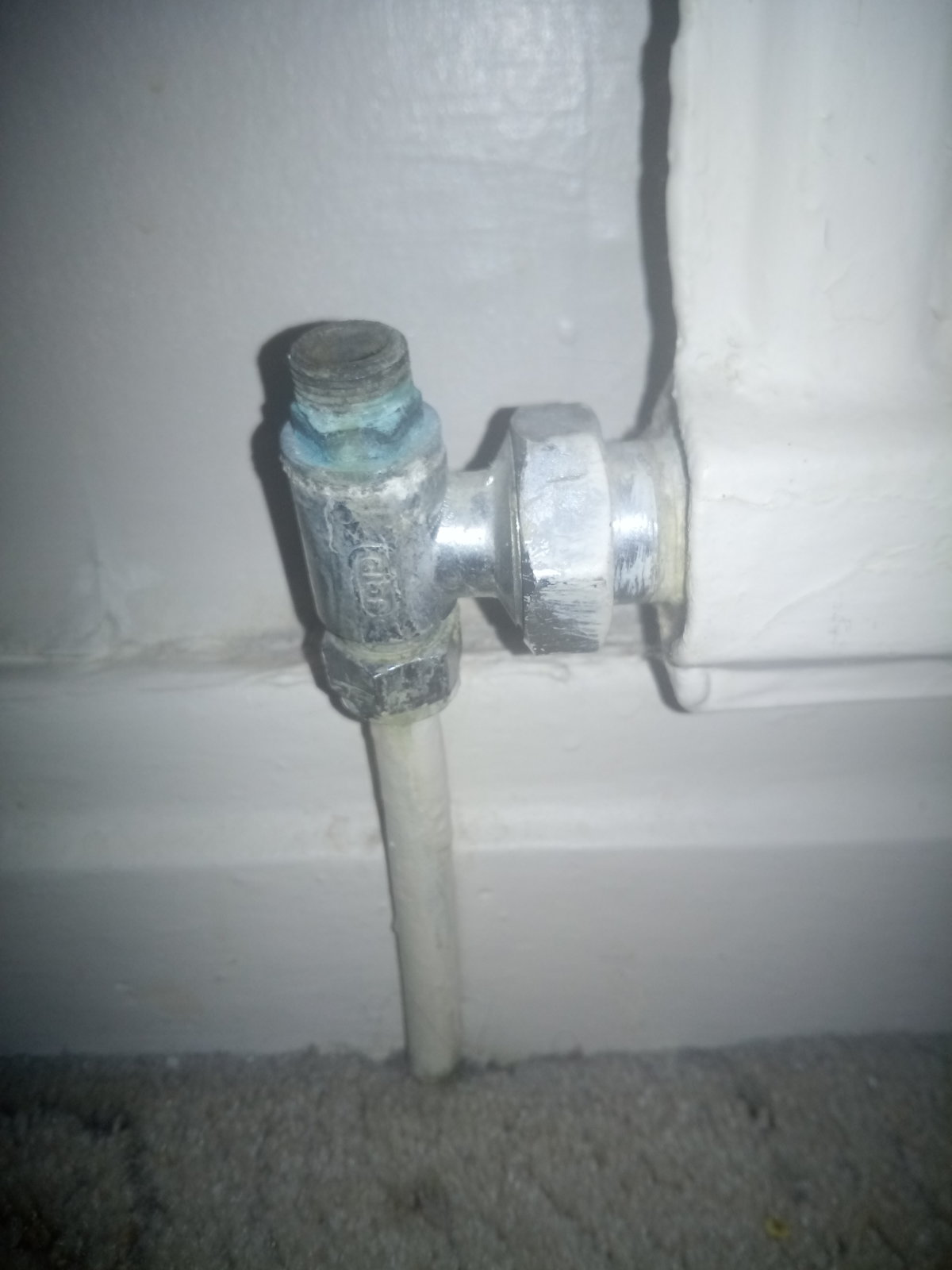

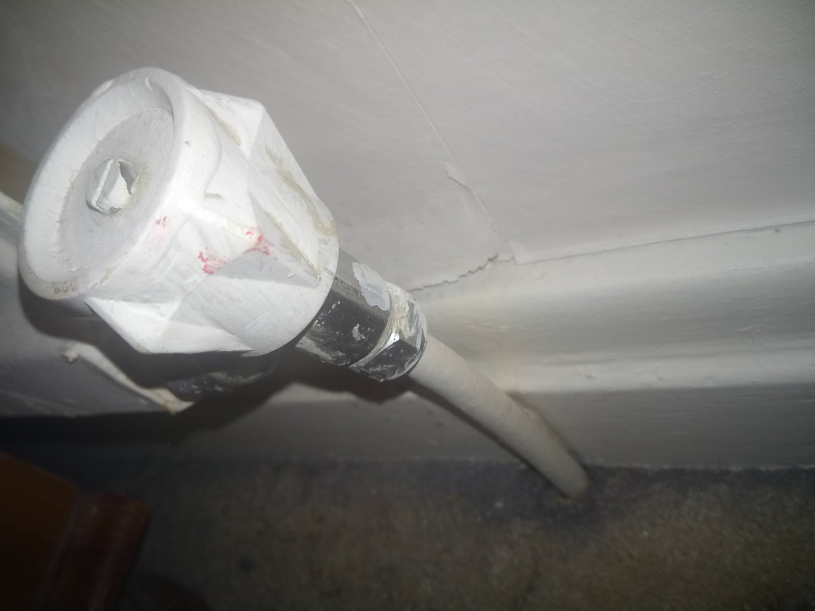

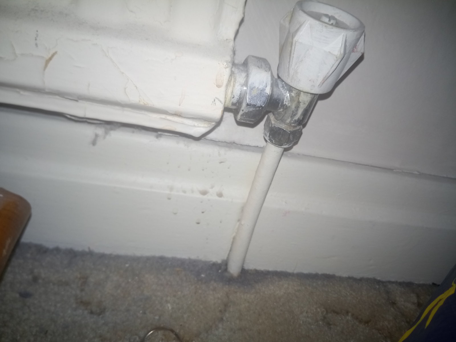

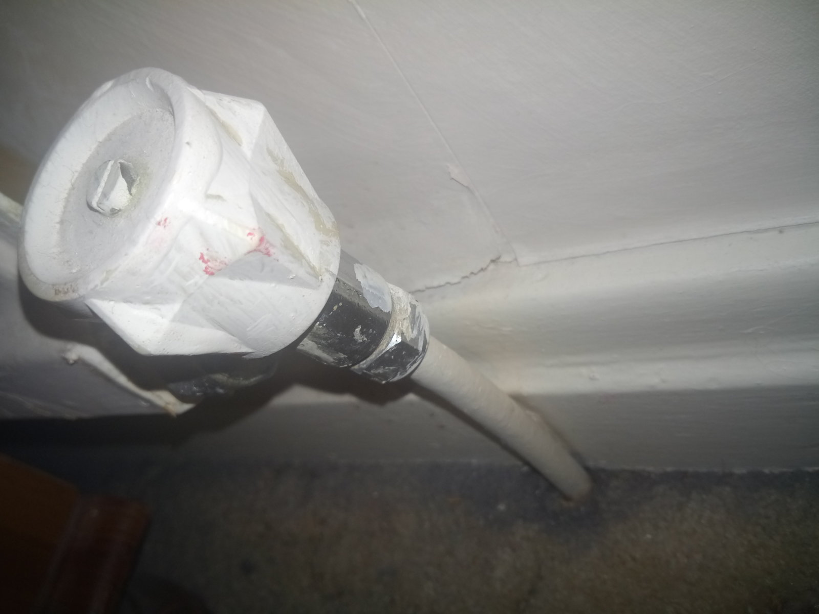

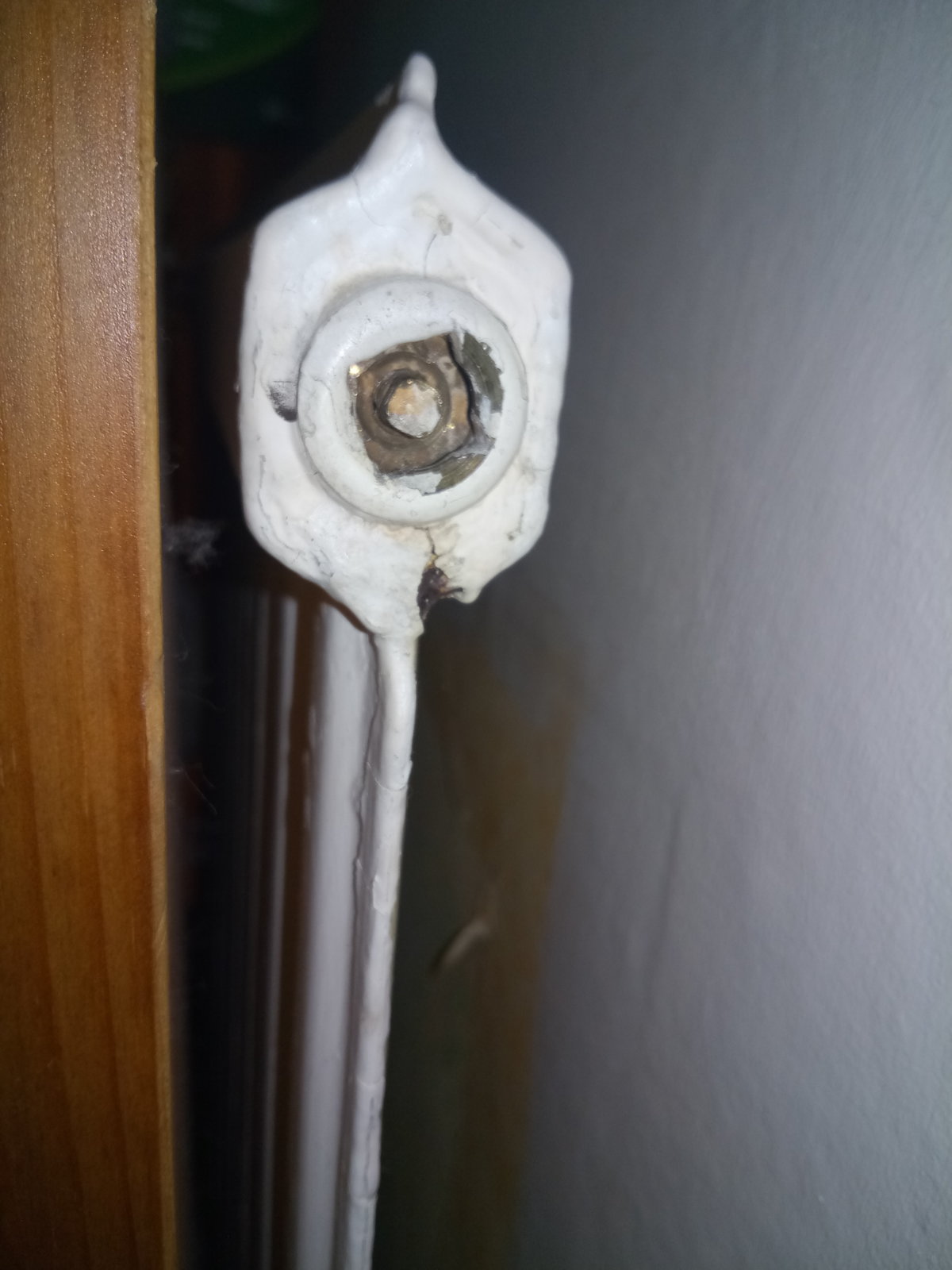

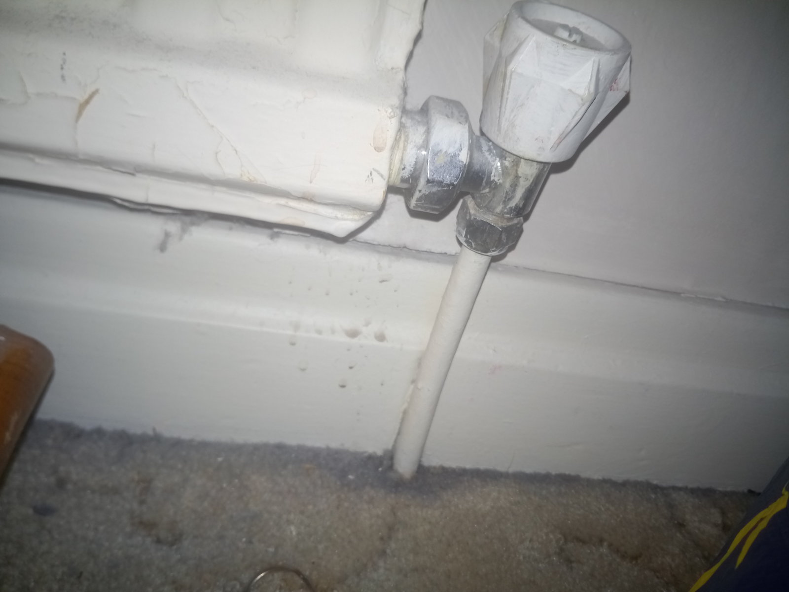

Having inspected the valves a bit closer it looks like one is seized (with the plastic on it) and the other just has a screw inside the cylinder. IS there any way of identifying which is the lockshield? If I bite the bullet I guess I should also put new valves, preferably TRVs on when replacing the radiator. I measured the rad and its 1440mmx600mm, all the sheds seem to sell 1400mm, how do you overcome this slight difference in length? Do you need a couple of really short lengths of pipe? Just wondering if I should pick any additional tools or parts up to cover all bases.

Normally, the valve with the conventional head is the on/off, the other the lockshield. In practice, both may be fully open anyway. Mist, if nit all, TRV's are now bi-directional. Is that 10mm copper? If so you may need some jointing compound to lightly smear the olives. 10mm is much more likely to leak. Be careful to strongly support the valve while undoing the nut or you will end up damaging the pipe.
Thanks fireman, I'll have a look at the extenders. Yes its 10mm copper with some added paint. I'll add jointing compound and extenders to the list.
Supporting the pipe is holding it level with the pliers whilst unscrewing the nuts right?
