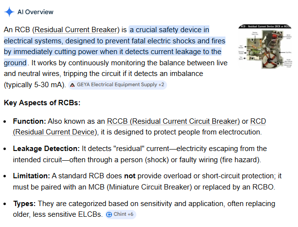

Firstly, what exactly do you mean by "RCB"? that's not a commonly used acronym! To comply with current standards, your socket circuit needs both overcurrent protection and RCD protection.
* A "MCB" provides overcurrent protection.
* A "RCD" or "RCCB" provides RCD protection
* A "RCBO" provides both.
You need to understand what the devices you are looking at actually do and how they are connected. Post photos and ask if you are unsure.

I must admit that I had Assumed RCB to be a typo of MCB - yes I know I should Never Assume ! Sorry :oops:
I imagine that nearly all of us assumed likewise.
What else could it possibly be. I don't think anyone is going to find a 16A RCD, in a domestic CU or anywhere else.
