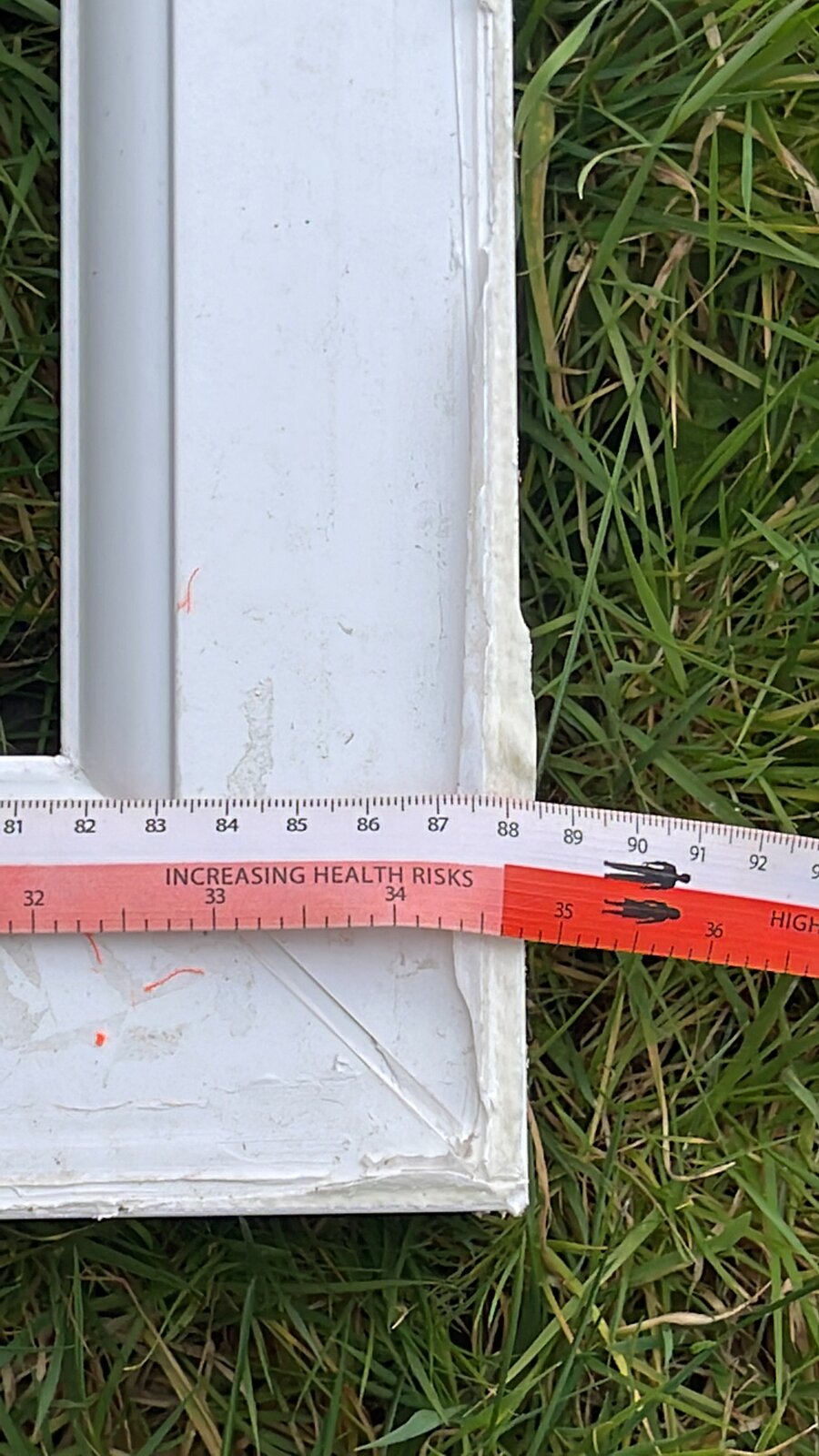

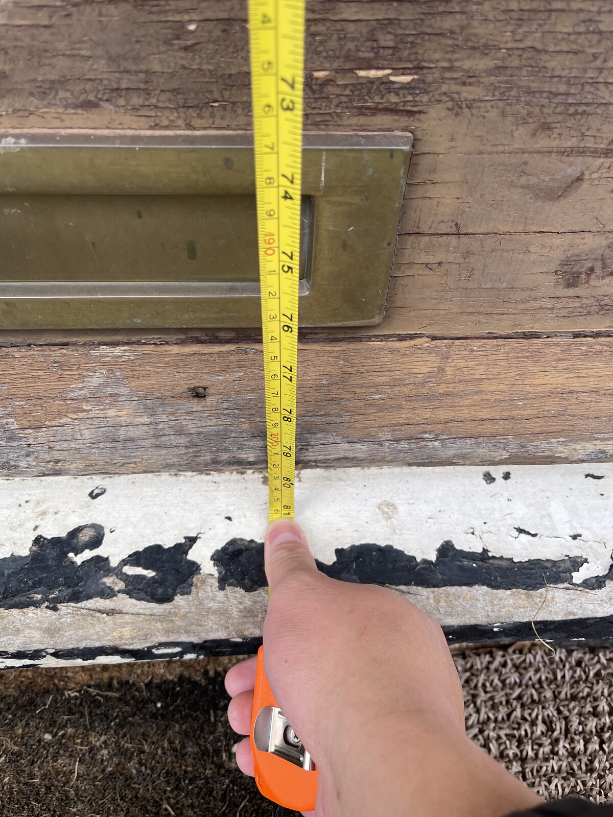

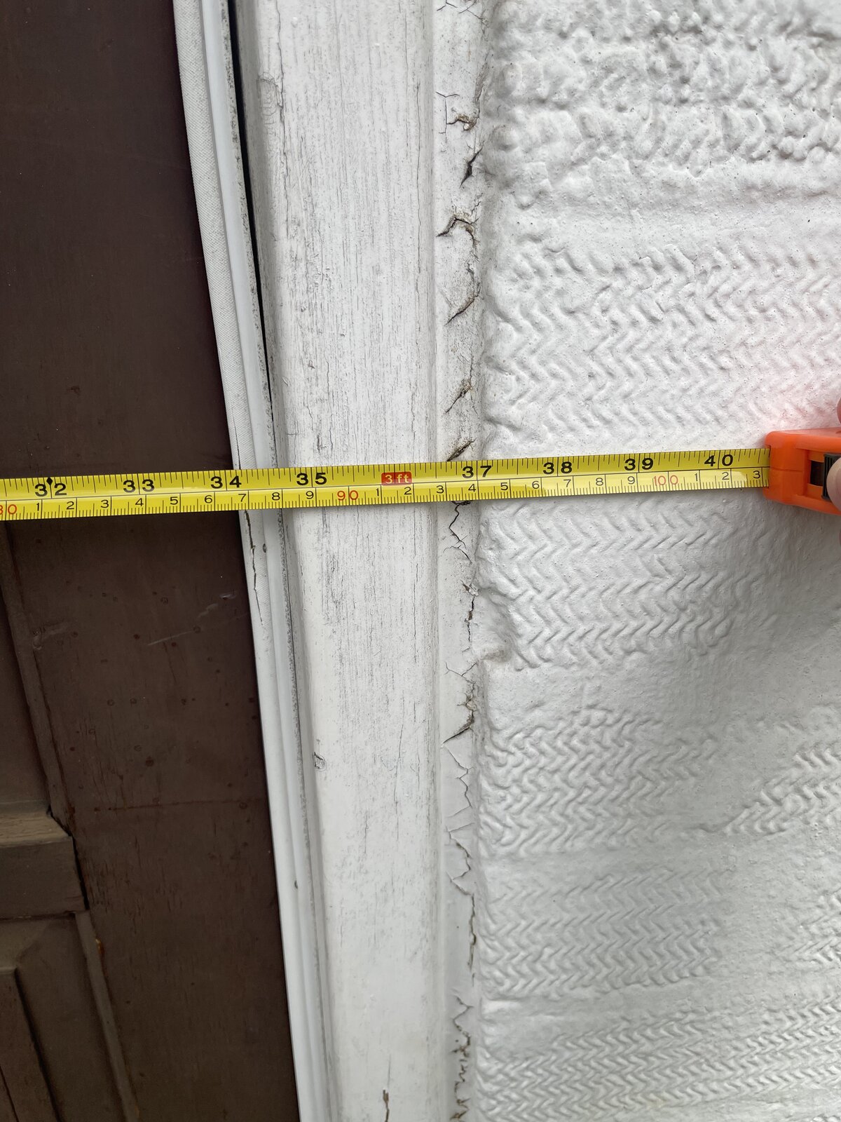

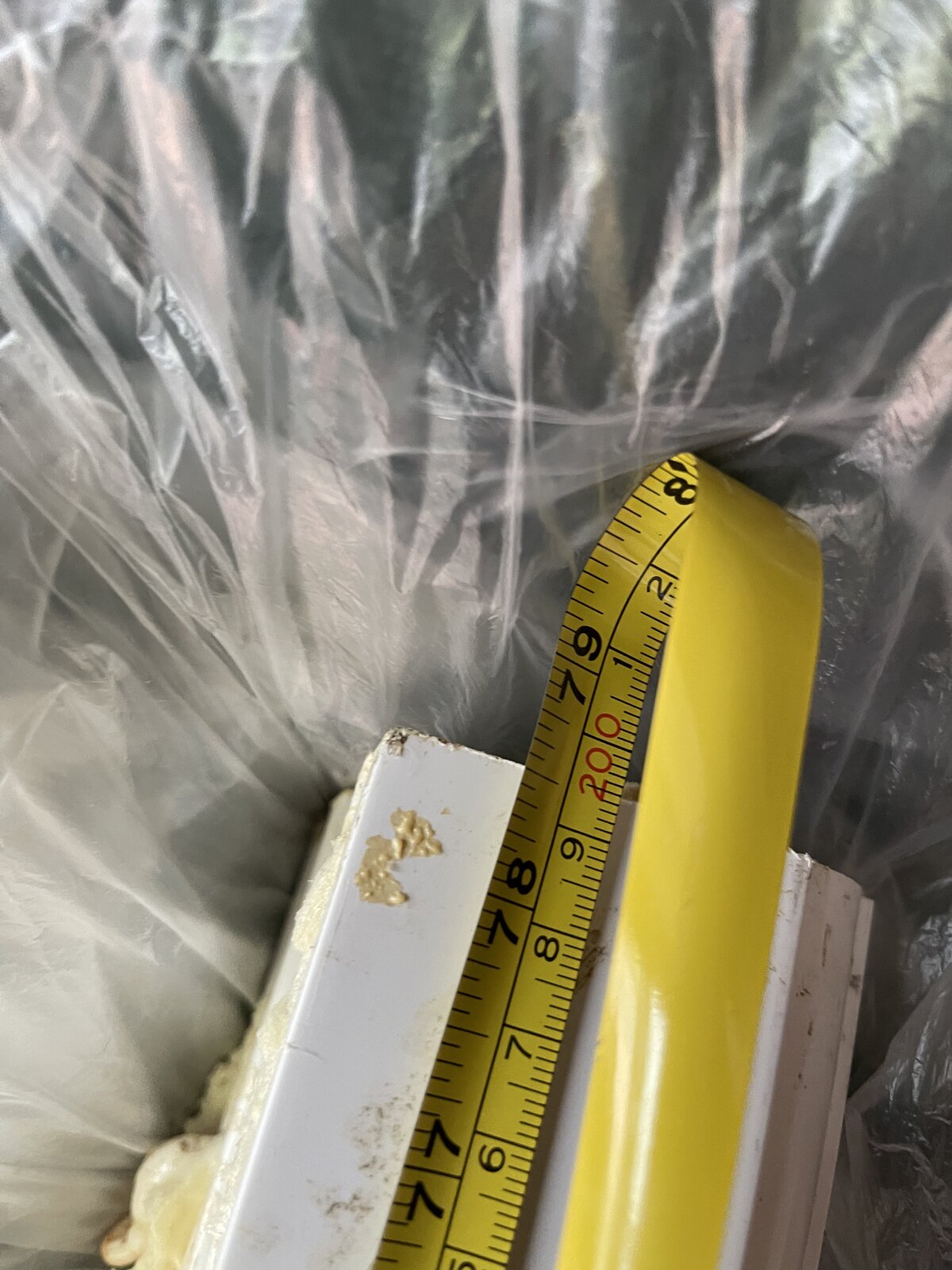

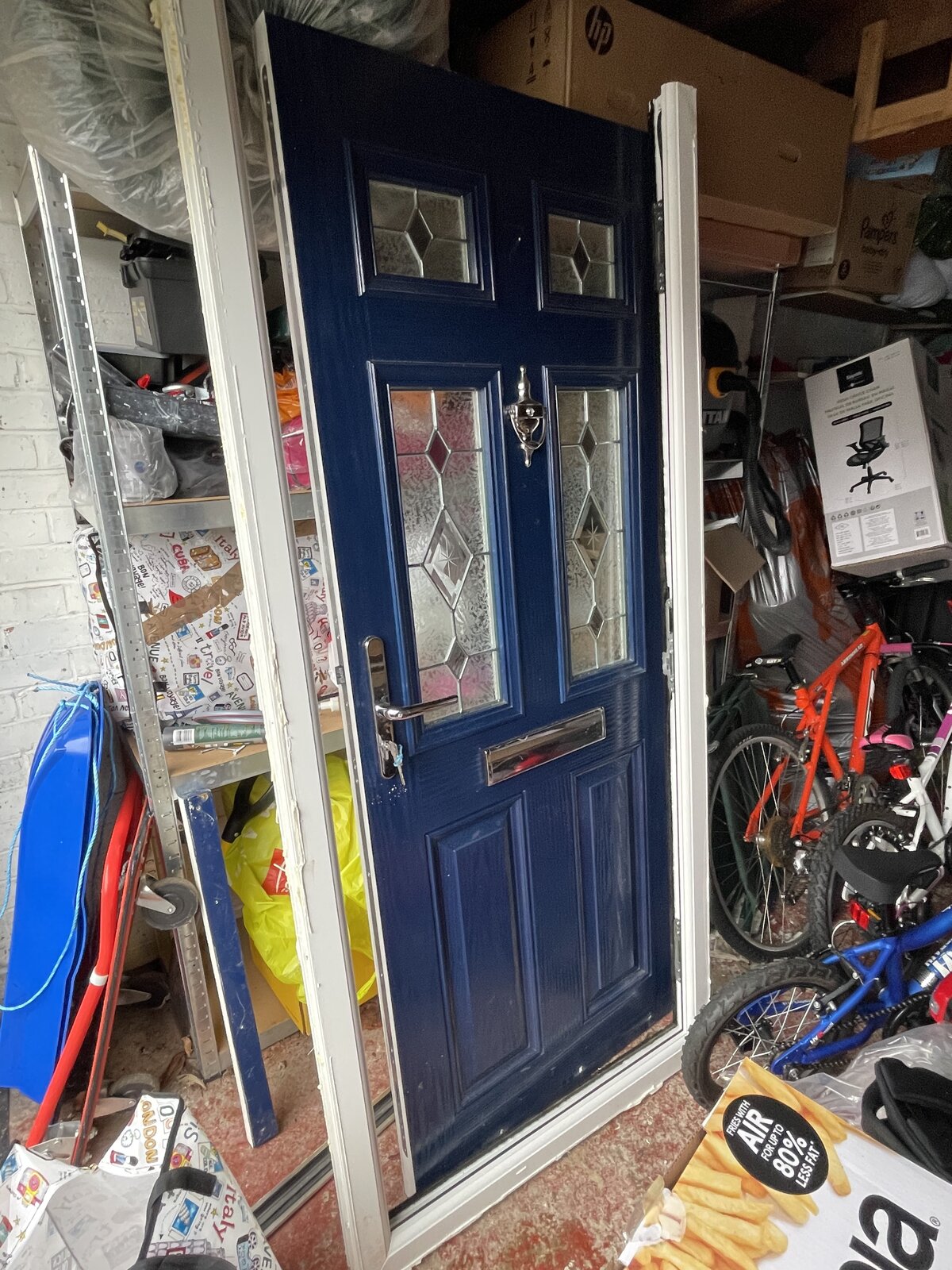

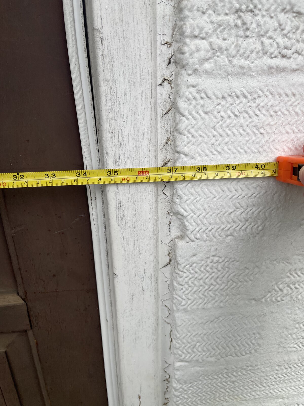

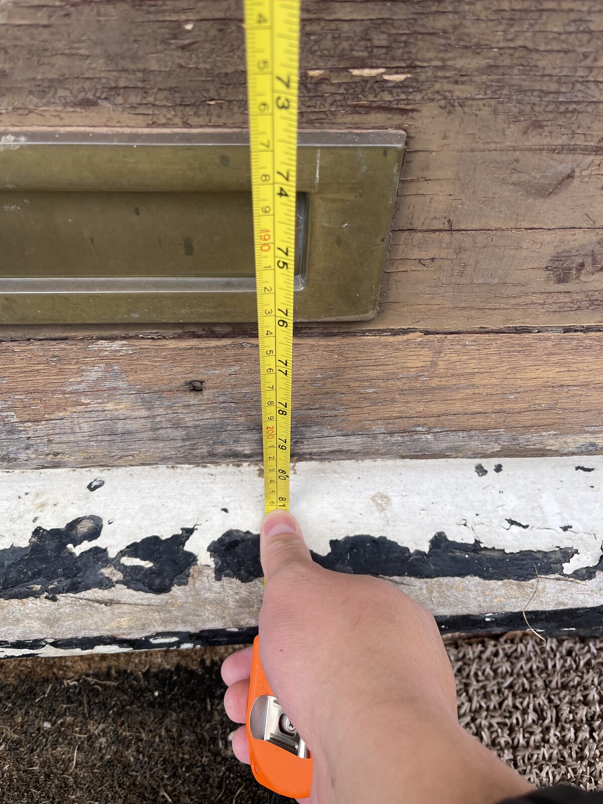

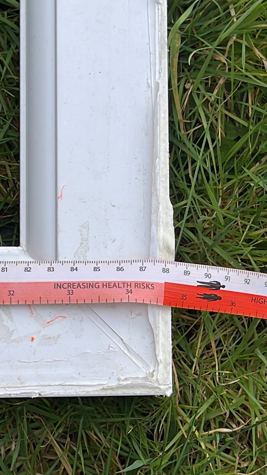

I have bought a second door and only found out they are underside by around 40mm on width and 60mm on height.
My question is that can I still fit it?
I got some pic for the measurement if that’s help

If youve bought a door with frame then you can mount the new frame inside the old frame if it's still in a reasonable enough condition to receive it, you have the tools necessary to cut it and you don't mind the look of the end result (can cover the transition with some plastic trim).
If you don't have the tools you might be looking at ripping the old frame out and adding packing to the sides and top of the new frame eg 15mm either side and 50mm on top to leave a smaller gap you can foam up.

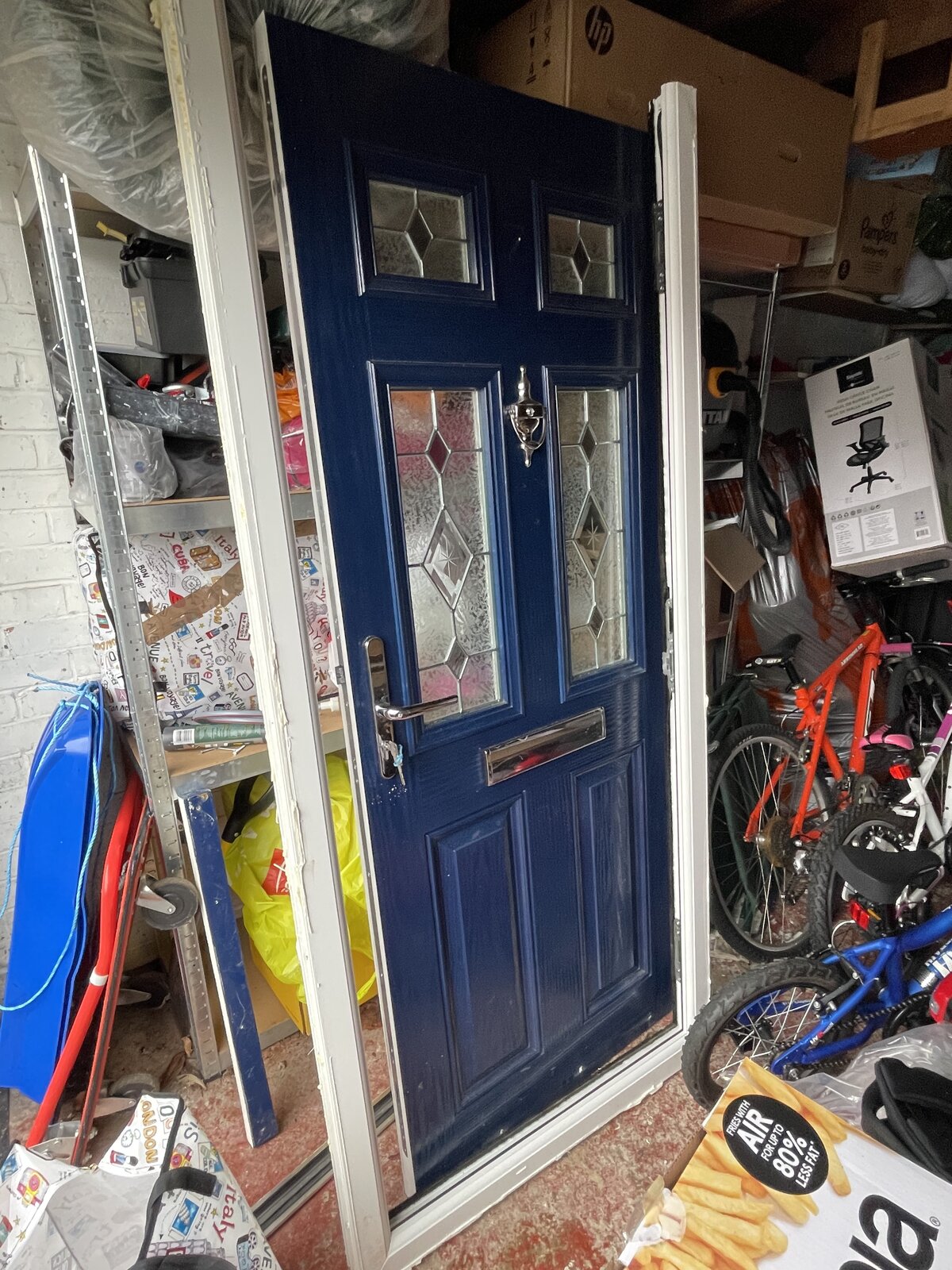

I'm kinda puzzled how the frame you have measured in picture 1 doesn't appear to have a bottom though..
The pic is not really clear but that shows the measurement.
Let me upload another pic of the whole frame.
The end bit it’s just a piece of thin metal with linked the frame together

I guess that's a level threshold frame, upside down in the picture. Go to a window supplier and get some "knock ons", you need to make up the gap less 5mm either side. As you don't know the profile of the frame you might have to cut off any nibs. Check whether you need a level threshold, if not it can sit on a standard or stub cill.
If you don't understand what I'm talking about get a new door and someone to fit it.
It looks as if your door frame has been cut down to size, from a door that used to have a top light.
Without the top bar on the frame, you will lose rigidity in the frame, and the composite door won't have a decent seal.
I'm afraid I would recommend getting a new door :(
It's the right way up - drain caps are at the bottom...
Edit - on looking again (more closely), it might not be a drain cap, and I am wrong! :oops:
It can be done, but you've bought yourself a challenge. If the new frame fits inside the old frame there is a reasonably easy path forward (albeit it mike look slightly odd with a very heavy double frame). If it doesn't, the old frame has to come out and the gap between brick and new frame made up. The way to fit this is to secure the hinge side of the frame securely and the keep side lightly at the top and not much at the bottom. Hang the door on the hinges and adjust the keep side of the frame so the door sits tight in the frame and the lock works smoothly, then secure everything up.
With a multipoint lock and a second hand door, if you secure all the frame tightly first then try and fit the door, the chances of the multipoint working cleanly are not high. (understatement).
