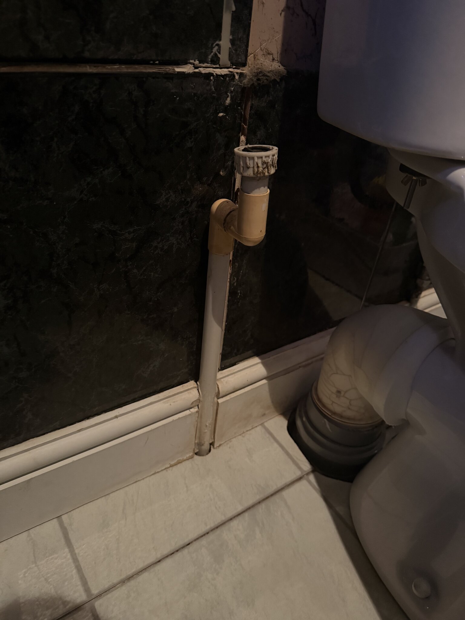

Yeah - if the plumber removed the toilet and disconnected that from the old cistern overflow then if he is a plumber and not just a 'have a go' then he really should know if it can be cut and sealed and should have done that as part of the job.
As suggested though, yes - cut it down, plug the end and seal it with a little silicone
