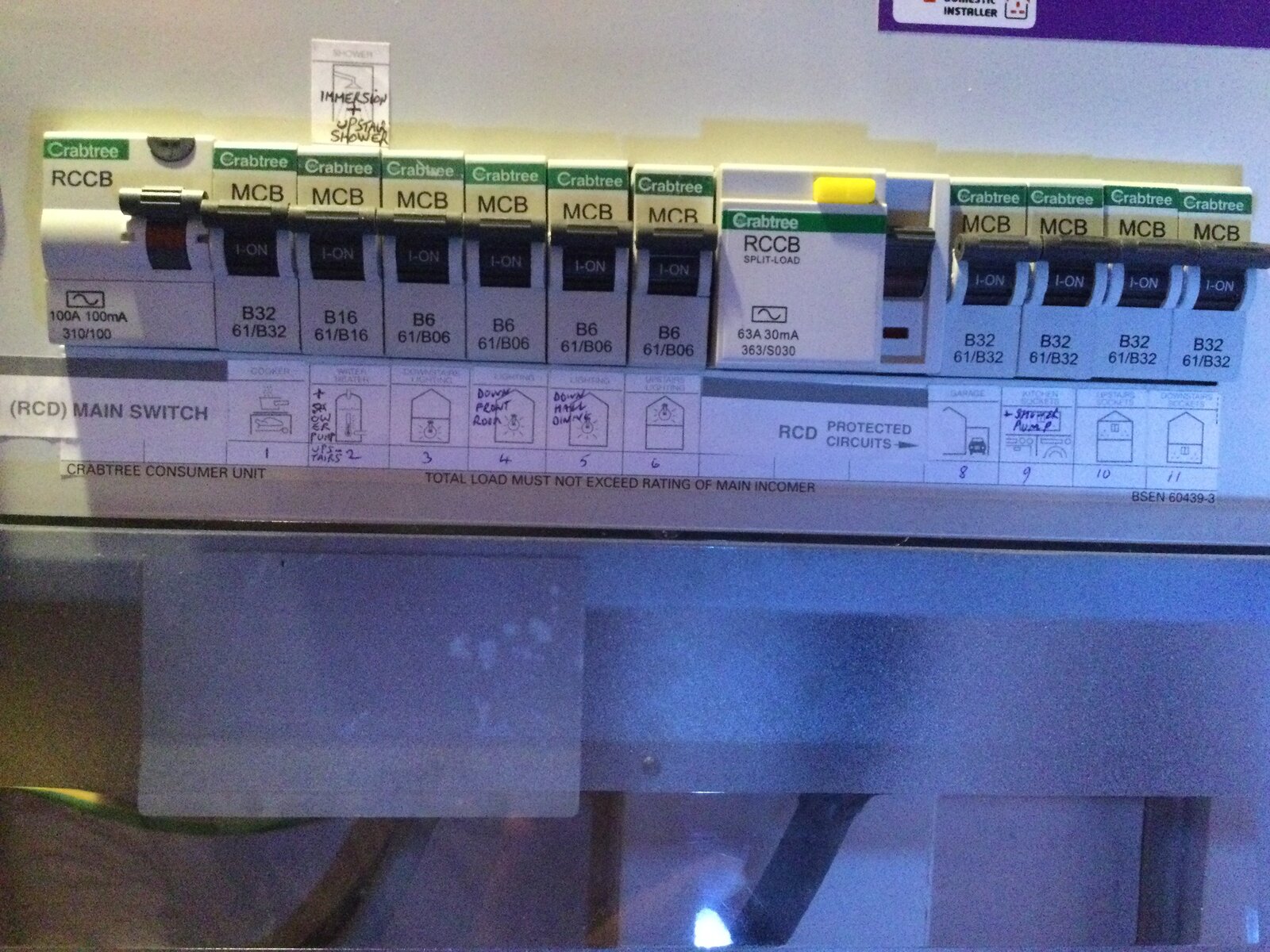

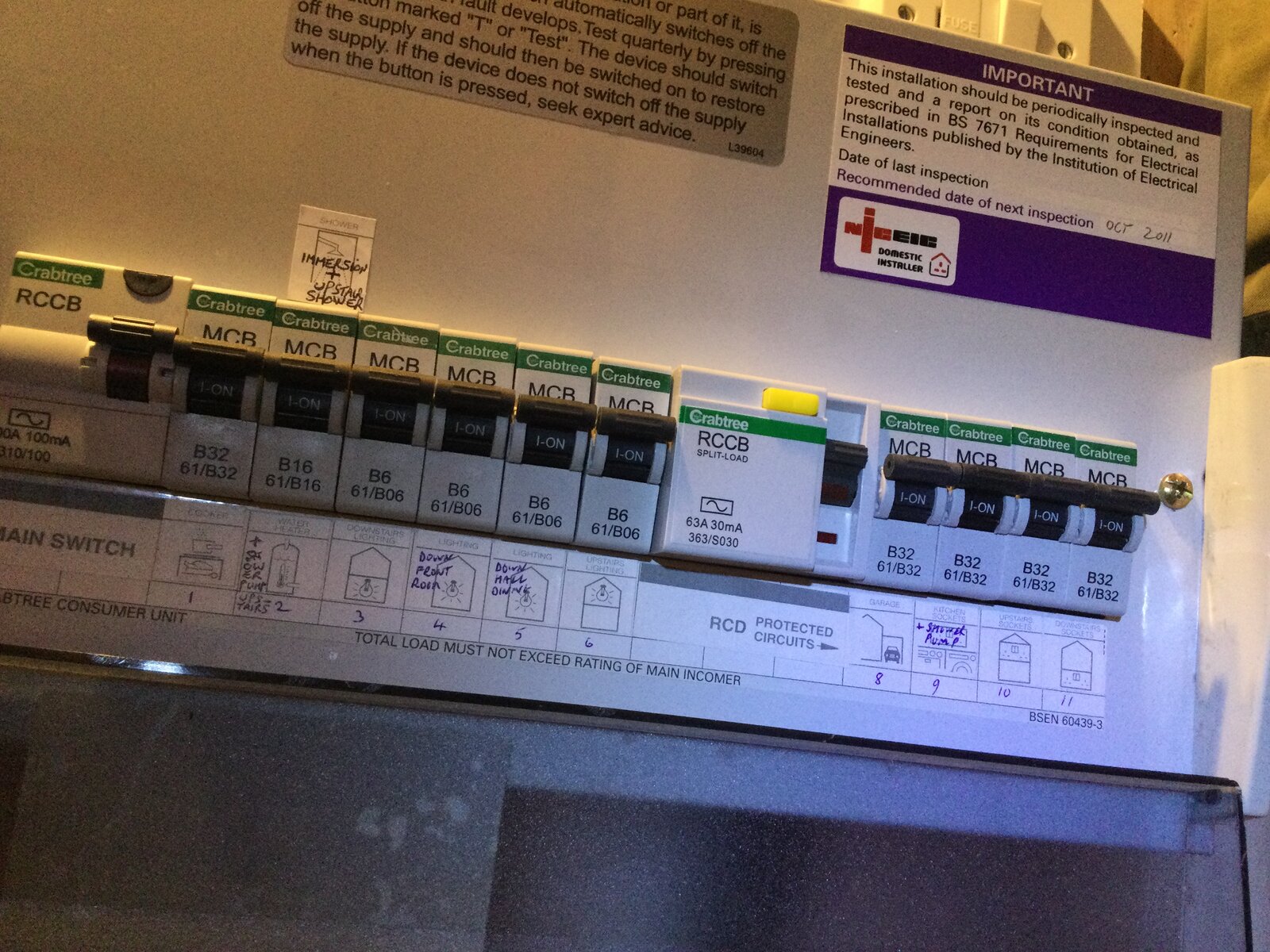

Normally I would say get an electrician to check, but you have already done that. So maybe start point is picture of consumer unit.
Hopefully photos attached. Thank you, sir.

If you had two (30mA) RCDs, the normal suggestion would be that you should try plugging the WM into a socket protected by the other one, to see if it still trips, but you appear to only have one.
