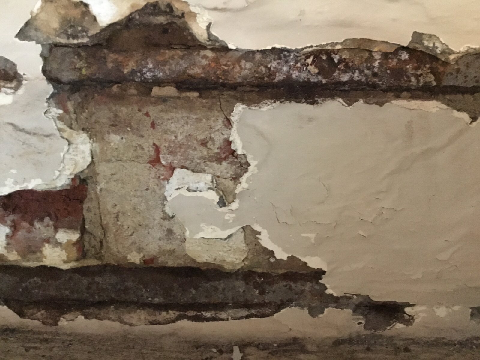

Dear Experts,
I have exposed the side of a steel lintel and I’m curious as to how old it is. (This is a 17th-century building, but substantially modified multiple times.)
It is 2450mm long x 178mm deep, and the flanges are 24mm thick. I can’t tell the width. To my inexperienced eye, the steel looks surprisingly thick. Did older steels have thicker flanges than more modern ones?
Or maybe it’s not even the edge of a beam that I’m looking at!

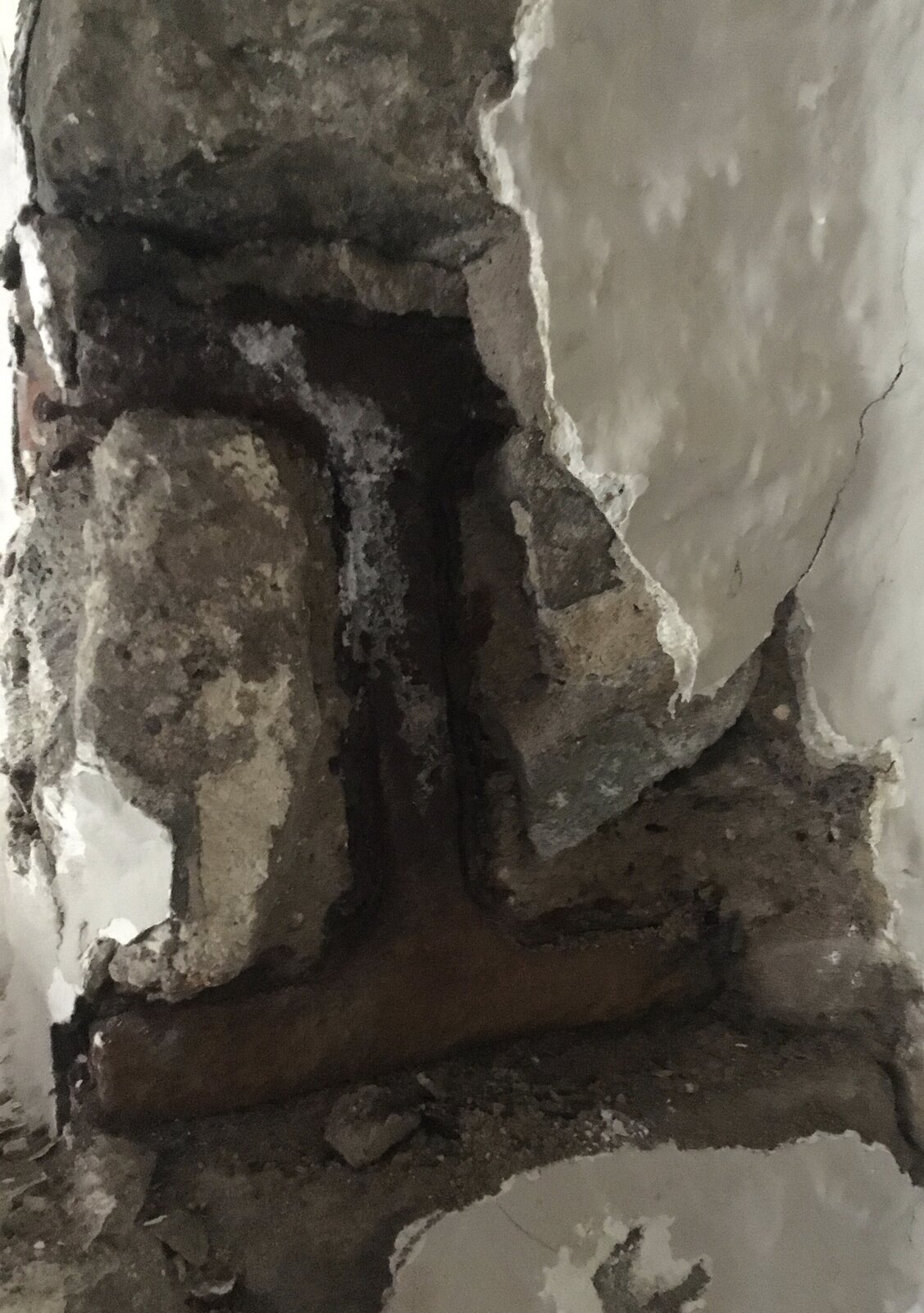

I’ve now exposed most of an end:
So I now know it is 2450mm long x 178mm deep x 155mm wide and the flanges are 24mm thick.
I can also see that the flanges are flat, not tapered (“w-section”, not “s-section”, apparently).
No modern universal beams have flanges anything like this thick until the depth and width are much larger. So, are non-standard beams with thick flanges often seen? Were they common in the past?
Would you guess this is circa 1980, or 1950, or 1900, or older?

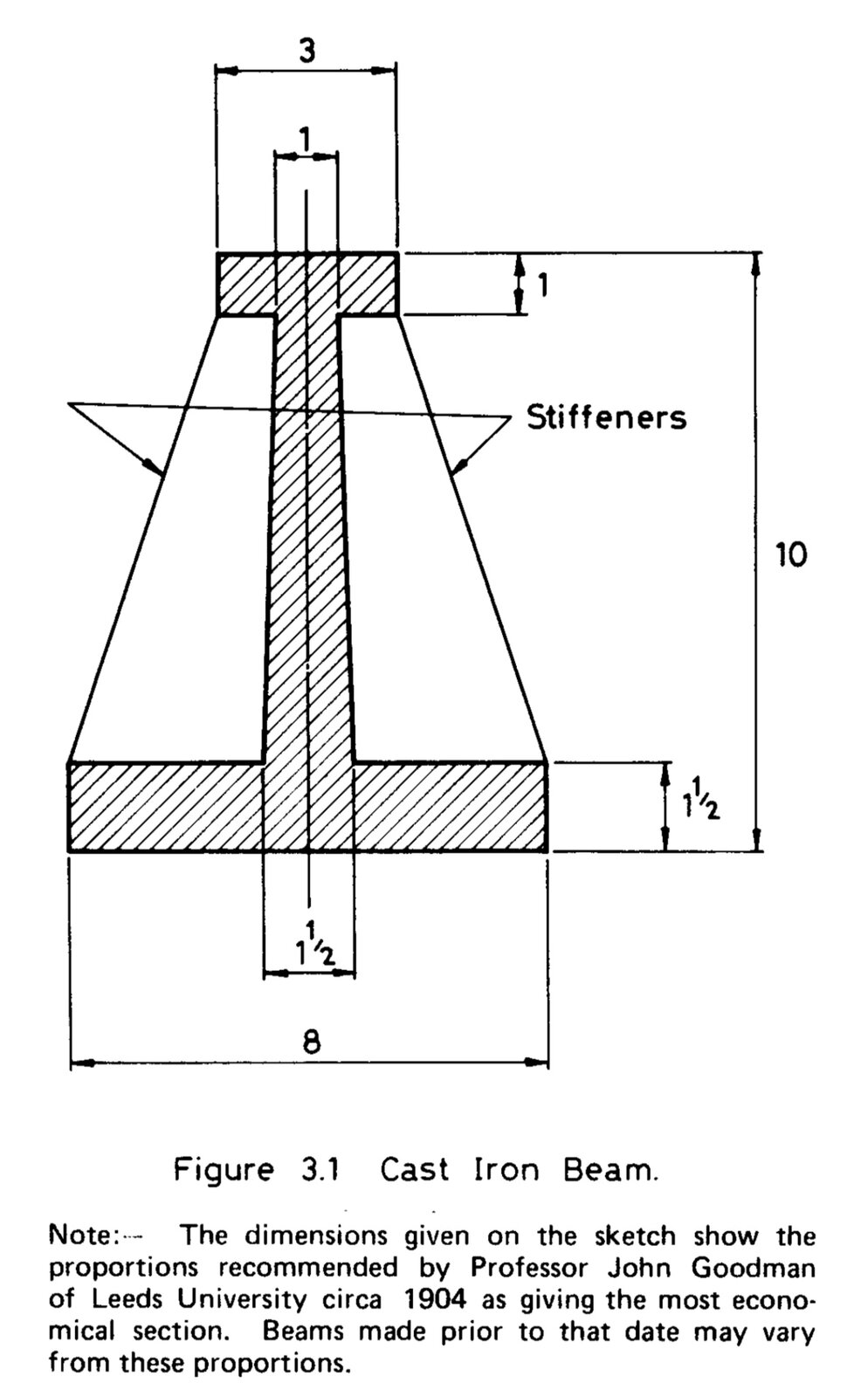

According the the Historical Steelwork Handbook linked above, cast iron is easily identified because it is virtually always asymmetrical; it is so much weaker in tension than compression that the top flange is always smaller than the bottom:
Mine is not quite symmetrical; the top may be 130mm wide v. the bottom 150mm wide; both flanges are the same thickness.
None of the tables have flanges as thick as this for a steel beam of this sort of size.
Maybe it is wrought iron?
