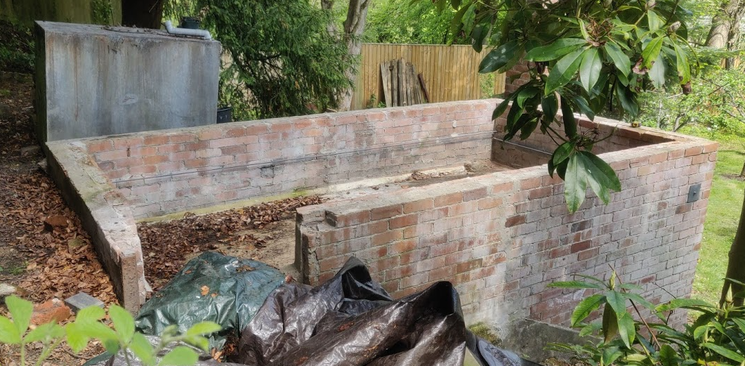

We have/had an old Victorian greenhouse - the wooden frame had to be demolished as it was rotten, leaving the brick base.
We've been looking at rebuilding the top, but I did wonder if I could simply have a 'conservatory' built to benefit from double-glazing and quicker fabrication. But looking online, I only see at most 3/4 designs relying on one external wall. Is that because it is required for structural reasons, or simply because that's what everyone wants? Is a 5x2.5m structure something that would be feasible?

Conservatory companies will make whatever you want, it's just that normally people want a conservatory fixed to the house.

Great. I wondered if the design relies on a structural wall for support is all - if not then as you say why would it make any difference :)

There's no practical reason why you can't specify 4 sides.
A conservatory is only a row windows and doors, ring beam and roof.
A 4 square structure is quite strong.
A upvc conservatory actually uses the glass panels a lot in practice to act as lateral restraint - and if the glazing is properly shimmed into the rebate, that should help minimise movement.

Although originally this was a hot-house with a coal boiler underneath ;) Not my aim to reinstate that.
That explains the design, i was wondering what was below the surface.
Pizza oven with greenhouse above? Grow tomatoes and chillies!
