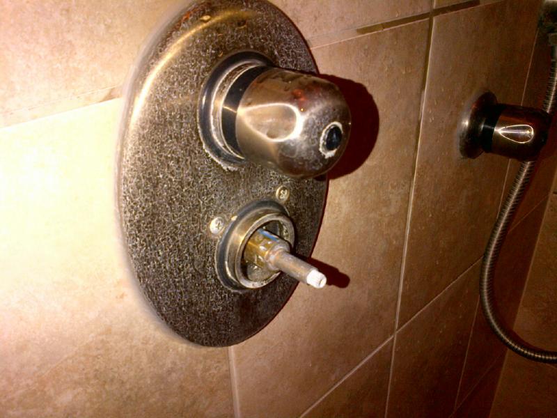

Can you help identify my shower?
BTW i think the brand is Gnutti Seastano (GS) or Gnutti Sebastiano & Figli Spa.
North American site is www.gsnorthamerica.com

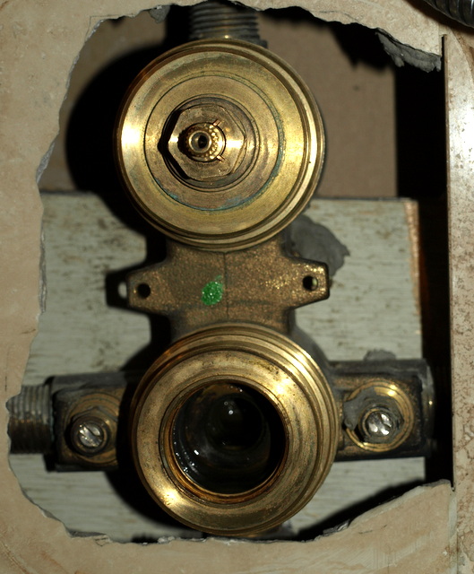

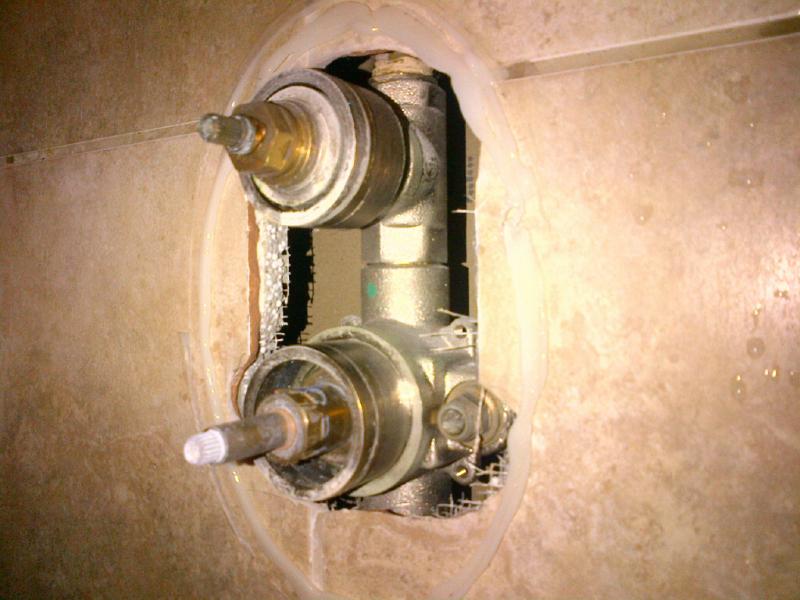

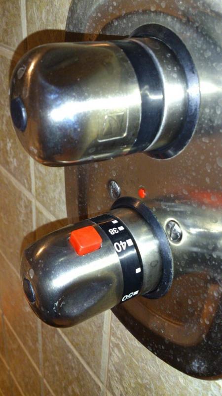

I need to find a cartridge i think the very end of the bottom valve (the thermo valve) is actually a bit wobbly. Not sure if that is normal, but also when i turn it, it doesn't seem right. its not a smooth turn.
Here are some pictures of it.

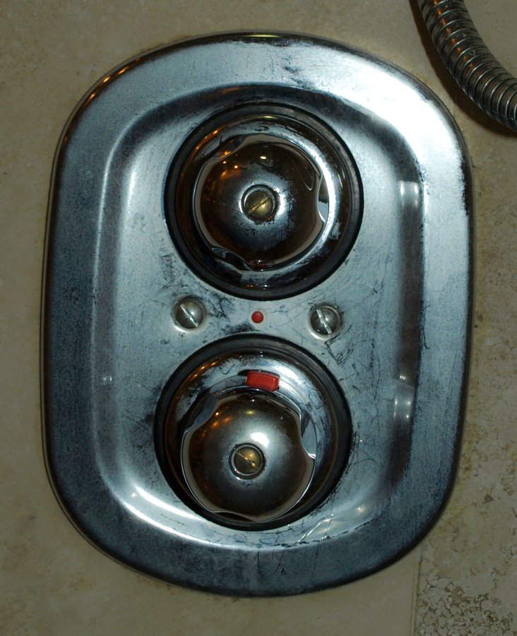

I notice my valve coming out has a longer stem then the one John has. Pretty sure its the same brand though.
Not sure why you think the 2 showers are the same.
The only similarity I can see is that they are both showers with 2 control knobs.

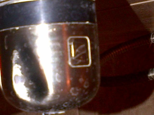

I don't show the knobs in the picture, but they are the same style and start with the same part number. GS000 ....
Also my knobs have the same logo on it as the one John shows in his original post.

Hi Erik
I have 2 issues with my shower.
1. The cartridge was broken so temp control didn't work.
2. I don't have non return valves so cold water was crossing over into the hot. I proved this by doing the test described in a post above.
So I ordered the cartridge above, however, despite looking identical when I screwed it in unfortunately the diameter was about 1mm smaller. I returned the cartridge and got a full refund.
Therefore, I have decided to replace the whole shower and get the non return valves added to hot and cold.

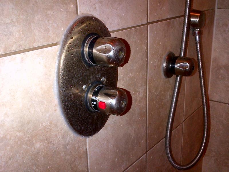

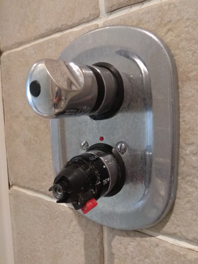

Thanks for your post. I have the exact same problem with, what looks like, the exact same shower valve. Mine is a slightly different colour and knob style, but the black temp. ring and the red button is identical to the failing unit i have.
It never had much response when turning the temp control. We have owned the home for 2 years (8 year old home) and we could slightly adjust the temp, but now the shower is always too cold and can get it only to lukewarm....not good :(. It really only got really bad in the last 2 weeks. But before it was never right. Sometimes we would have to crank it all the way up to 50C to have a decently warm shower. And we run our house hot water very hot. So it's not a boiler issue.
Err, is that not a knob in the picture? :wink:

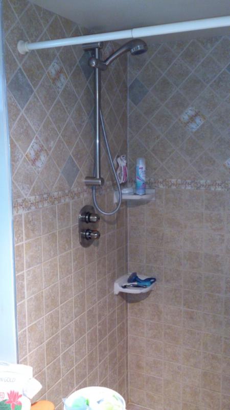

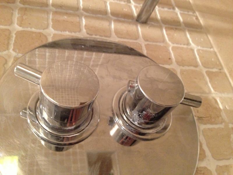

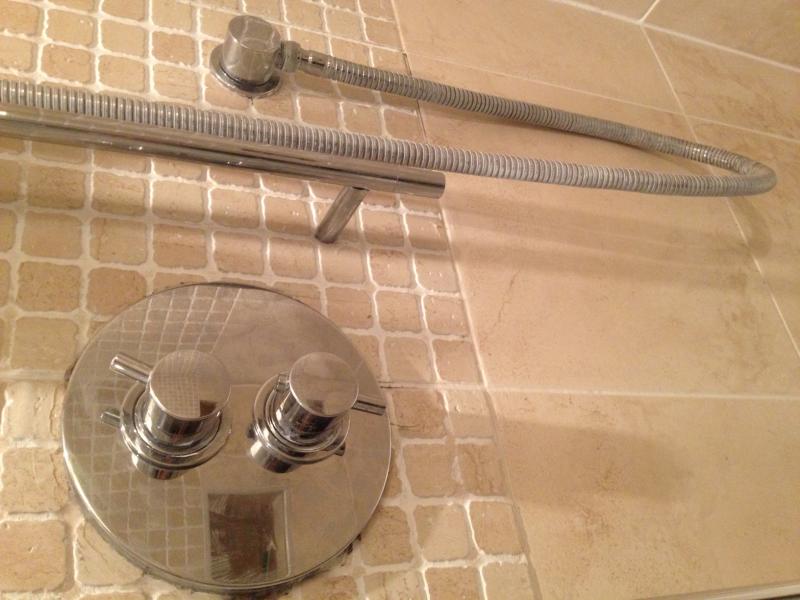

Hello - I'm hoping that I can use your collective knowledge too! I need a new thermostatic cartridge I've been told, but can't find a local plumber who can identify it. Any ideas? It's about 5 years old I should think. Top tap does power, bottom does temperature. Thanks for your help!

Hi all,
Problem solved for OntarioEric:

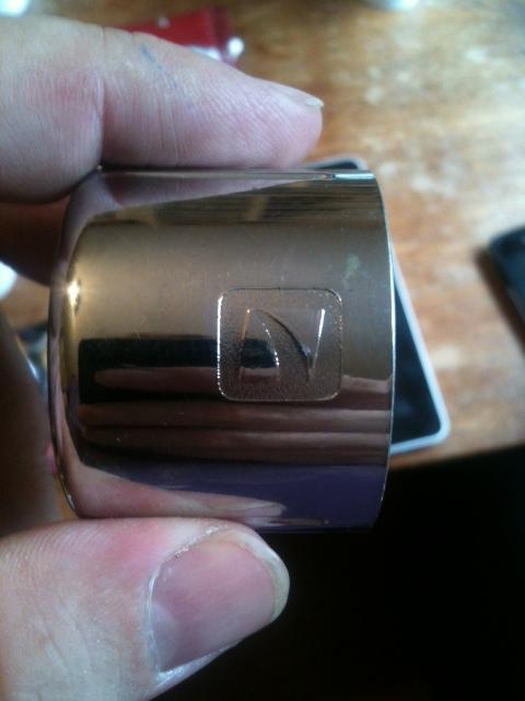

After a few weeks of research, the tap and mixer in OntarioEric's post is a product from an italian company. The company is called 'Sol', you can see the name and logo in the first link below. I'm about to search for a supplier in Toronto as I have the exact same problem.
If you go to this website you will see the logo and brand along the bottom of the page:
http://www.eurosanitari.com/?marchio=3&m_c=71
And here's a few more images of what I'm referring to in case anyone else stumbles upon this with the same problem.

I found a more accurate link for parts for my shower control units.
http://www.eurosanitari.com/prodotti.php?marchio=3&categoria=81&m_c=78
I have emailed them since it seems no one advertises them anywhere else. Hopefully manufacturer will locate a new valve for me.
My particlar unit uses a 1/2" valve, the "tall" or longer version.
BTW it looks like sol and crosswater use interchangeable valves.

Hi

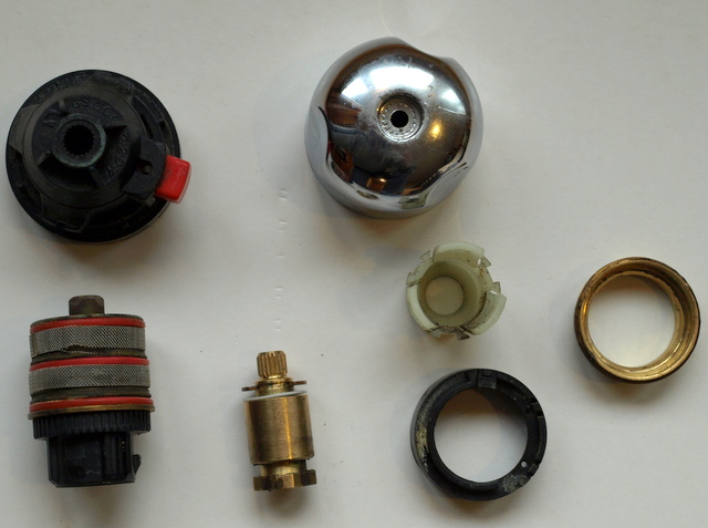

I have a very similar shower. After weeks of searching I received a replacement cartridge that looks very different but works perfectly:
Riobel 1 x 401-109 thermostatic cartridge.
