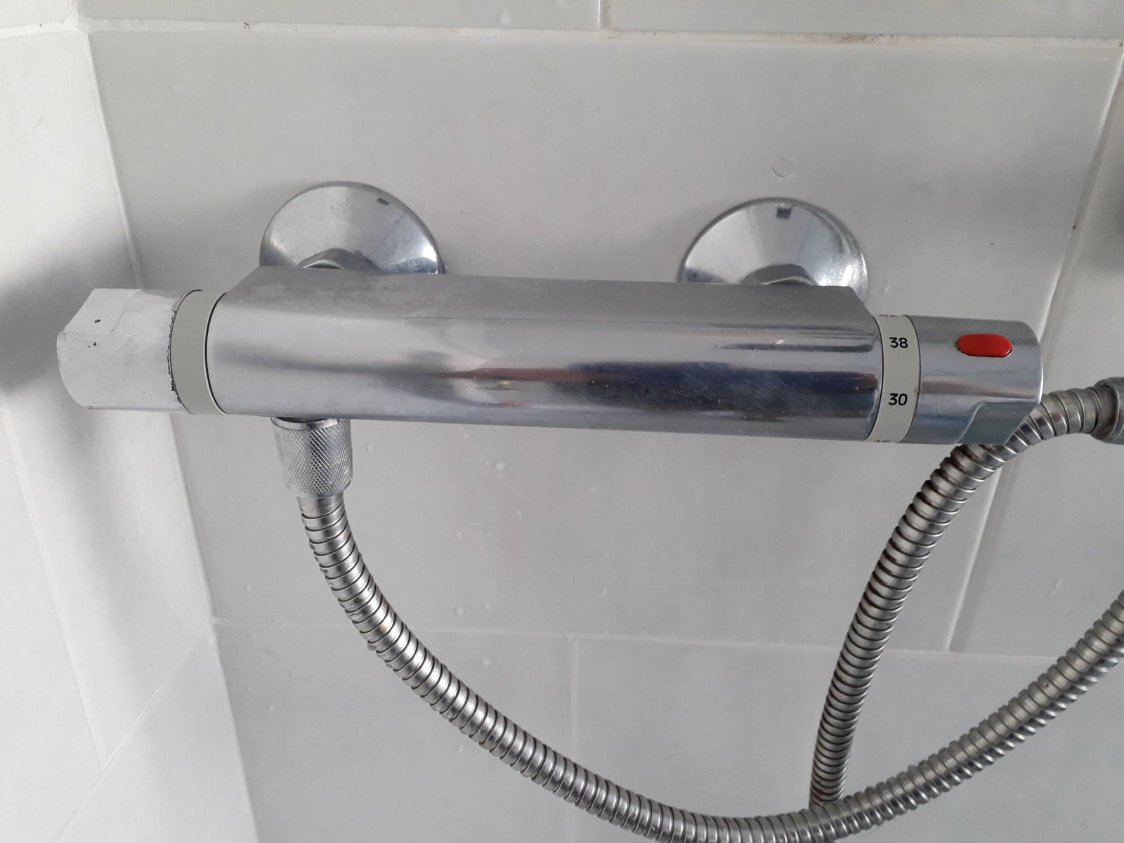

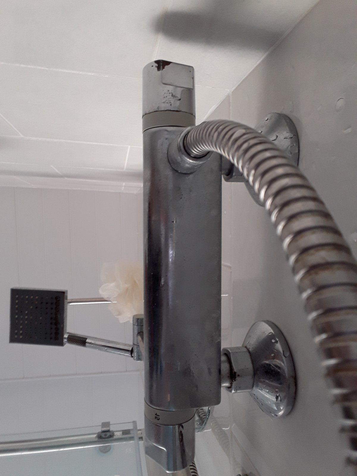

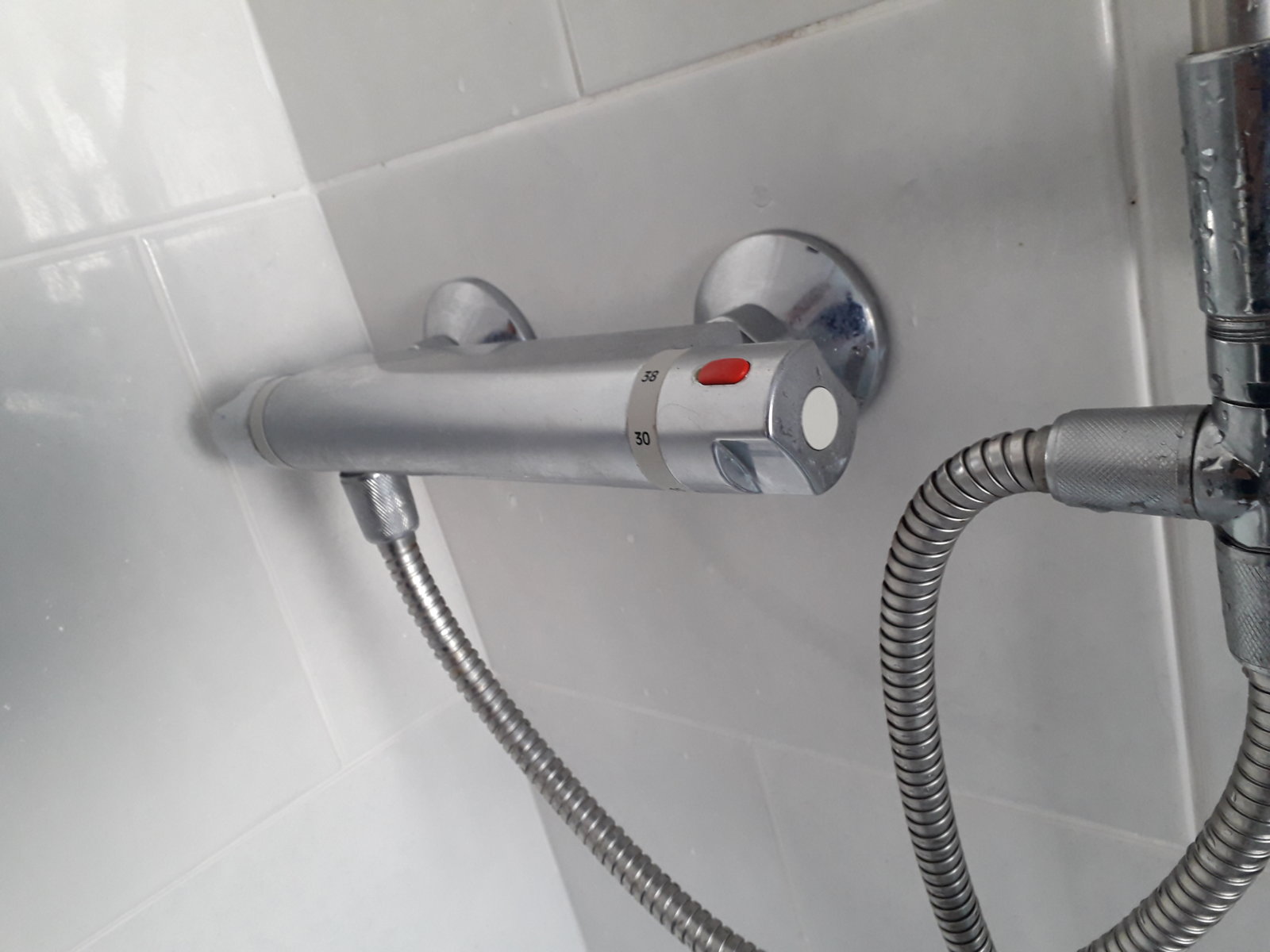

Hi group, I have a problem with a thermostatic mixer shower, left hand side of the block is getting hot where the HW feed comes in, but the water is barely warm coming out of the mixer. I had my water isolated via the mains stopcock on Thursday to feed on a new CW supply to a fridge freezer, turned everything back on and all was good. Fridge freezer came yesterday and I had to isolate again to complete the connection, when I turned everything back on I noticed the shower was running cold. Pressure in the boiler is fine and its firing up when it gets a demand for the hot water from the shower.
I've had a look at a few messages on here and think it might be the cartridge, however I cant identify the shower type because there's no markings on it.
Any advice would be really appreciated.
Regards Otto, Sunny Cumbria

Those bar mixers are cheap as chips, I'd just consider replacing it. Might not be much in it, price wise, against a cartridge, if you can find the correct one.

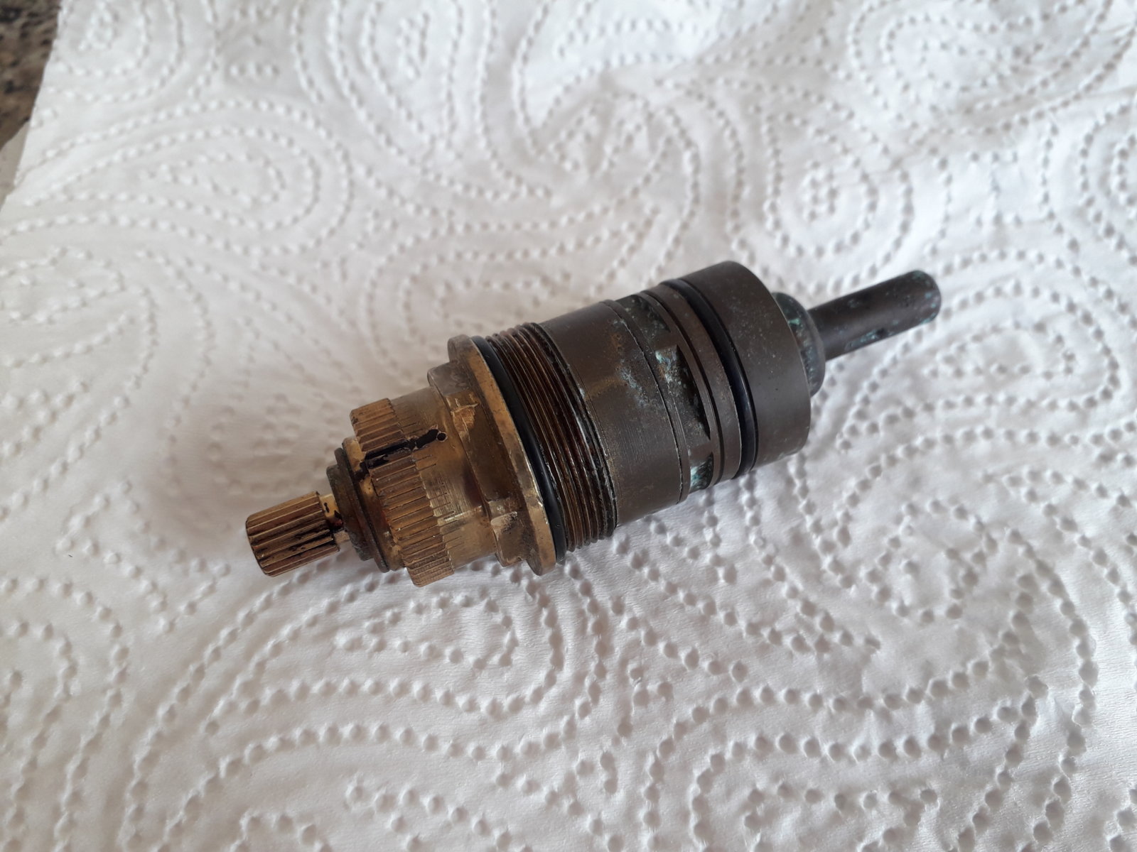

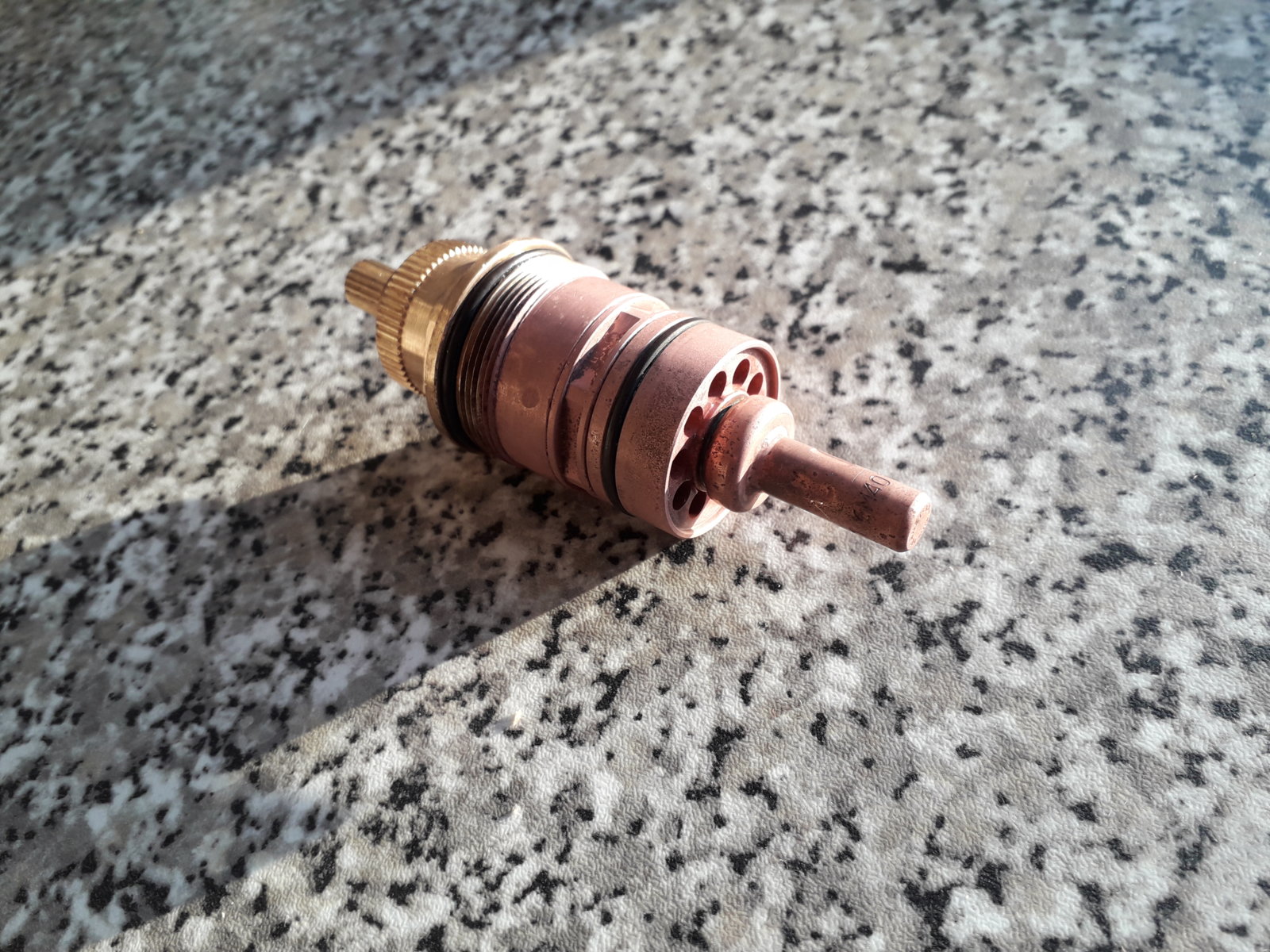

Is there any way to test the cartridge other than substitution?

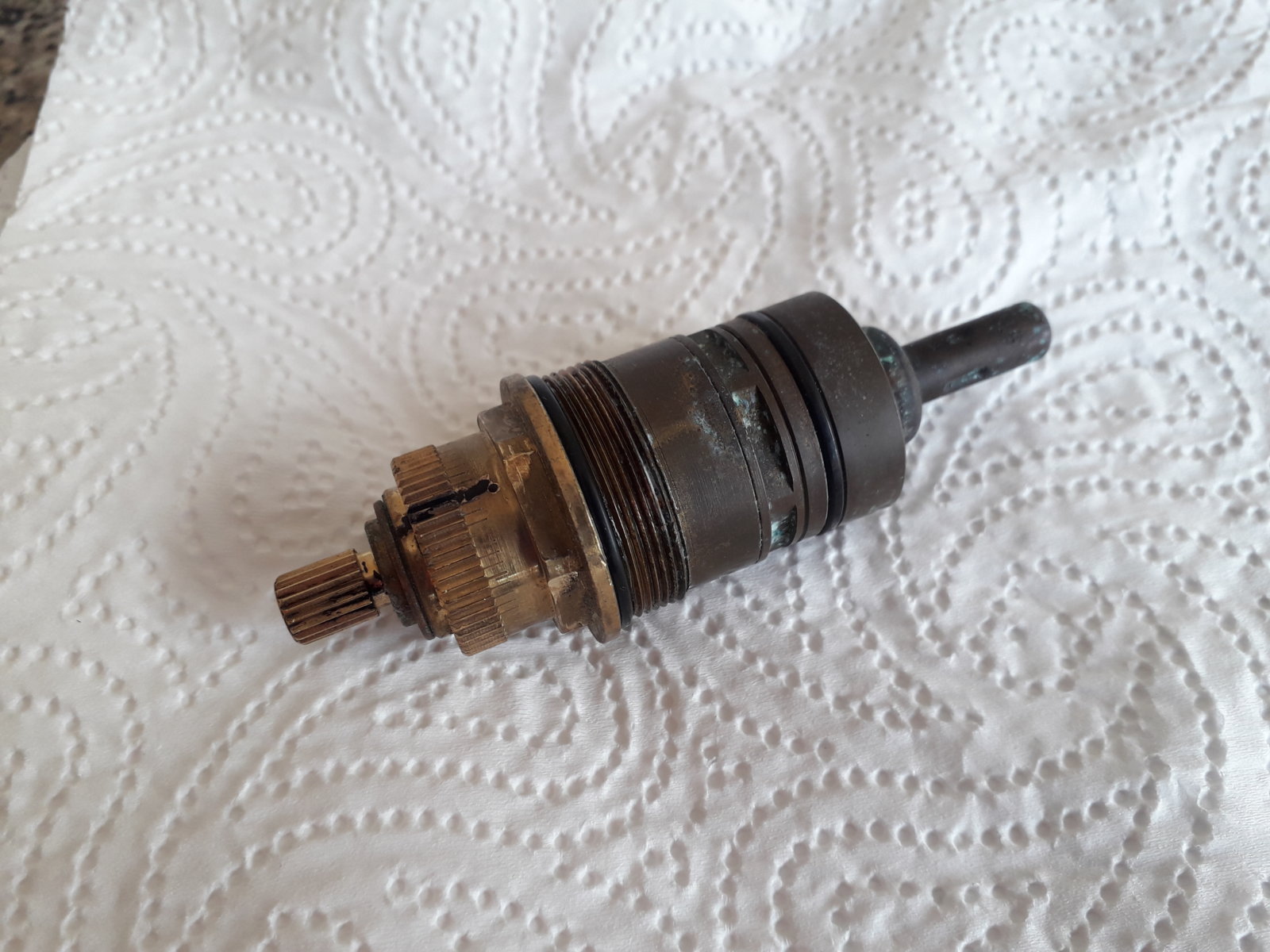

No, its a mark on the valve body which I assume is where the stop is aligned, anyways its working fine now, soaked it in white vinegar, dried it off then sprayed with silicon spray, refitted and after a couple of turns it was back to normal (don't know how long it will last) but thanks to everyone for the replies, much appreciated, Otto..
