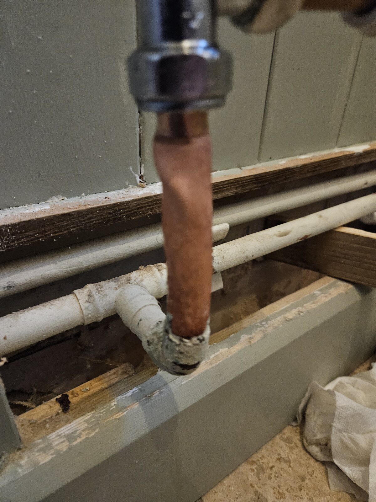

Thanks for all replies. Job turned into a disaster...decided to change valve in entirety, olive puller got stuck with olive on very end of pipe...which then twisted as I applied too much torque.
However, i did discover after the event that you can get a replacement caleffi spindle seal (The top plastic nut which holds the valve spring in place).
Available from Altecnic in Stafford. Having removed and dismantledv the valve, it is clear that these can be replaced without freezing or draing the system...the amount of water released is no greated than the leak around the spindle. MASSIVE time safer!
Ps..you cannot vacuum seal a 1500l heat store. Tried, but it became clear the tank was likely to implode! So managed to freeze the pipe just long enough to cock the job up!
