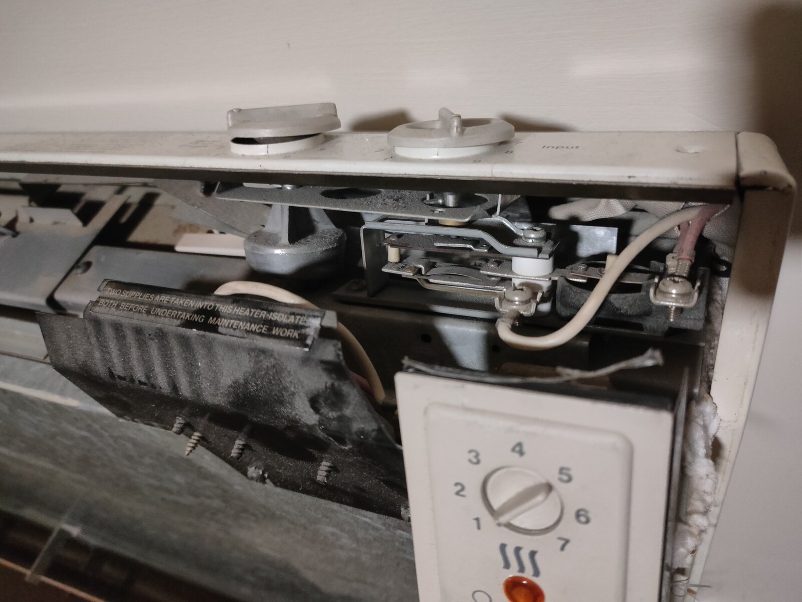

Hi,
I can't find thermal cutout reset button for Dimplex CXL24N heater or the button does not work. Maybe someone can point me to the button location on the pictures I attached?

Its the white thing sticking up
Right hand side Between the Red wire screw terminal and the White wire screw terminal
img20211103195134-jpg.249487
Thanks! I tried pushing down that white stick but it does not make a clicking sound. I assume that it is not a problem in my case (or it is broken).
