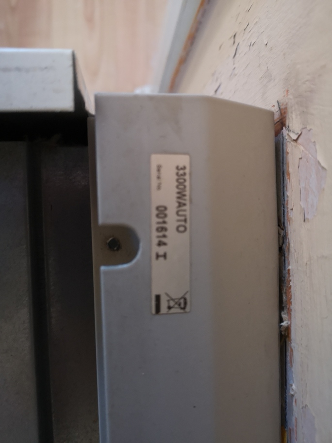

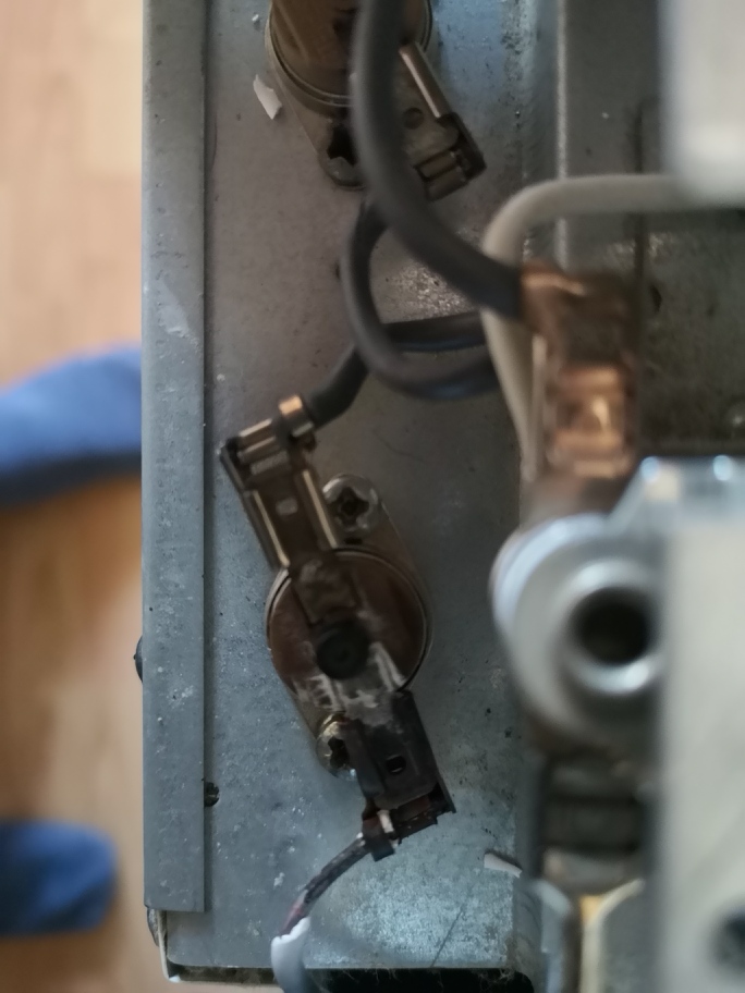

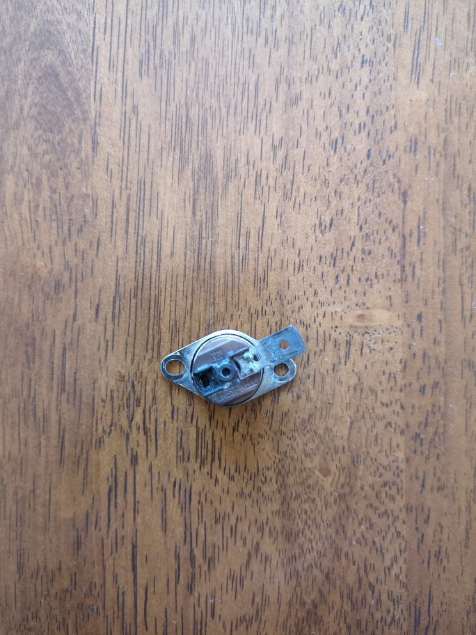

Got up this morning and my storage heater was cold.

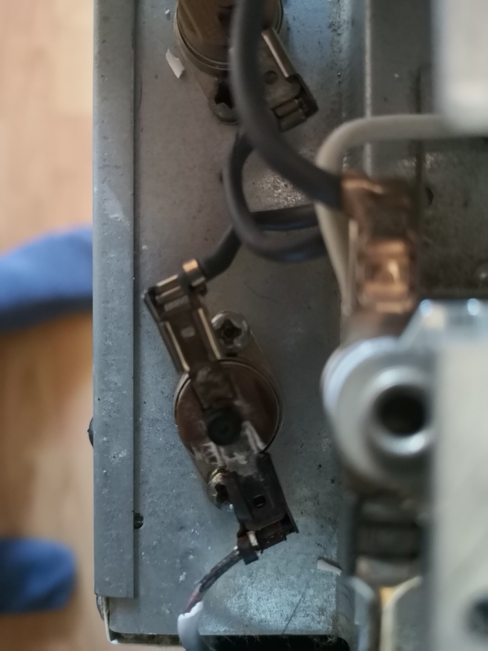

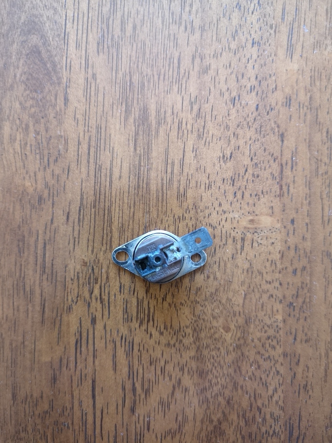

After opening the panel, it looks like one of the thermal cut outs has failed. The storage heater is rebranded from Denman’s electrical, so I don’t know the real make, although I think in may be Dimplex.
The heater is 3300w auto. It doesn’t look like the part is available now as heater is around 7 years old.

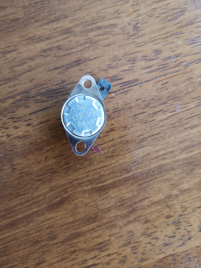

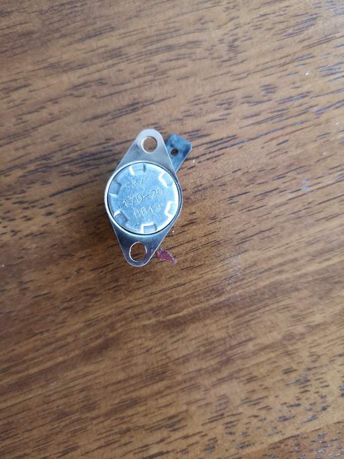

So, my question is will a generic thermal cut-out work and if so which temperature do I need for a 3.3kw heater? I have attached some picture of the faulty switch.
Here are the switches, However, the one in heater has a reset button on top.
https://www.ebay.co.uk/itm/Thermal-Cutout-Switch-N-C-30-40-50-60-90-100-110-/173751536649

Okay tried the reset and it worked. However, it's not as hot as usual. Looks like the thermal cutout is on its last legs. Seems worn and burnt
Could one of the elements have gone? That might have tripped the thermal cut out too.
