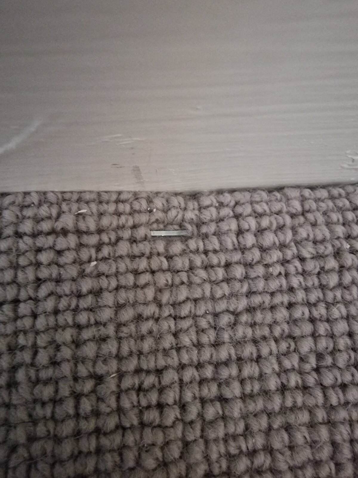

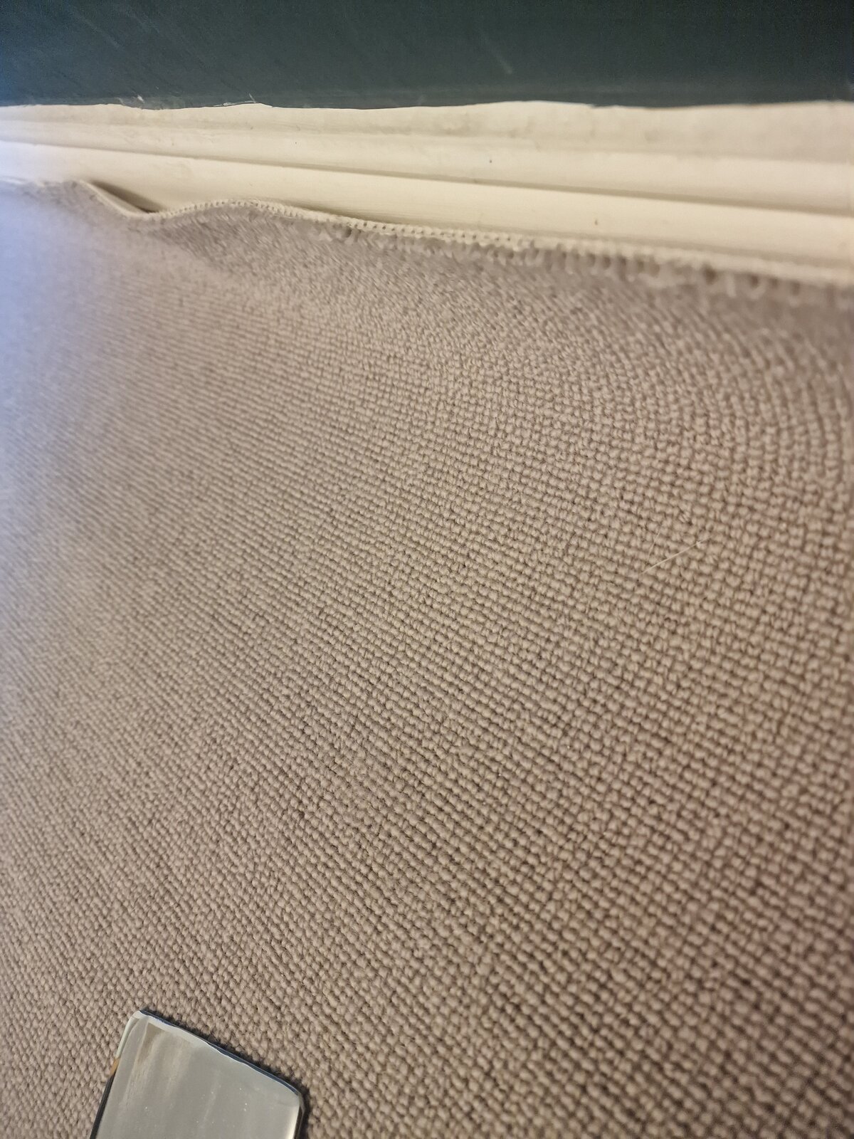

I'm trying to fit a new carpet and struggling.
I'm using 12mm plushwalk underlay so have fitted the grippers with a slight shim to bring them flush with the underlay. The carpet is a heavy duty wool loop, and the backing is very stiff. Other carpets I've fitted and all the videos I've seen are lovely and flexible. This is very difficult to fold and crease into the edges.
When I try to stretch the carpet over the grippers and crease the edge with the tucker it just pops back up. I've even tried pre-cutting one corner to the finished size before stretching, but it still won't hold.
I've heard you can get long pin grippers but this carpet isn't deep.
Any suggestions?

You need to cut the carpet tight to the bottom of the skirting and then stretch it before trying to tuck it in to the gripper.

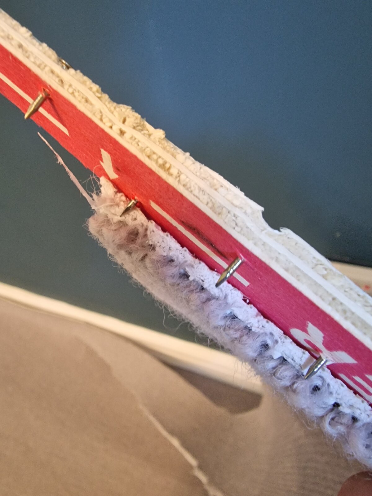

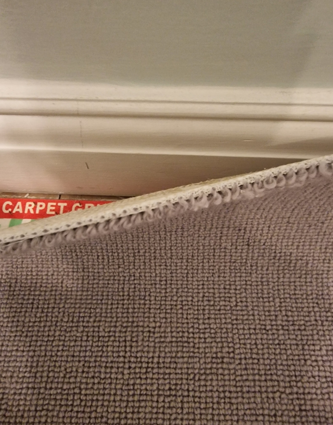

In post #3 it looks like you are offering the carpet up to the nails on underside of the gripper. Are you sure you have the gripper fitted the correct way round?
The gripper also looks a little close to the skirting to me?
And stating the obvious, this type of carpet needs a lot of downward force on the stretcher, as well as the knee kick - are you pushing your weight down into it?

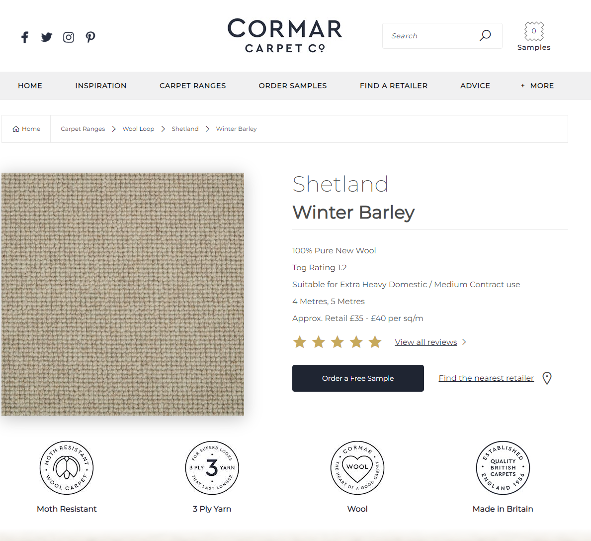

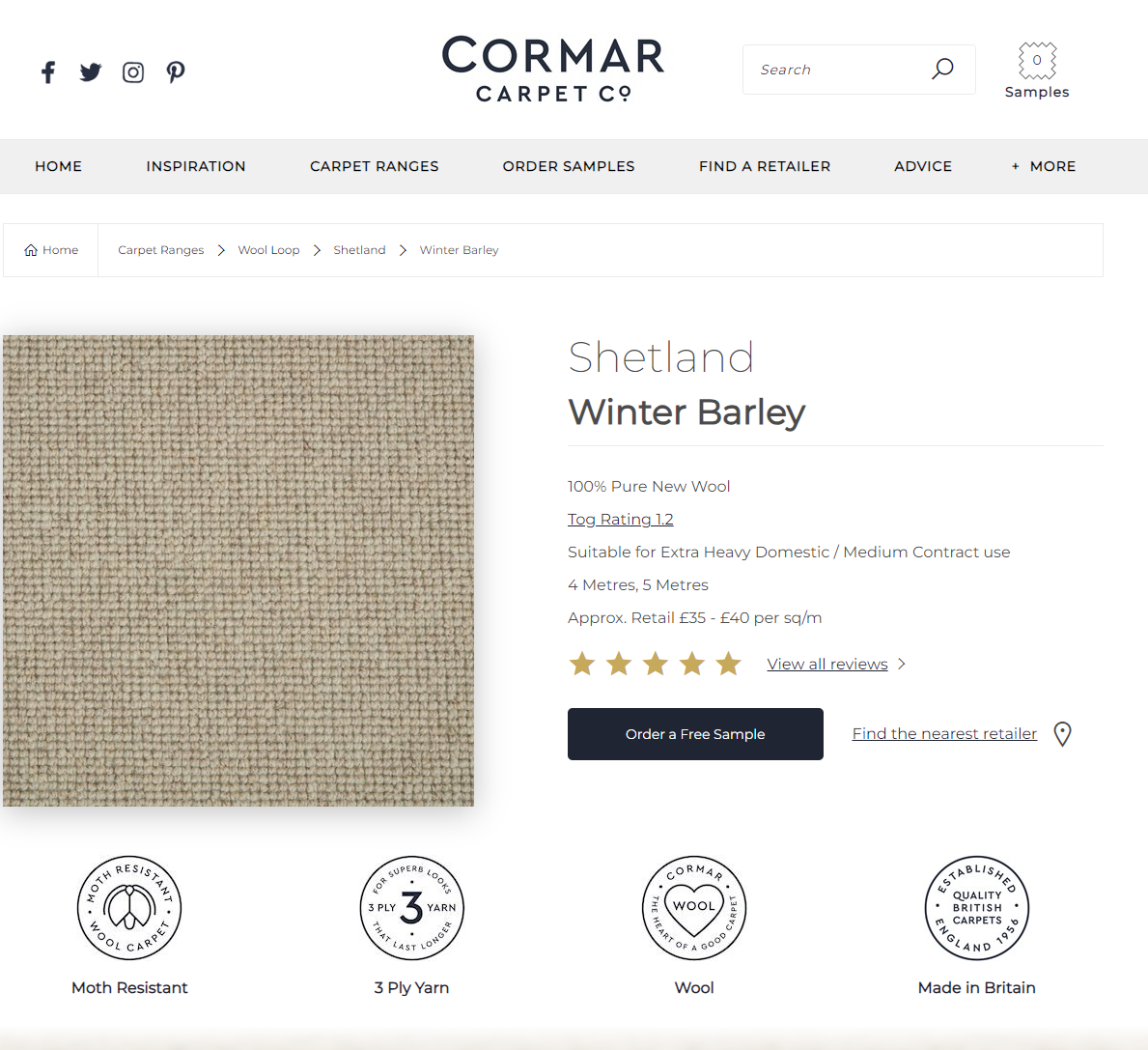

so does heavy duty carpet. This is a Cormar 100% wool loop. Apparently good quality

I think that it possibly the issue. I was concentrating on the knee part and not so much the pressure. Likely my technique wasn't great
I found a local carpet fitter that fitted it for £30. He said it's a really tough carpet to fit diy - very heavy duty so needs a lot of force to stretch. And the kicker I had was cr@p - it didn't grip deep into the carpet and was too short so had a tendancy to pull up.
He used a power stretcher that braced against the opposite wall and used a lever.
