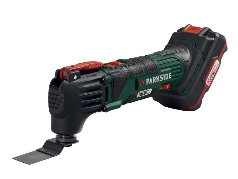

Morning everybody – latest project is to replace a cracked pan in my shower, so I have to remove the bottom course of tiles. Actually, I’ll probably remove all of them and re-tile anyway… but I can’t get the grout out! I do want to save the tiles if possible, in case I don’t re-tile the whole thing.
I bought a rake from Screwfix, and I’m quite strong, but honestly, it hardly scratches it. Am I doing something monumentally stupid? It came with two kinds of blade simultaneously attached, so I removed the sort of file-like one, leaving the little saw blade in place, and have been scraping back and forward forever – on one tile – and it’s hardly scratching it.
I may get an electric one, but everybody reckons these work fine, so it must be me :(
It depends on the grout that has been used. If it's the good stuff, very rare unless you have done it yourself, then that can be extremely difficult to remove with those silly kid's tools. I used a multitool to remove the grout but you have to be careful because that can burn the tile edges.

Thanks Pete – no, the previous inhabitants of this place were animals – I’ve spent 8 months undoing their electrics, plumbing, flooring… I could go on. A lot. So the grout does seem to be very hard.
When you say a “multitool”, do you mean a Dremel or something, or one of these?

I bought this from LIDL a while back, wasn't expecting miracles but it's taken a everything I can throw at it anx still going!.
Well, LIDL don’t seem to do the multi tool any more, and Screwfix are out of stock everywhere. So I sat down with a miniature screwdriver and hammer and, chipping out about a millimetre at a time, eventually got all the tiles out. Took hours; only broke two, which I reckon Araldite Rapid will fix.
