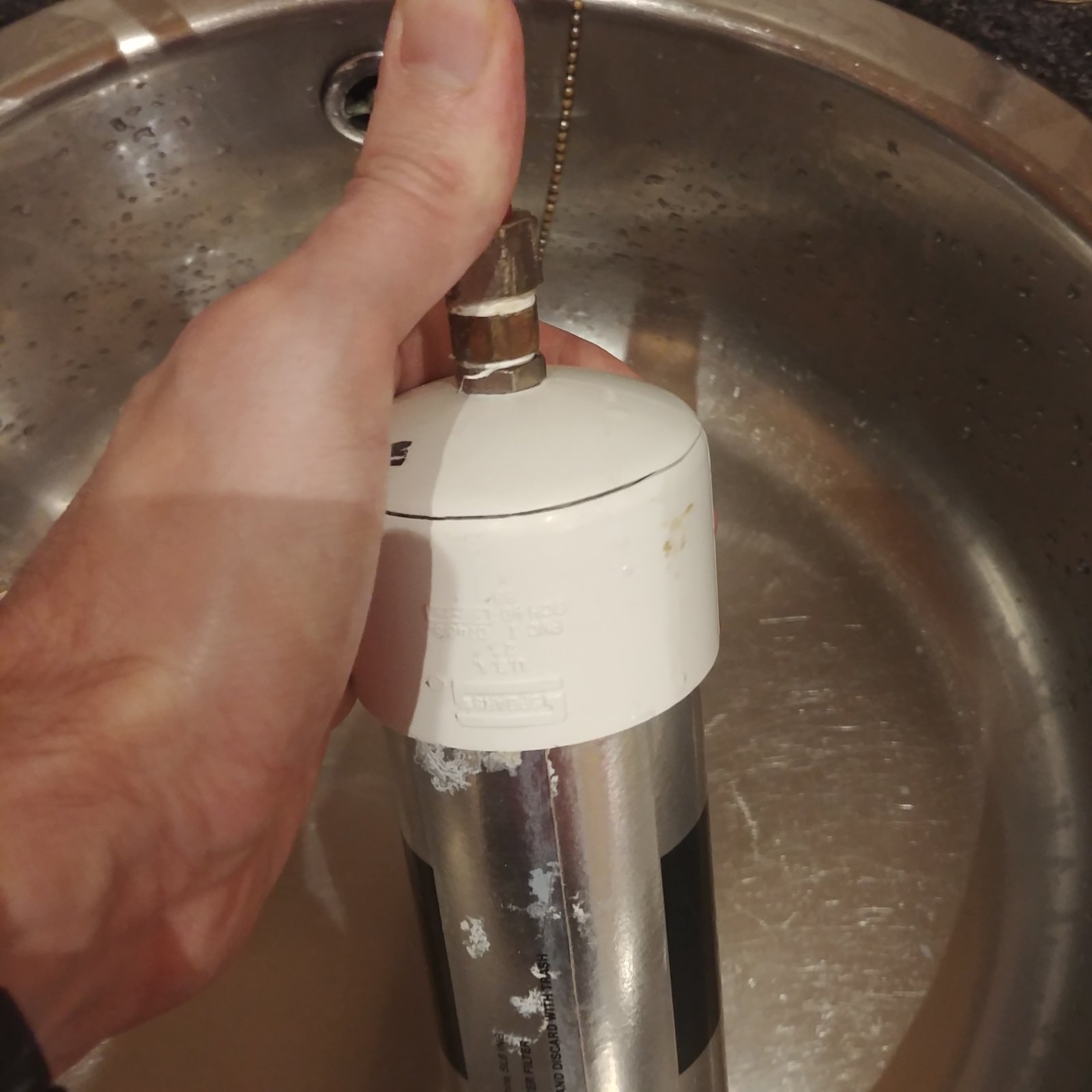

That is a very good idea actually, we had a flood shortly after moving in as a water filter burst open, also had a tap pop off, and the replacement tap, only a year old is already starting to leak.

Do wonder what the static pressure reaches during the night!
Enough to do this!
