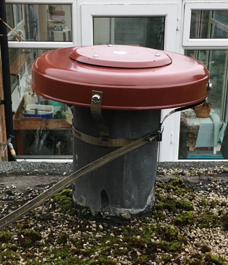

So removed the flue and added a cap. It's obviously designed for a chimney but couldn't see other sizes.
I've trimmed the excess tie off. Hopefully it stays put.

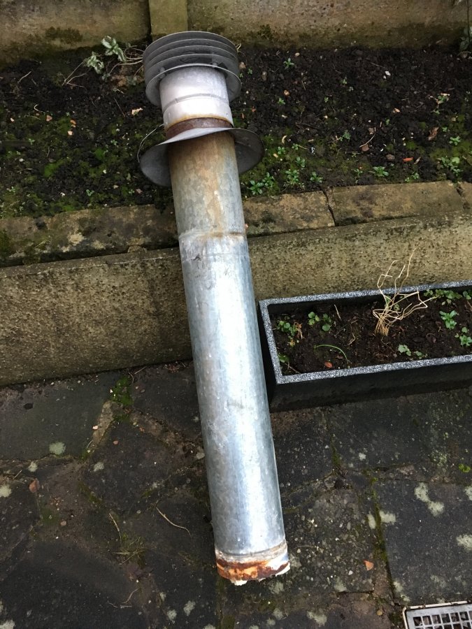

This is the flue.
Why did you waste ££'s on a UFO?
As a temp job, you could have just removed the length, cut back, stuffed the flue with rags, put back in position. IMO

TBH it's what I thought about doing but a cap was suggested. Agree it looks way too big (and silly). Still have the old flue so happy to it down to size.

I think I would. It has only just occured to me that the UFO is designed to INCREASE flow through the flue, so you are probably worse off than where you started.
As well as looking weird.
From what I read, it's supposed to stop condensation issues. I didn't want rainwater entering the flue into the cupbord below.
The flue is frustrating. Don't know why the previous owners didn't remove it completely when they relocated the boiler.
Will try cutting the flue down to size and see what happens.
