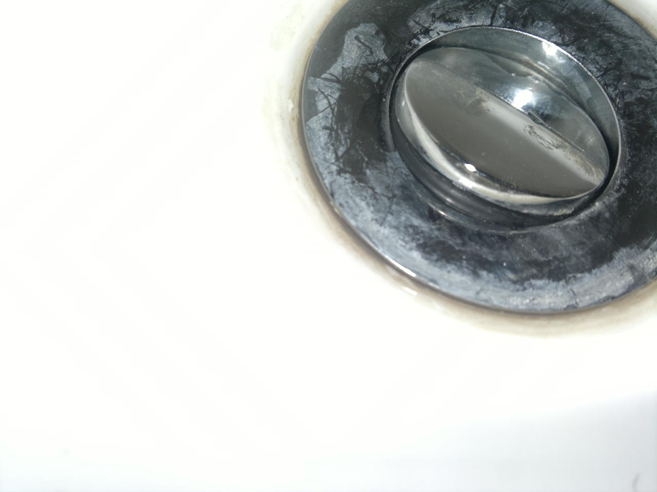

Recently started fitting these instead of 'click clack' type of pop up wastes.
Worked a treat out the box, but after a few months use - the rubber has swollen to the point where the plug will not flip round to seal.
Is there a way to shrink the rubber back ? I am sure nothing apart from soaps have been used in the sink. Some one has suggested boiling water, but surely that would only be temporary.

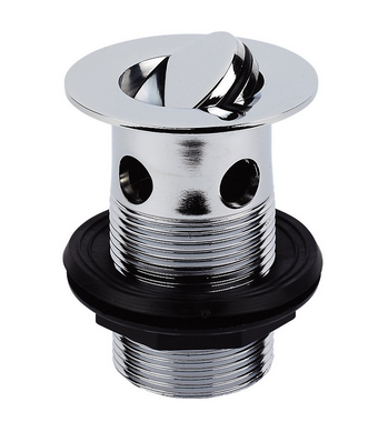

Can anyone shed light on what type of rubber will be used in this plug seal, and can the rubber be replaced.
It'll be a simple silicone rubber seal/o-ring I would think. Getting one the same size/diameter will be the hard part I would think. Is it a hard water area?
Have you tried a little silicone grease?
Something other than soap has caused the rubber to swell, if it wasn`t a cleaner then perhaps mouthwash? I doubt if you can replace the rubber seal and may have to replace the whole thing.
A boiled kettle of water allowed it to close, but its been left for a few hours and although it closes - its really stiff.
Will try some Silicone grease !
I reckon some measuring calipers and Ebay might locate at least something near if I can get the 'rotating' plug bit out.
Have applied a little Silicone Grease from our vans grease gun, closes a treat - not sure how long it will stay coated/in contact to lubricate.
